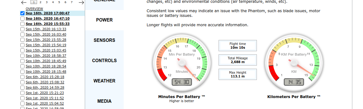

But the iPad kept calling out “80 per cent battery.” Which was odd. Looking at the data the 80 per cent point was reached at 3 minutes and 27 seconds. Which was still odd.
After actually registering that the battery was apparently not using any power it seemed a good idea to bring the aircraft back and land. Which I did with the iPad still telling me the battery level was 80 percent. The battery lights were at 2 out of four - 50 per cent-ish.

I’m used to the battery behaviour on the Mavic and this is the first time I’ve experienced a reporting problem in 12 months / 160 flights ownership. The error occurred within the aircraft as both Litchi which I was using as the flight software and Airdata which shows the data uploaded from the aircraft gave a landing battery of 80%. Airdata showed that the 80% level had been reached a 03:27 and was reported as 80% for the rest of the ten-minute flight.
