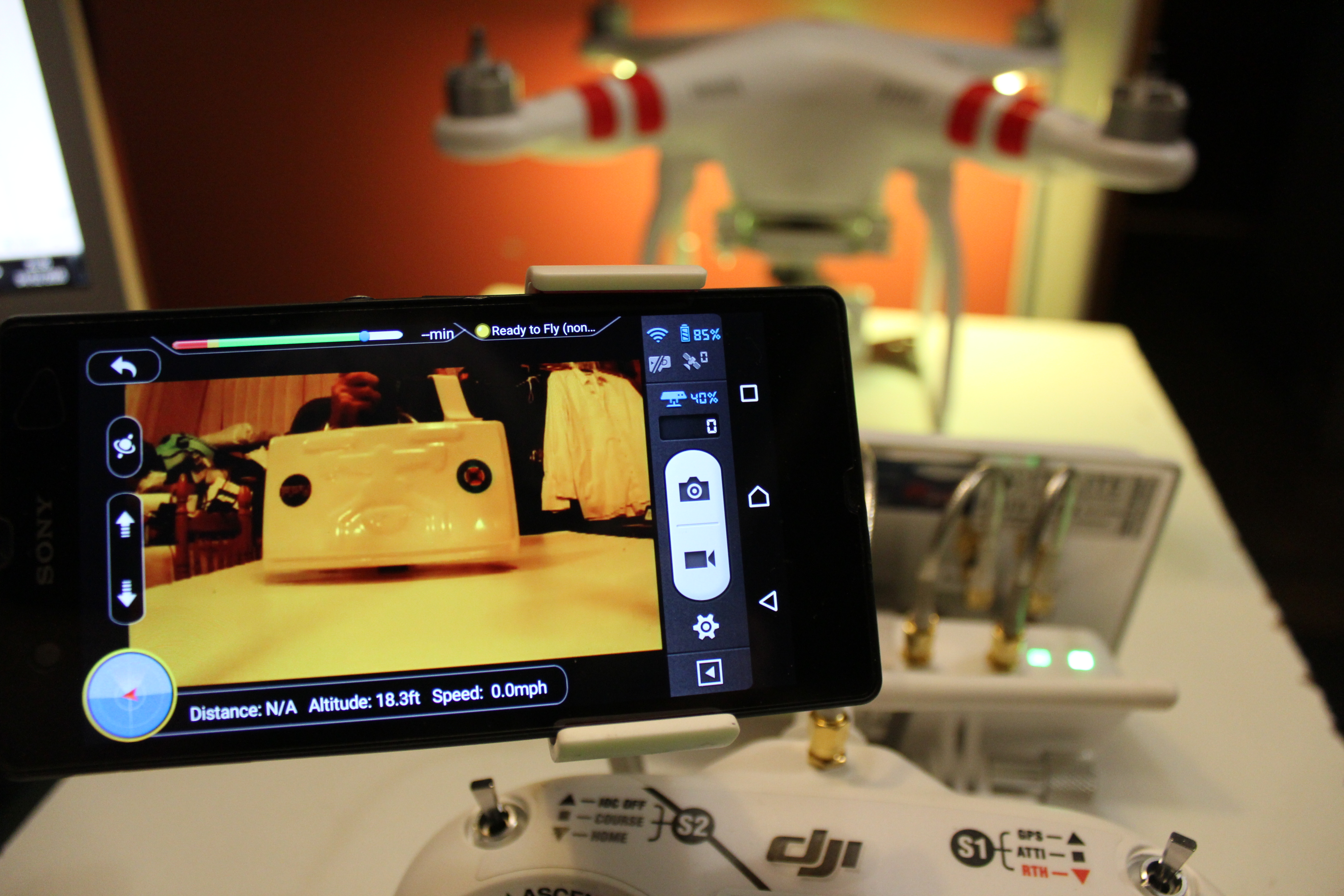

I modified my Phantom 2 Vision + Hand Controller with a Long Range Flat panel Antenna and stick antennas on the WiFi Module.
And removed the pathetic antennas from the drone and replaced them also with 10db ones.
It improved my range immensely, until the wankers at DJI Fucked up the drones with a Firmware Update ,which fecked just about everyones setup.
Luckily with my Electronics experience I managed to redeem the drone by re-flashing the firmware (and done many for other P2V+ owners in my area).
They never admitted to the feck up (apart from the USA) and the Web was full of complaints about it.
My Phantom 2 Vision + Antenna setup on the Controller.
Still works fine to this day !.
