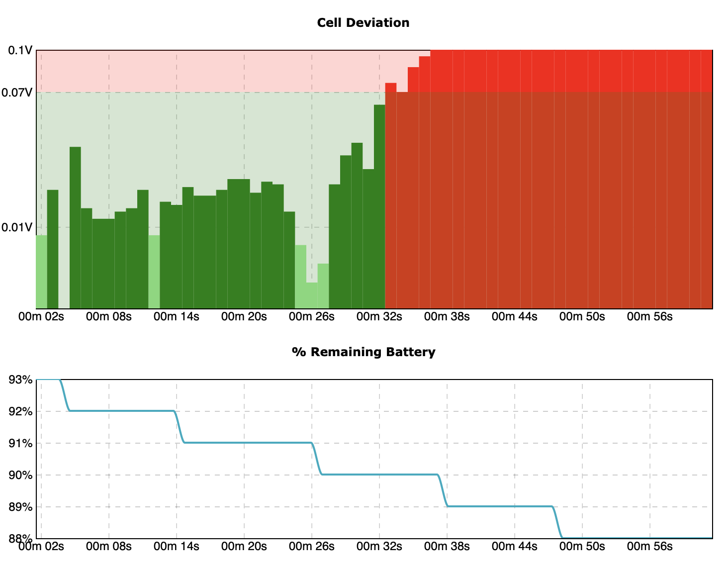

Motored across on the RIB I wass using as a base for the event (and have done many times before), did safety checks and took off, hovered for 20 seconds checked controls were all good. Then flew across to where the dinghies were starting to sail out from the beach, battery was at 95% ish on take off, (not the newest battery I own).
Started to film the sailing after approx 50 seconds the battery goes from 86% to 0% with a critical battery error warning! and the mavic gently turns from a nice flying machine to a useless submarine.
I was 100 metres away and the height was about 25 feet so no time to get under it or fly back. so just swore and waved bye bye.

Do you have a link to the flight on AirData?
here is link to airdata

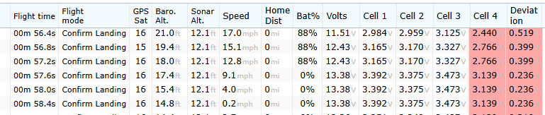

Dramatic! Cell 4 went rogue.
88% to 0% (overall) in under half a second.

If you look back at the airdata for that particular battery, any warning signs of cell issues on the past?
i know!!
As said the message
ā€œCRITICAL BATTERY ERRORā€ flashed up in red and the drone started descending.
I knew that was that
no particular signs but haven’t spent long looking.

Fortunately a rare occurrence but when a LiPO separator within a cell goes high IR, that cell dies QED the battery dies. In our large RC planes, we have Optiguard units to manage the RX and Servos if the main battery fails and kills the BEC - hope the insurance kicks in okšŸ‘
