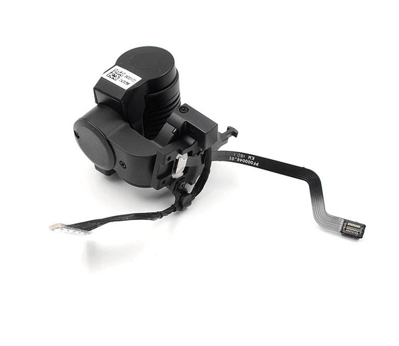

In the Mavic Air’s gimbal are two cables
In this picture, the ribbon cable is on the right, and the video cable is lower-left.

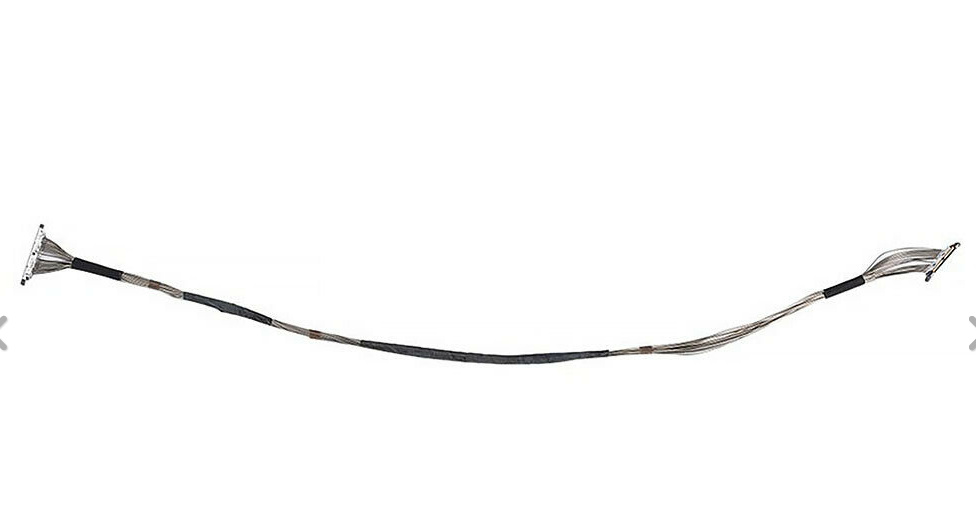

A photo of the whole video cable …

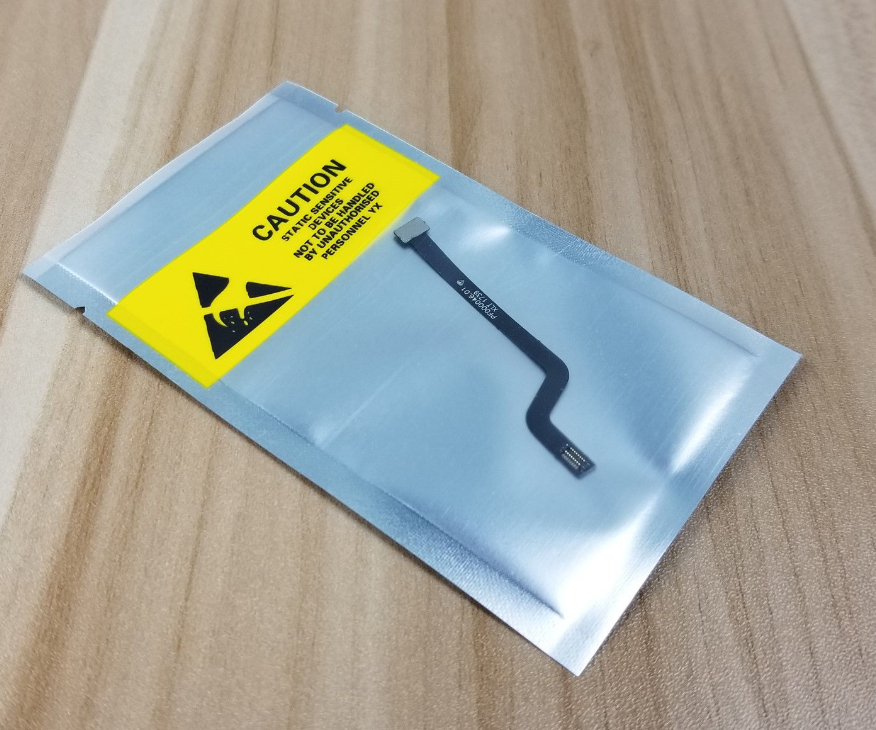

And the ribbon cable …
Hopefully this will help when @John75 confirms which cable he replaced … but, reading through the posts, I think it was the video cable.
