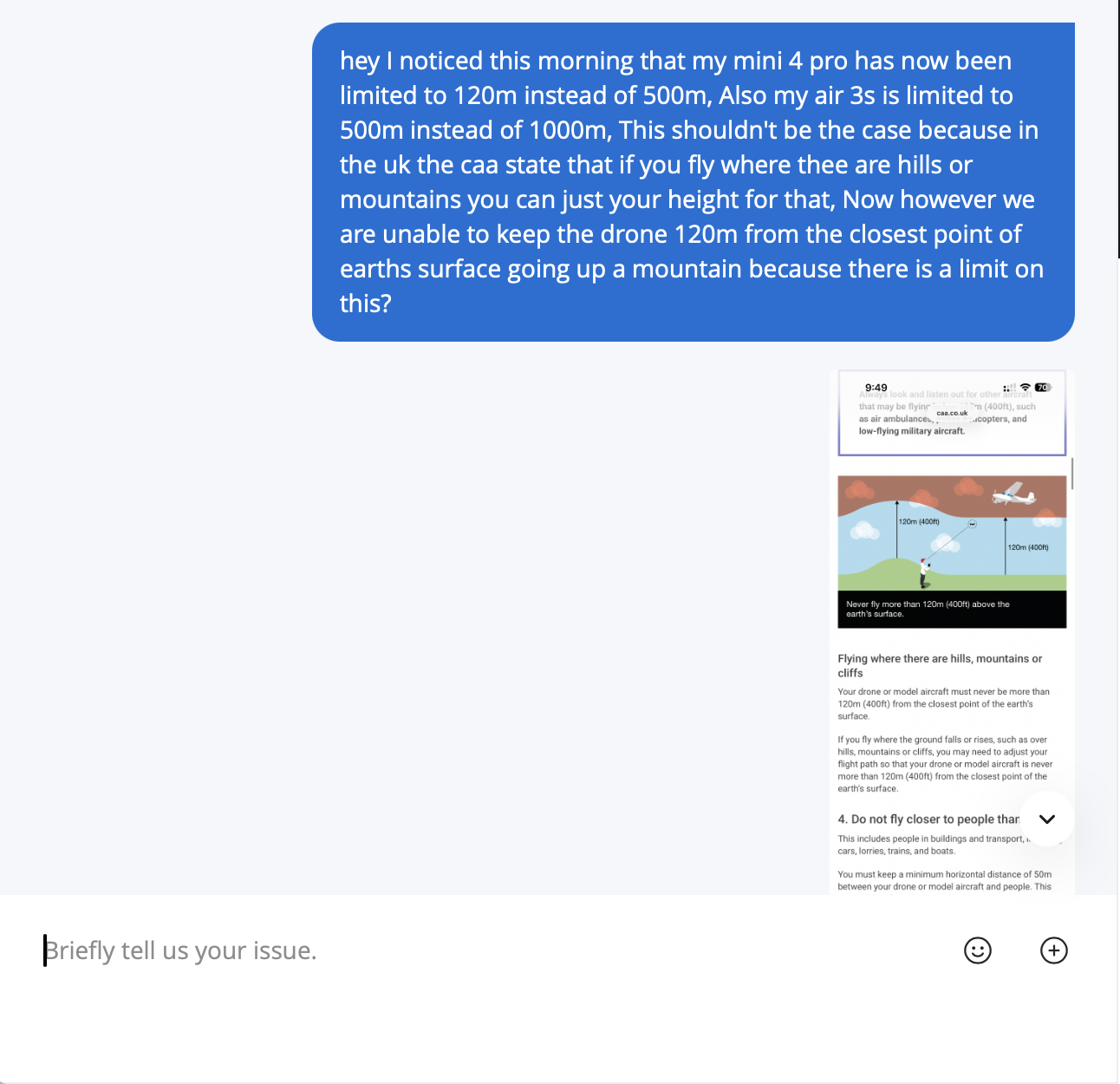

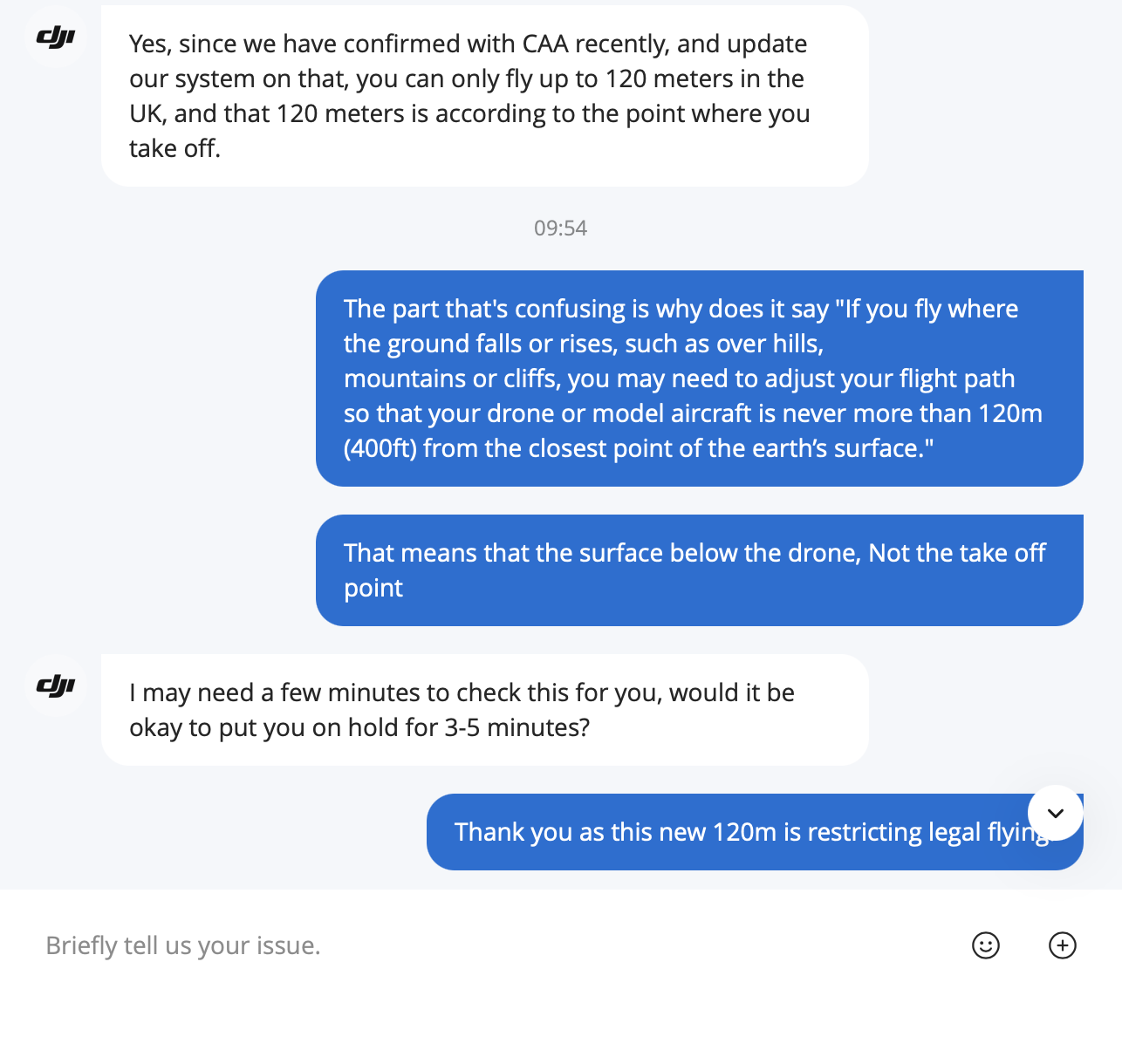

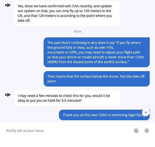

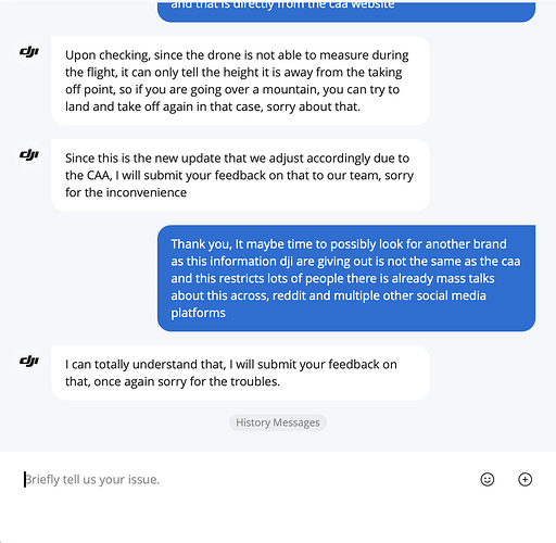

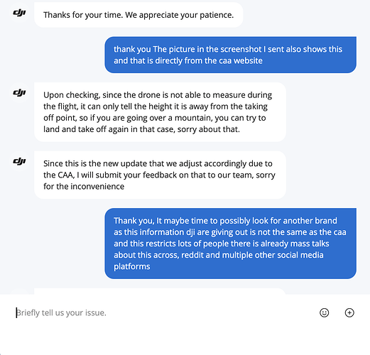

So I found this morning that the mini 4 pro its now hard limited to 120m and the air 3s to 500m :enraged_face:

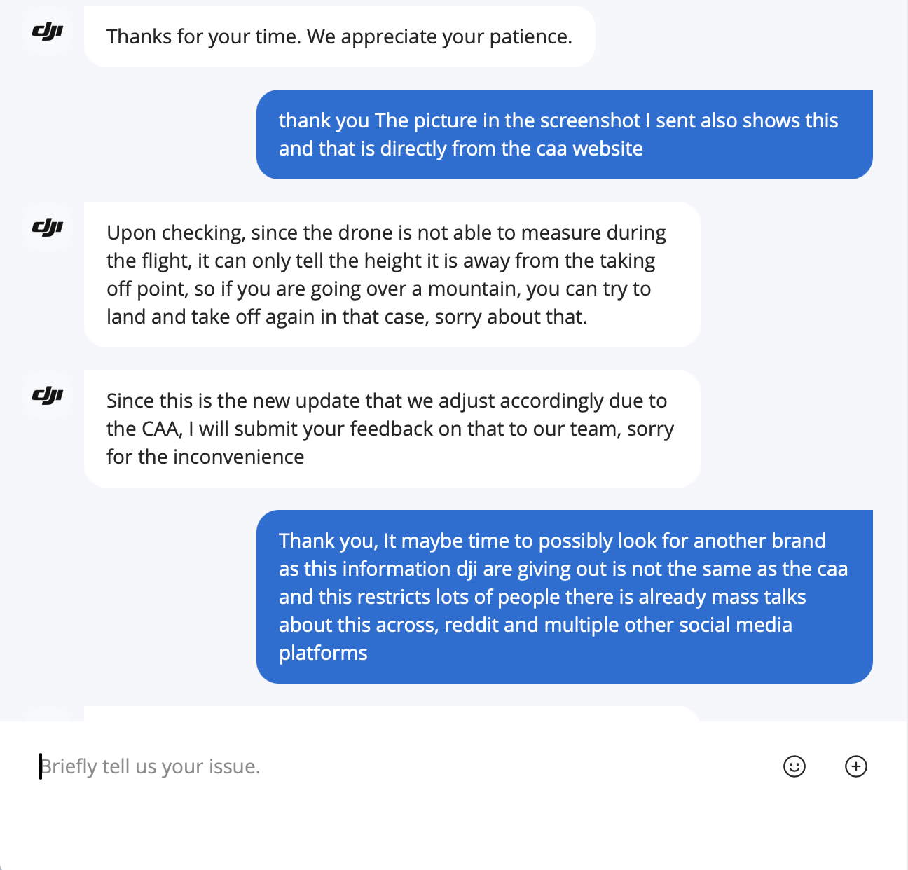

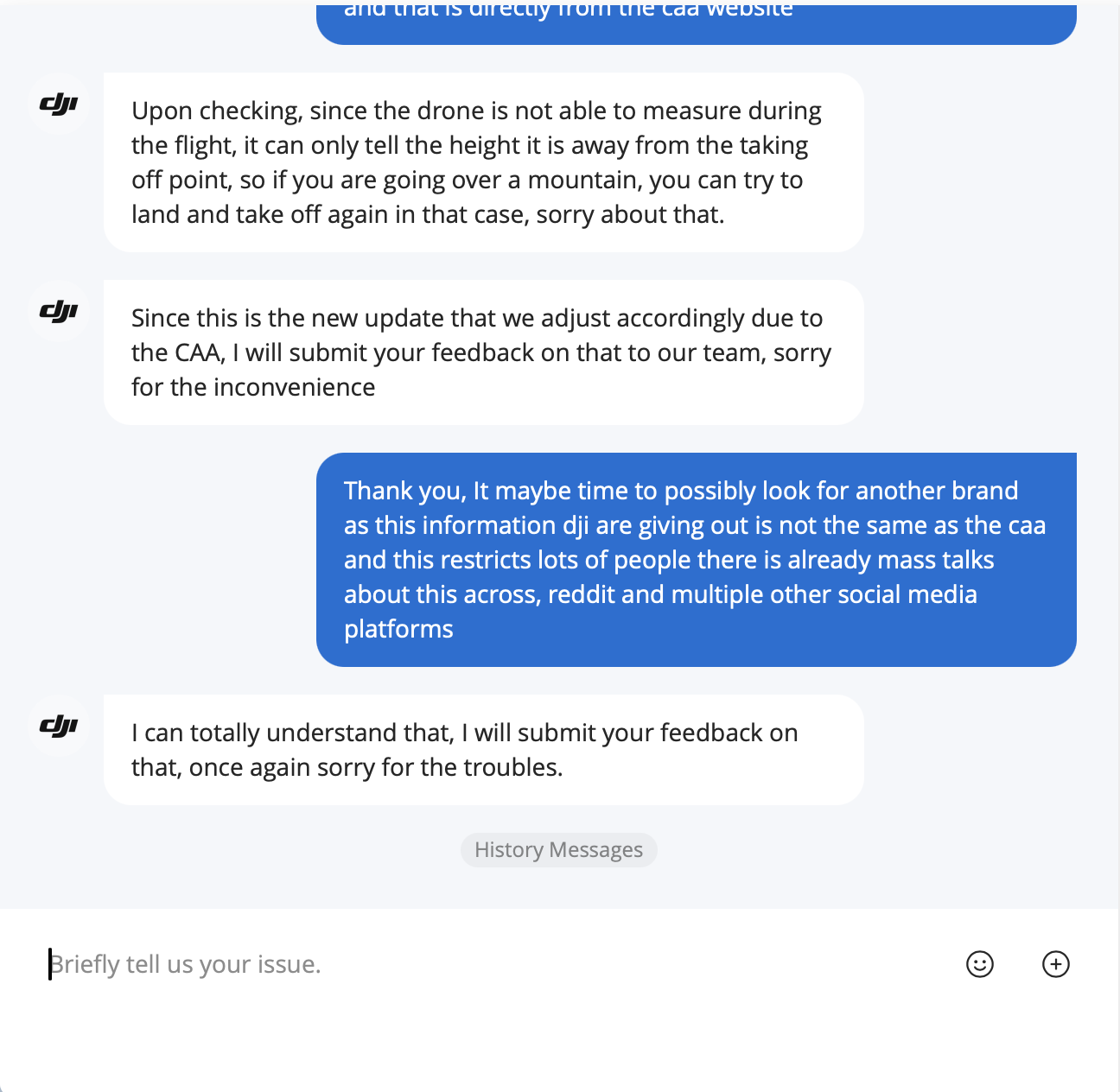

so I contacted dji and this is how it went complete load of horse Sh*t…
Makes no sense to me completely goes against what the caa state.

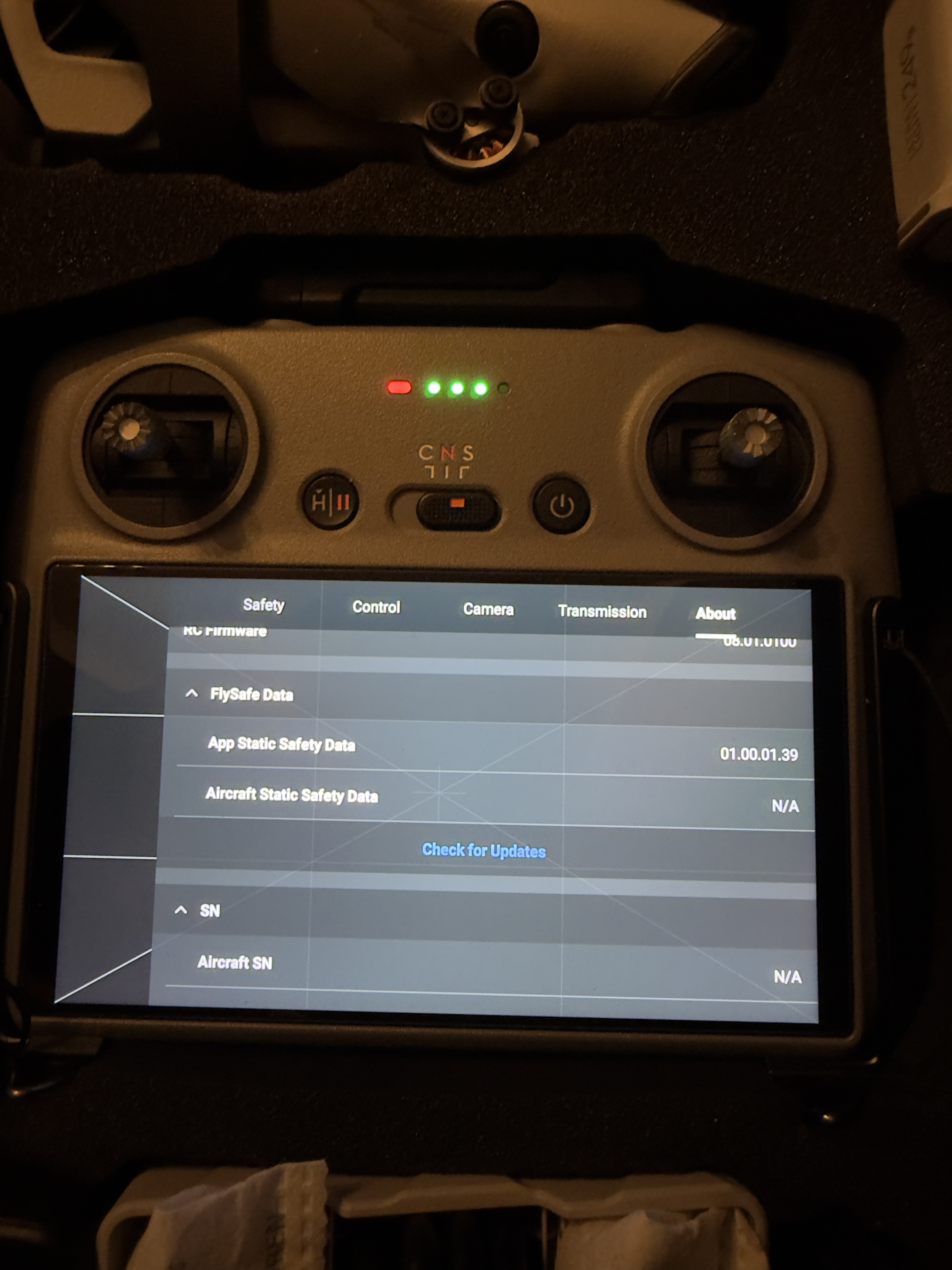

Is this info stored in the drone firmware? Flysafa data? Controller firmware?
If I have this all wrong I will stand corrected???

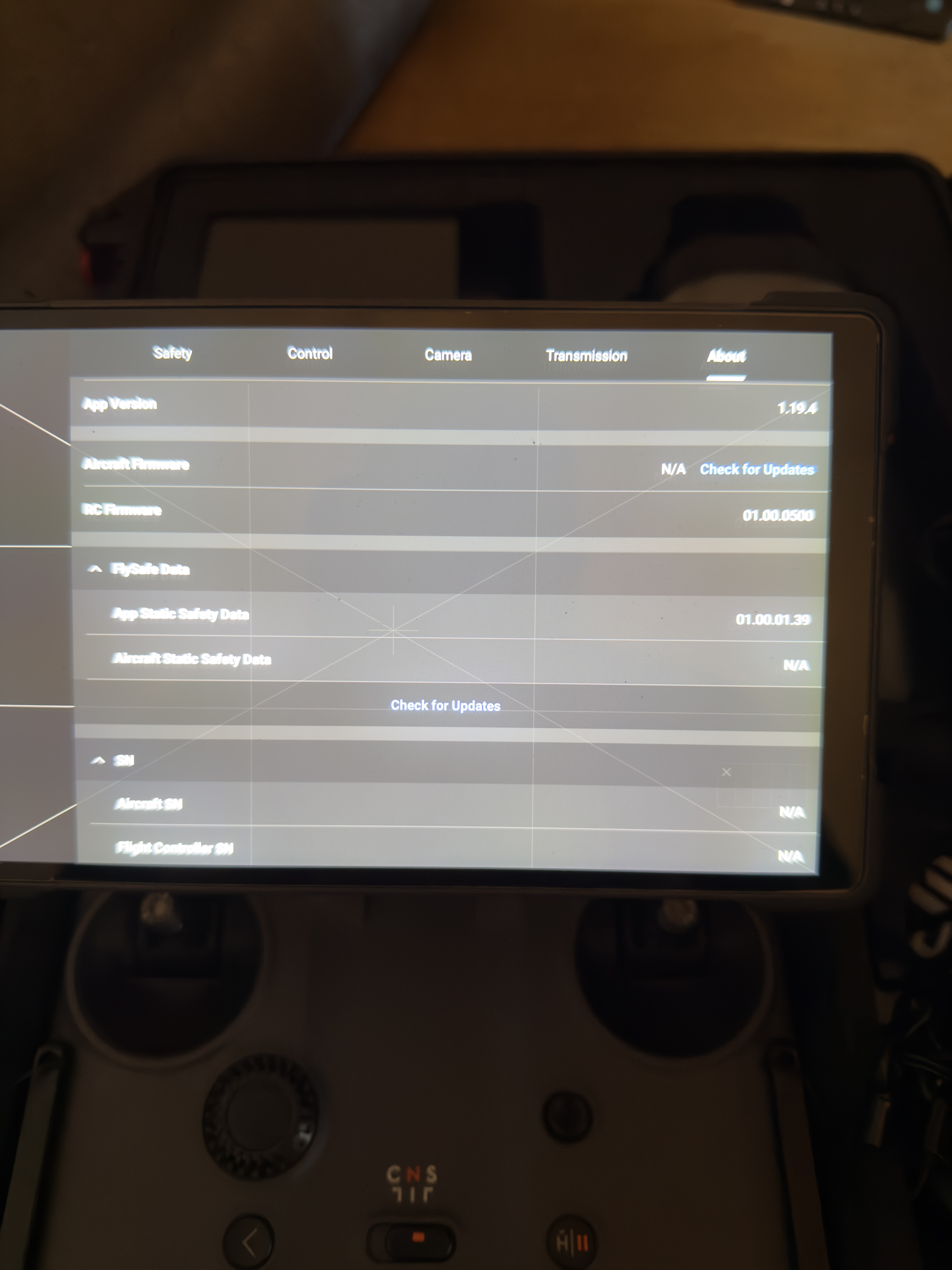

So tried my old rc2 that has not had the internet connected for months and this still has the higher limit I am downgrading the firmware now on my rc pro 2 to see if that solves it if it does then it will never get update again.
So it’s not the drone firmware that has the limit it’s either the controller firmware or flysafe database,
If the controller downgrade dosent work then I need to see if that flysafe data can be somehow downgraded.
I’m curious what your findings are.
Flysafe data is the same on both controllers the only thing I can think is it’s then the cotroller firmware which I will downgrade later on the rc pro 2 to test, If that dosent do it then they just have a sly way of downloading something in the background.
I have turned the WiFi off on the rc2 incase it does infact download something in the background :rofl:
The only thing I need to check is the aircraft static safety data but that could be different between models I will have a look at some point today and let yous know

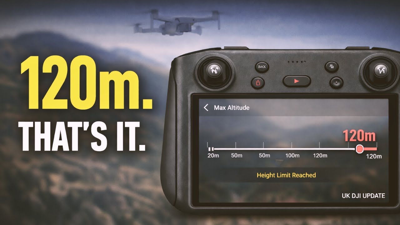

This isn’t a very new thing… …both my Air 3S and Mini 4 Pro have had these limitations in place since I purchased them. In the case of the Mini, it’s nothing to do with the CAA, but due to EASA requirements, as it has a C0 label. I guess it’s just something we have to suck up and work around when flying in the mountains?

A couple of years ago, Jen, DJI gave the option to change your C0 classified Mini to C1 if you wanted to fly higher than 120m from your takeoff point. This was a one-off decision you had to make the first time flying your Mini in the EU. I chose to keep the drone C0 classified. However, once back in the UK, the 120m restriction was lifted and automatically reverted back to your chosen setting.
The rules in the UK haven’t changed in this regard, as far as I can ascertain, so maybe DJI has unilaterally decided to make it the same as the EASA.

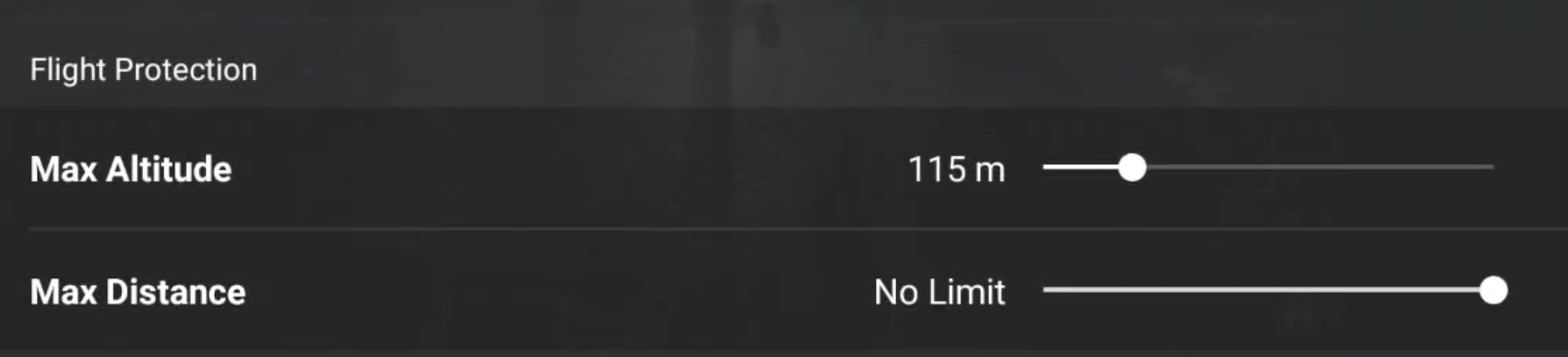

It definitely wasn’t the case on my Mini 4 Pro back in the summer. The following image was taken from a screen recording from my RC2 on 8 July 2025:
I was definitely able to set the Max Altitude above 120m.

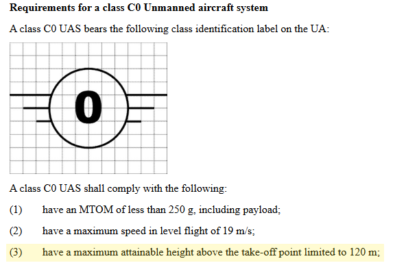

C0 markings used to have no meaning in UK legislation but, as of 1 January 2026, now they do as C0 drones are allowed to fly in the A1 subcategory.
In the Commission Delegated Regulation (EU) 2019/945, which is the legislation setting out the requirements for the C markings, the first three requirements for a C0 marking are the following:
Therefore, to comply with the C0 rules, they have clearly limited the height above take-off point.
You would be able to set set a higher Max Altitude with a C1-marked Air 3S, just as you can in EASA countries, as the rules for C1 are slightly different.
