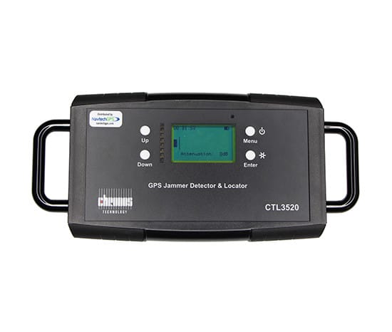

Is there any device you can buy to detect jammers ?
@bannerman100 This was the device Panorama used when tracking stolen bait vehicles to yards and compounds that were broadcasting GPS jamming signals to defeat the trackers in the stolen cars:
Drone assist shows if there any active ones it shows up blue but you can buy jammers seen them on a Russian telegram
