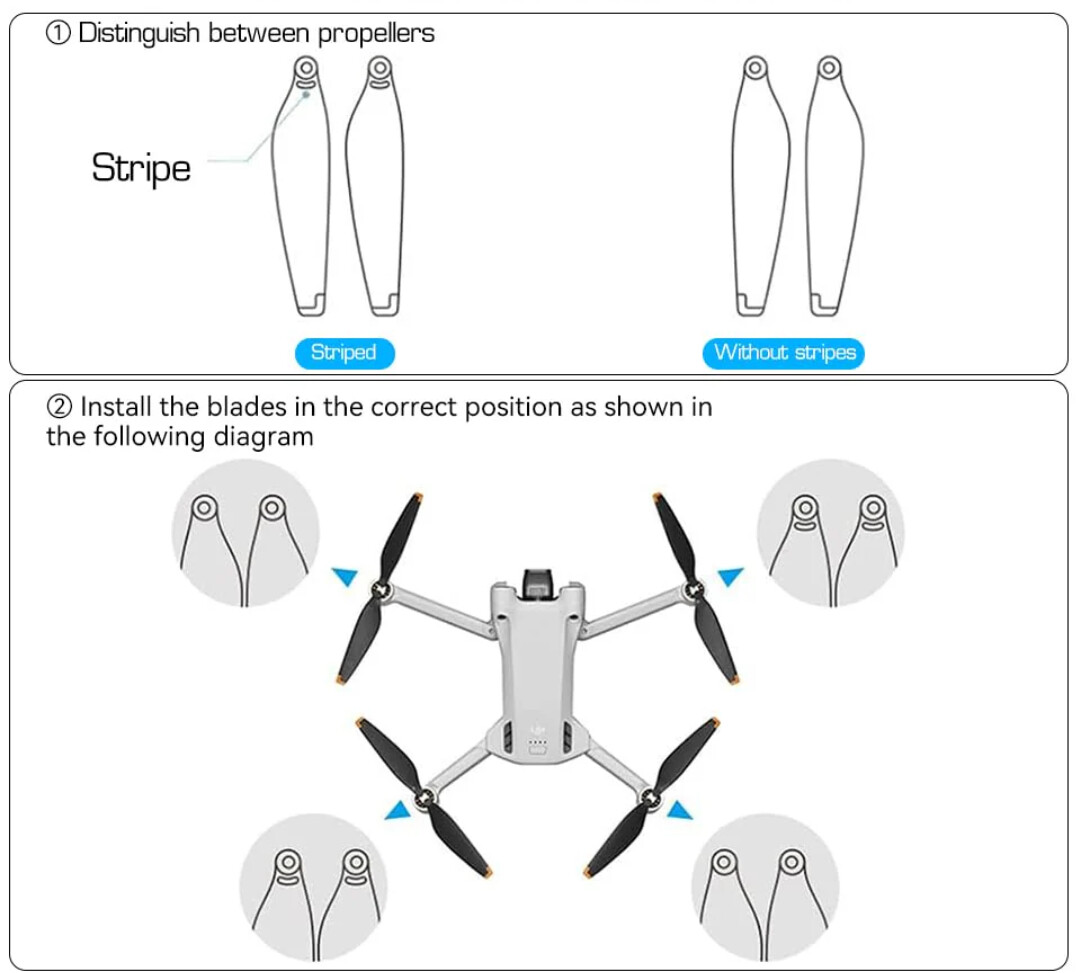

Is this when you were using the aftermarket props? With regards to your other post about them, I’m wondering if you had them on the correct arms.

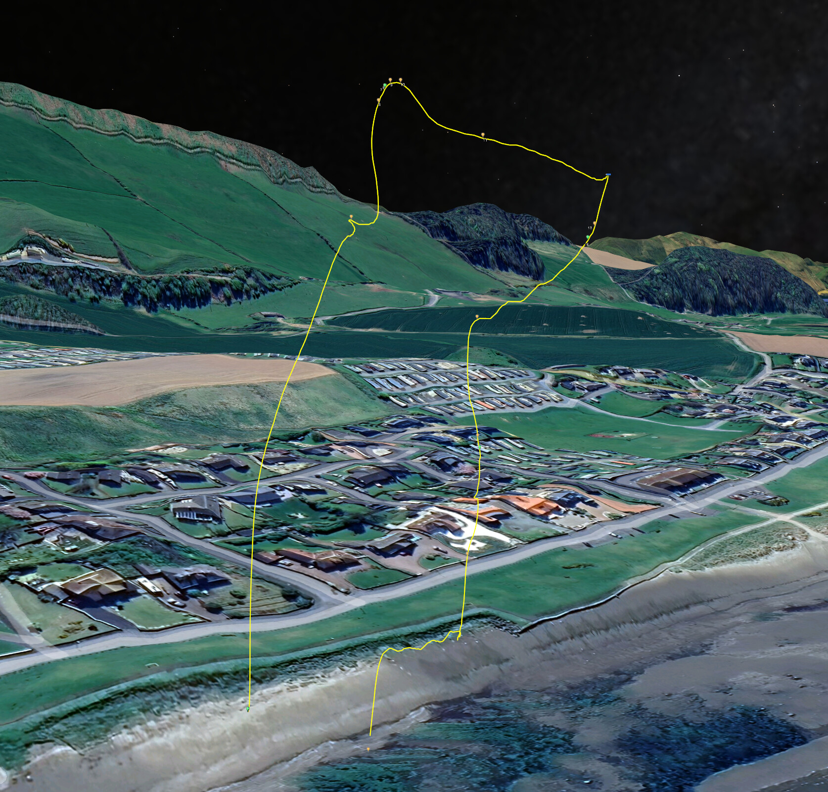

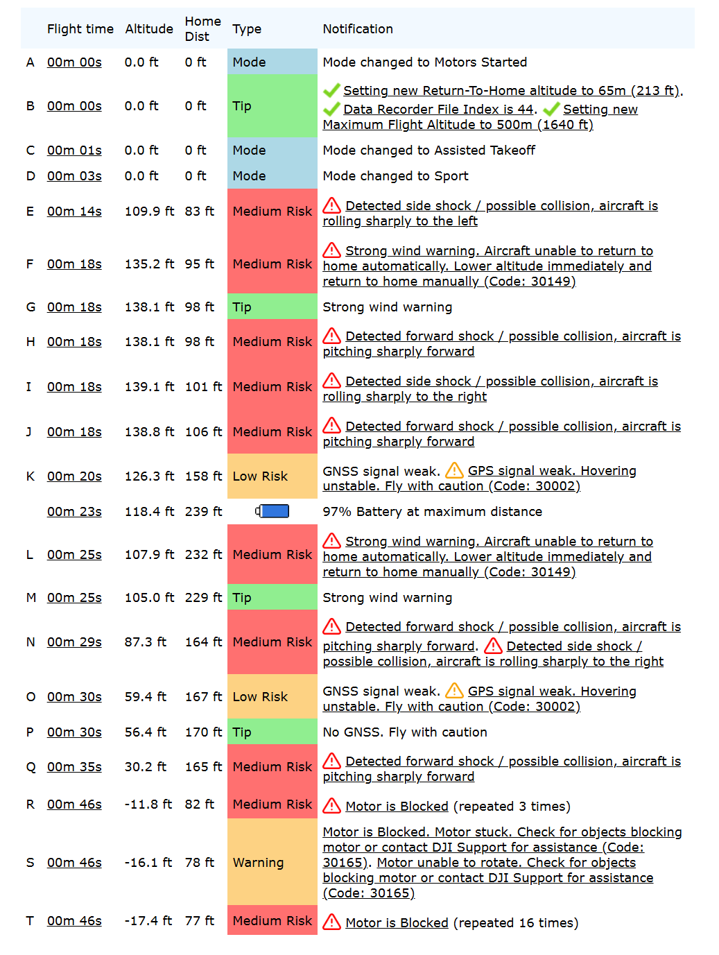

The aircraft logged side and forward shock, possible collision several times after 14 seconds of flight time, once you reached 110 feet.
It also logs a strong wind warning, but the weather logs show wind was only 8.7 mph from the north east. So I doubt it could be that.
I would have suggested a bird strike if it is was a one-off, but the side and forward shock occured 6 times.

Over/under tightened props?, could be anything
But if the only thing you have done (if you haven’t bumped into anything) is change the props then I would start with that and work backwards
Props on wrong would make it flip. But to be fair, it would normally happen as soon as you try to take off.

You switching it in to Sports Mode just three seconds after taking off will have that effect :grin:

I have today sent my mini 4 pro to them, under warranty, after it fell out of the sky yesterday. The airdata logs showed initially “motor is blocked. stuck motor”.
