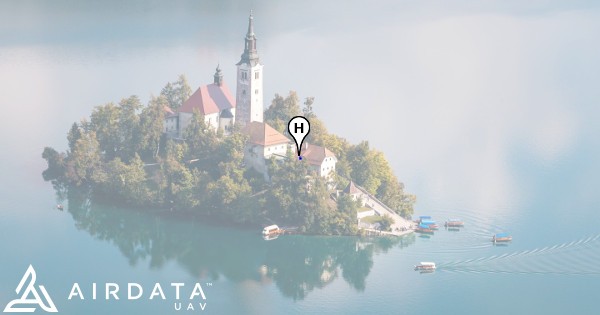

Ahhh it’s now appeared… Here is a screen shot… Still none the wiser as there is no mention of any errors or issues…
Have you just changed the propellers? If so, check you’ve got them on the correct way.
Props have not been changed . :+1:
Can you paste the link to the AirData … more info can be extracted than is visible in that screenshot.
Hope this helps…
Alas - in this case the logs show nothing more.
There was a time when they used to show individual motor speeds, so was hoping to advise which motor wasn’t behaving.
Stick movements all look fine … so definitely take this up with DJI.
Usually … a flip at take-off is a prop on the wrong corner trying to descend when the others are ascending, but if that wasn’t the case I’m sure the onboard (far more detailed … AND encrypted :rage:) logs will show what failed, and DJI can analyse them.
