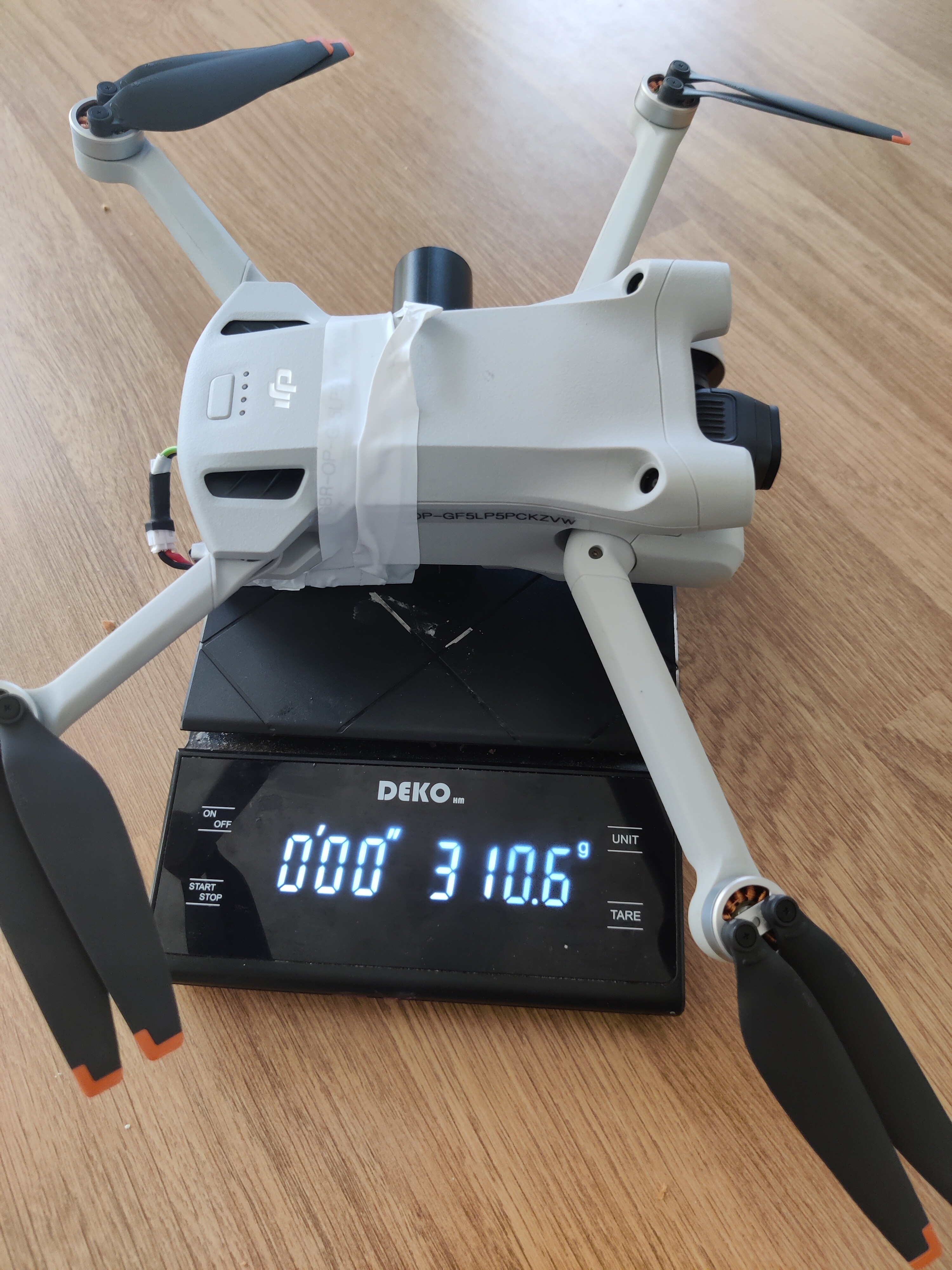

Quick follow up to this, whilst not a maximum weight, I can say the Mini3 will happily take off and fly at 310 g TOM, doesn’t even throw any warnings on the display (I know the Mini2 used to go into a ‘payload’ mode if you added weight past a point)

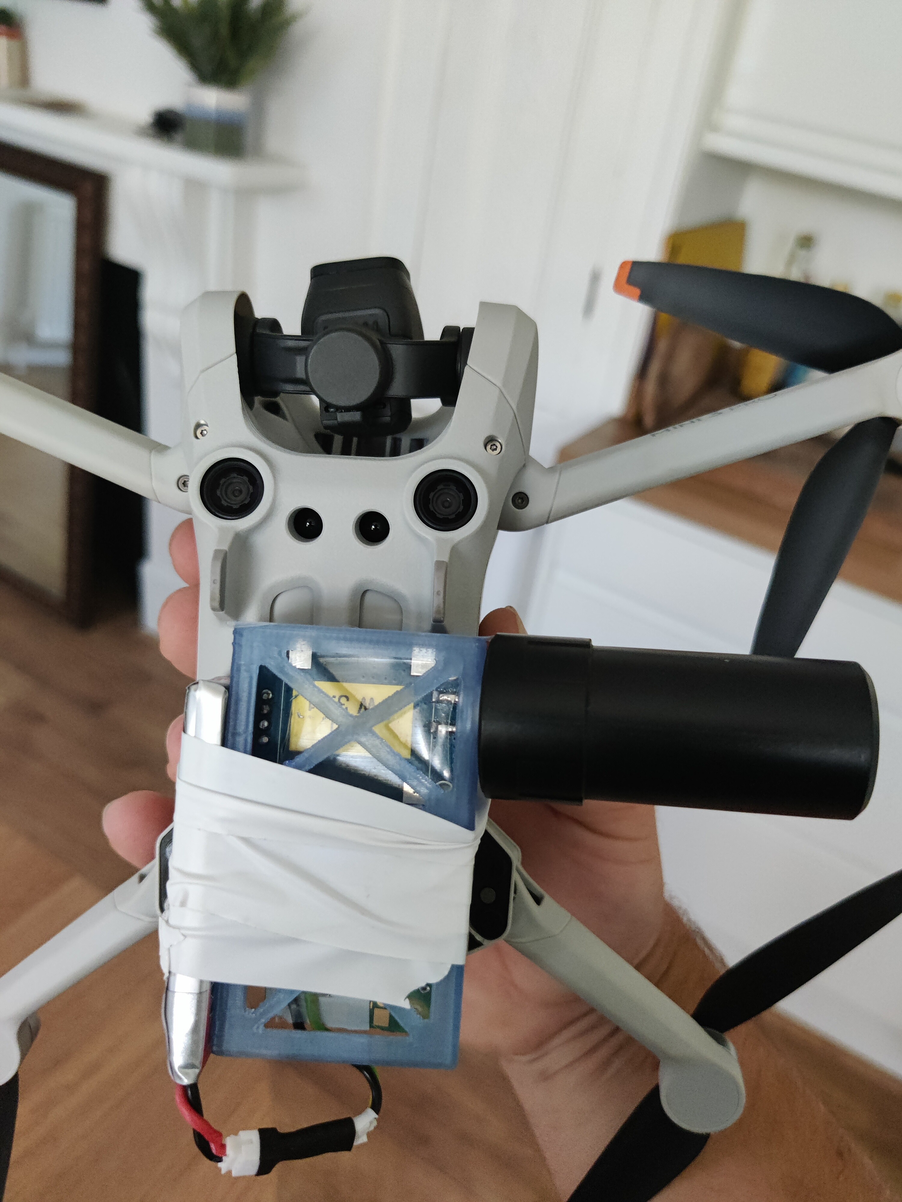

You can also happily stick a payload very close to the vision sensors without it disrupting them.
So with that said, here’s introducing the first prototype RTK capable* Mini 3 Pro! Just waiting for a small cable to move the antenna mounting to the top of the drone, as it is if you stick the whole assembly up there it blocks the inbuilt GPS a bit too much
*Technically PPK if you go out of WiFi connection range, and the drone itself doesn’t actually use the high precision data you have to postprocess the images with it
