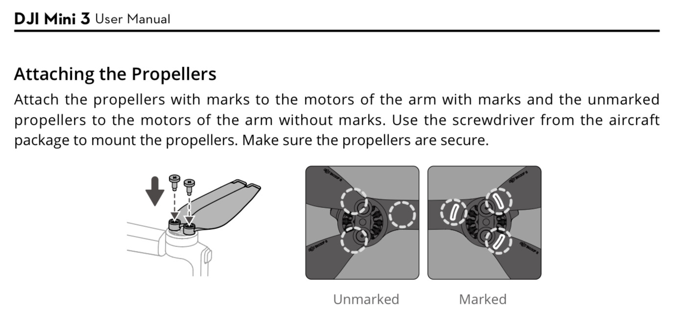

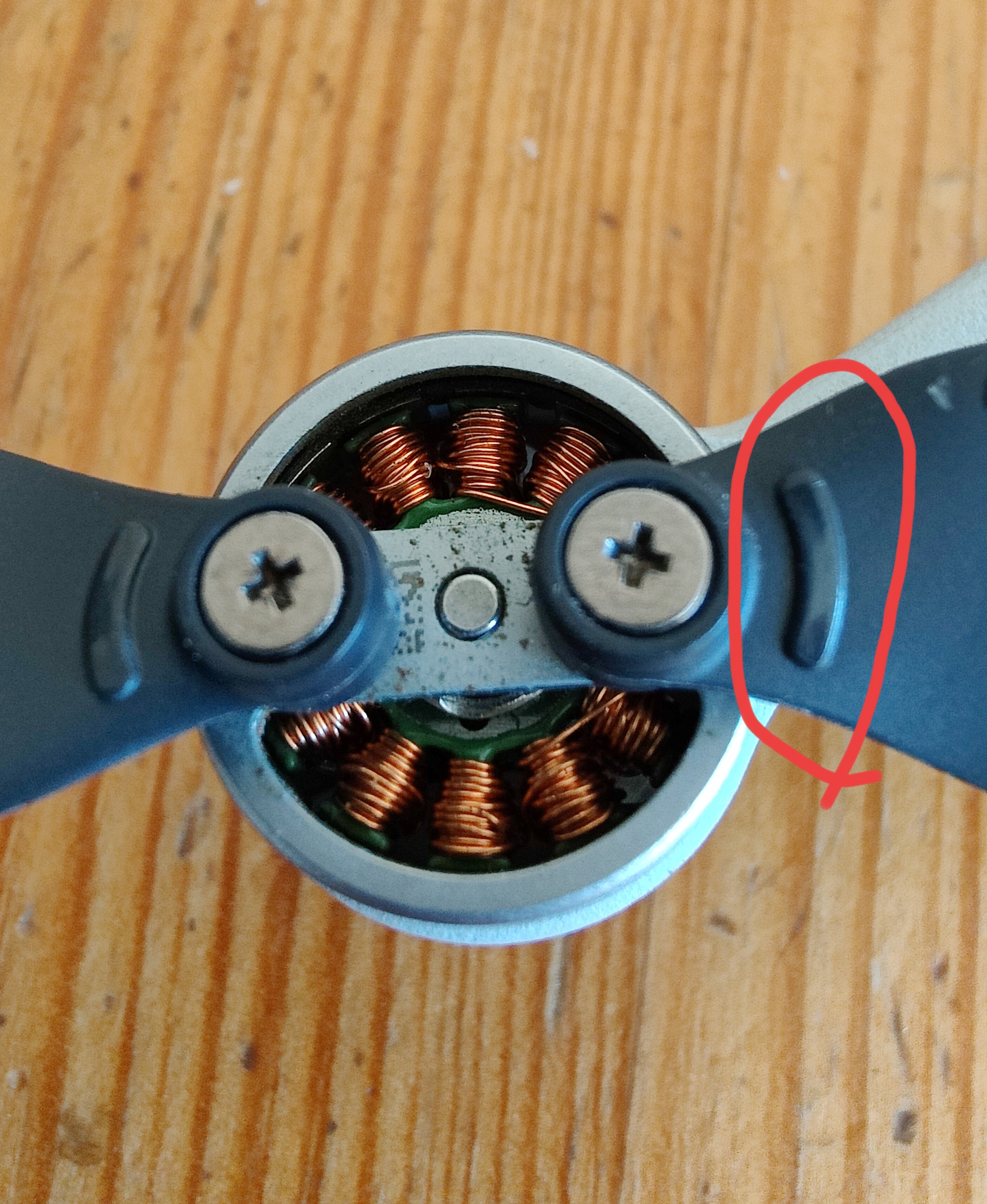

Is imagine the Mini 3 has the same prop markings as my Mini 2 .. those for the front right and back left having these marks.
It’s shown on page 21 of the user manual.
