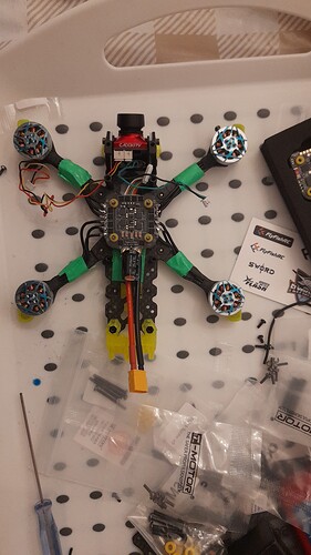

I have started building my first drone a volador flyfish 3". The parts list was based on a list by the youtuber “Sam The Hoarder”. I am not entirely sure what I am doing, so far I have installed the bottom esc and the motors. There are two rubber pads in the frame kit, do I need mount my electronics on these. There are a couple of things I am not sure of.
1 Should I mount the ELRS on the underside of the drone in the yellow tpu holder thingy ?
2 The VTX came with two different aerials - should I have a lollipop mounted on the end of the aerial or will they work as is ?

1 - Yes
2 - Lollipop but it does not matter that much IMHO.

So far because the drone in 3" I have struggled to fit the electronics into the frame. The rear aerial caddy is useless because I have been unable to fit any vtx aerial cables through the hole at the back. The hole could have been made bigger or designed slightly differently to allow for this. I might design and 3D print a different one.
I couldn’t use the lollipop aerial I bought in the build because it couldn’t get it to fit in.
The drone weighed in with battery at about 270 grams 21 g over target weight. I think I should be able to get it sub 250g by using a smaller battery at the expense of flight time.

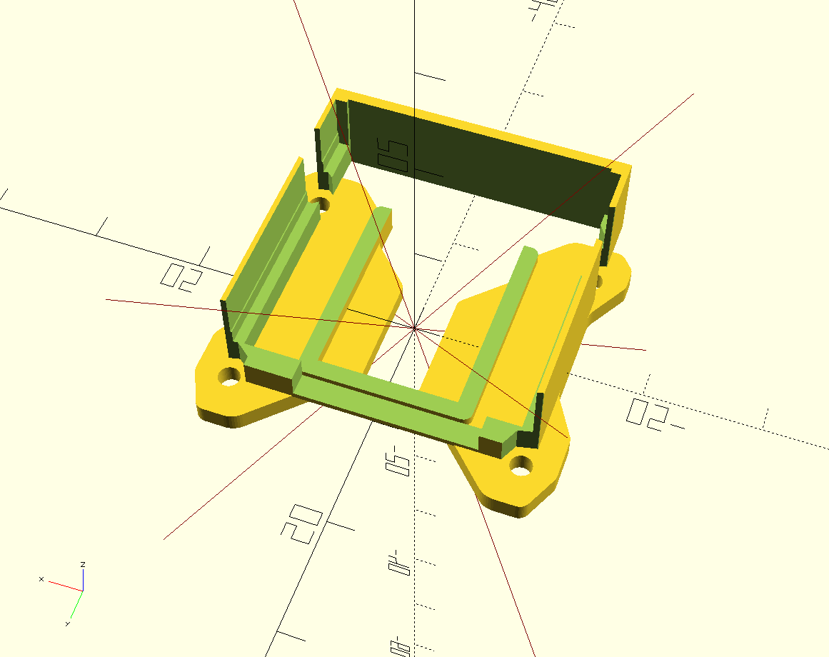

Ok so I think have finished the physical build. I bought a holybro micro GPS to replace the BZ-181 GPS. The holybro micro GPS works really well, but it’s not very mico. I couldn’t find a holder for the GPS unit so I remixed a holder I found on thingiverse and mounted the holybro micro in it after I 3D printed it. The holybro is stuck in with foamy pads and mobile phone screen tape.
