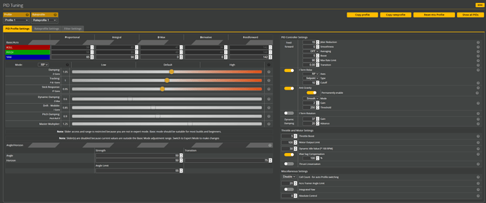

Also, regarding the tune; I have no idea what the BF defaults look like but the PID/Rate/Filter tabs look thus in BF4.3.2:

Go for it, as long as there a 4.3.2 firmware available, should be good! Wonder why it’s on 4.3.2 this how it came if iFlight don’t have it on there downloads
What are you thinking - just make sure I have backups of everything, flash to 4.4.1 or go all the way to 4.5.0? Reckon it’ll just work or will I need to attempt to re-apply the tune somehow?
Might as well go the full hog. Default tune will fly OK, it’s a 5inch. Might not fly 100% as well as it “could”, but I doubt you’d tell the difference, lol!
Just try a hover in angle and arm once you got your modes and rates, etc sorted :slight_smile:
If don’t hover well then well… go back! I’ve never touched a default tune when I flash anything really
