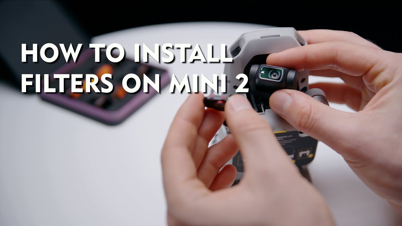

I don’t know much or anything at all about the mini 2 but this guy I’ve followed on YouTube for ages, seems to get it right most of the time, he also leaves a link for the mini 2 filters he chooses, maybe worth a look,
Edit : that said I see you have free well, sorry but might be good for a tip or two.
Thanks, for the advice on this, this has been at the front of my mind when I saw the camera for the first time when I opened the box so I’ll bear this in mind. Do you use any filters, if so which ones ? Thanks again for getting back to me.
Thanks Kirky !! This guy seems to know what he’s on about so I’ll also bear his advice in mind. Thanks again.
That’s ok, the guys above really know there stuff on the mini 2 I know, so I’m not going over anyone’s head here by no means but, as said he knows his stuff too & is a big fan of the mini 2, just trying to help out if I can, good luck :+1:t2:
He leaves links in his description for what he uses & or works for him.

Try that @outRAGEis and check your filters are not bent / damaged like he says in video, I don’t usually watch this guy but it might help, hope so, good luck
Perfect. Thanks for that.
