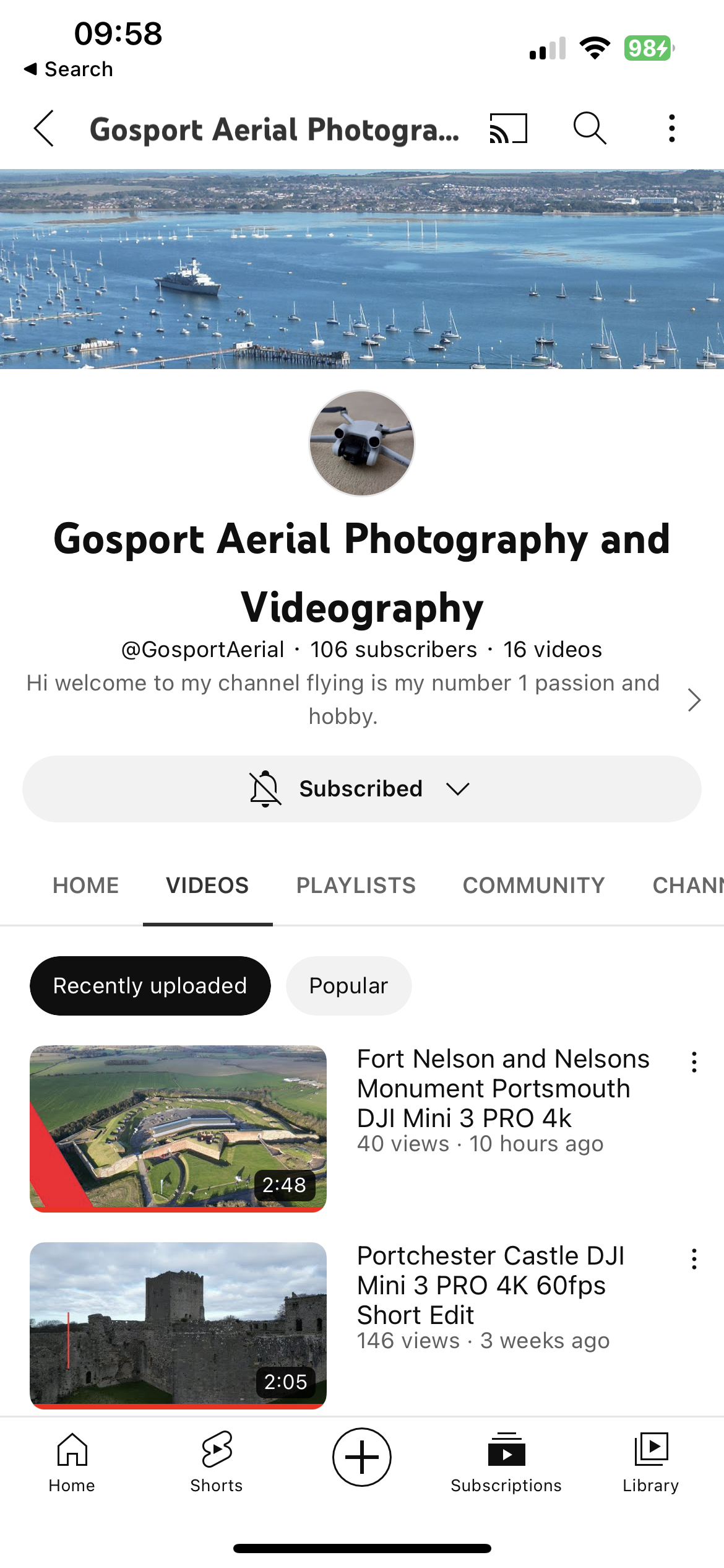

I met up with Ian who sorted it all out for us the picture is his YT channel and he can let you know who he emailed and spoke to :+1:t2:
Ian also sorted it that we could even fly inside the FRZ so definitely have a chat with him he’s got the email and phone numbers you need :+1:t2:

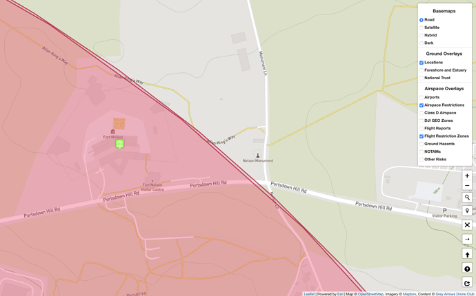

my understanding is that the red is from Fleetlands, the yellow which extends further (not on you pic ) is Lee on Solent Airport…

is the Yellow not a NFZ??
@Indy-Garden please turn off the DJI layer :blush:
Not sure what you mean when you say NFZ (are you talking about the DJI NFZ?) but the monument itself is outside of the FRZ.

NFZ …I thought all airport areas shown were no fly zones… unless permission is obtained.
The yellow area is a DJI NFZ, but they can be very random (and have little to do with the actual UK/CAA NFZ’s)
I believe DJI drop the same restriction on each airport, but you can ignore it … you only need to worry about the ‘official’ CAA FRZs.
I know I’m dim … but that is the red area??
Yes… the CAA FRZ is normally a red circle … with straight sided red rectangles that effectively extend the restriction in line with the runway. The DJI version is a ‘fan / triangle’ shape in the same area

It is definitely not within either FRZ :confused:
Here are the two FRZs, and the monument is safely outside of them both:
But - you will need to unlock some, through the DJI app, before your drone will take off in them. So check, and unlock, before you totally ignore and find you don’t have a mobile signal at the location to do the unlocking. :+1:
The monument is just outside the FRZ but the Fort just next to it is in the FRZ
Yes he’s a member and he’s posting the information need on my post if that’s ok :+1:t2:
