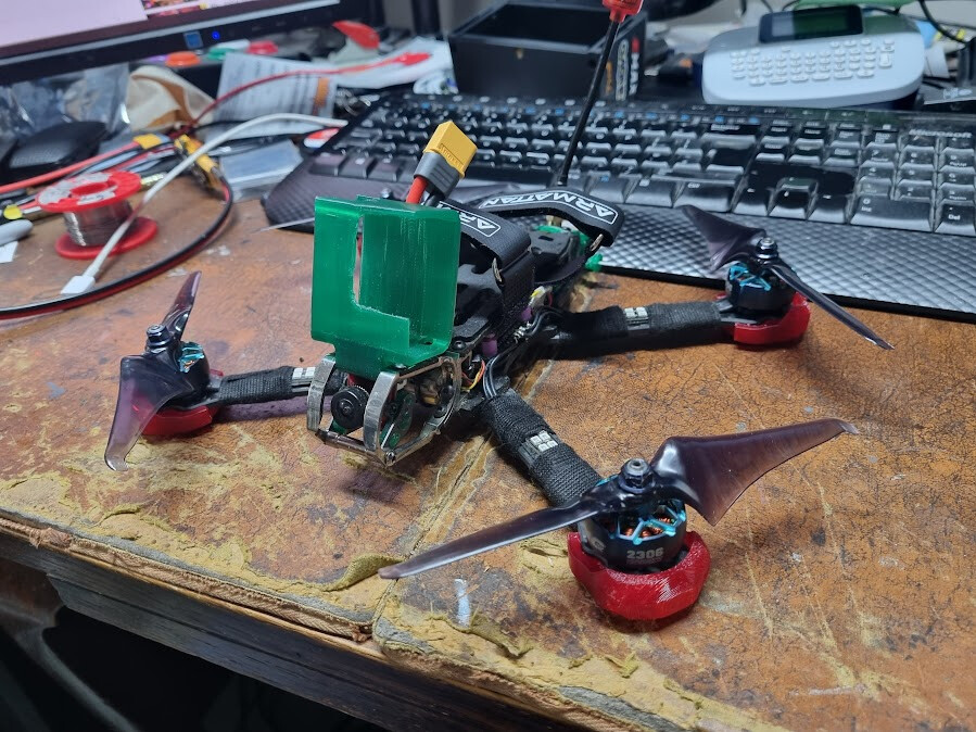

Replacement arms arrived from Armattan and now it’s a 6" Badger…

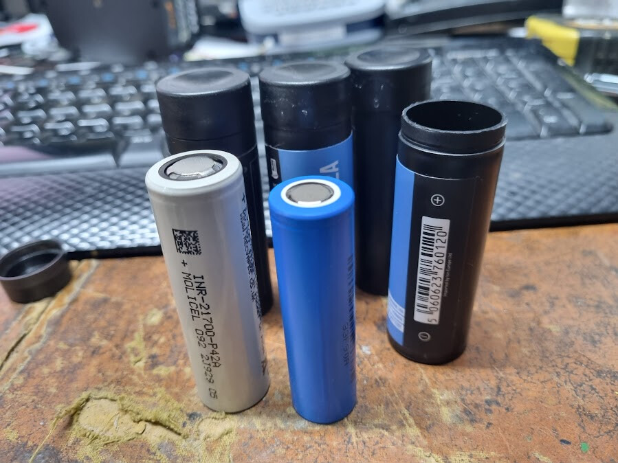

Also the 21700 4200mAH cells arrived. Next to an 18650 for scale.

A quick hover test in the back garden… It flies…

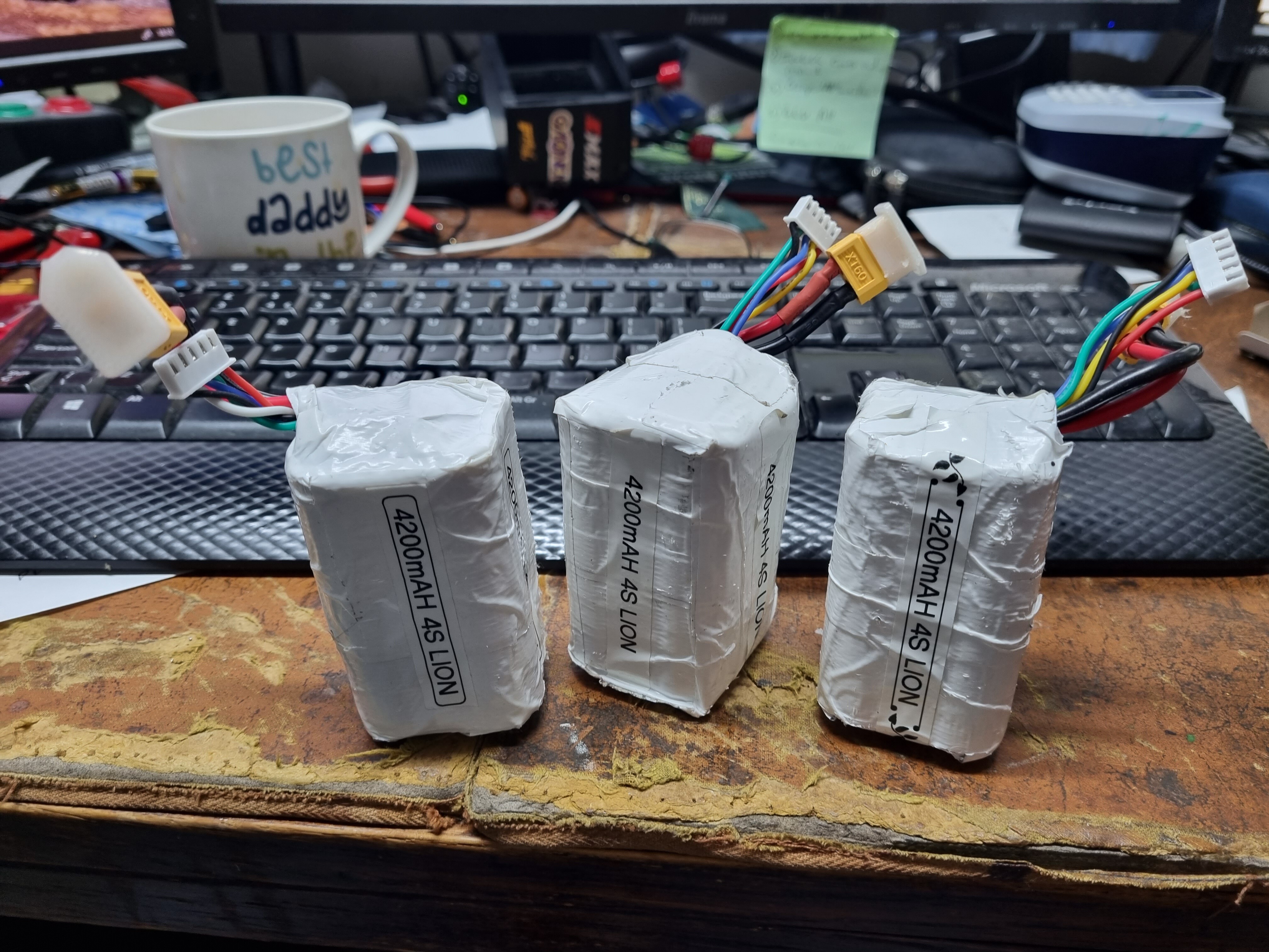

A long time since I posted on here, but I thought I’d mention that with the 4S1P 21700 42Ah Molicell packs I made I have had between 9 and 12 minutes of cruising flight time.
They get barely warm at that and it is possible to do a bit of freestyle. Maybe more than I have been doing. I’ve been pretty careful.
I now have 3 of the packs made up:
Soldered or welded?
Soldered
Well it’s ridiculously tight, but with the addition of a 3d-printed 20mm to 30.5mm mount I designed, I’ve managed to get a HDZero 1W VTX into this build…
