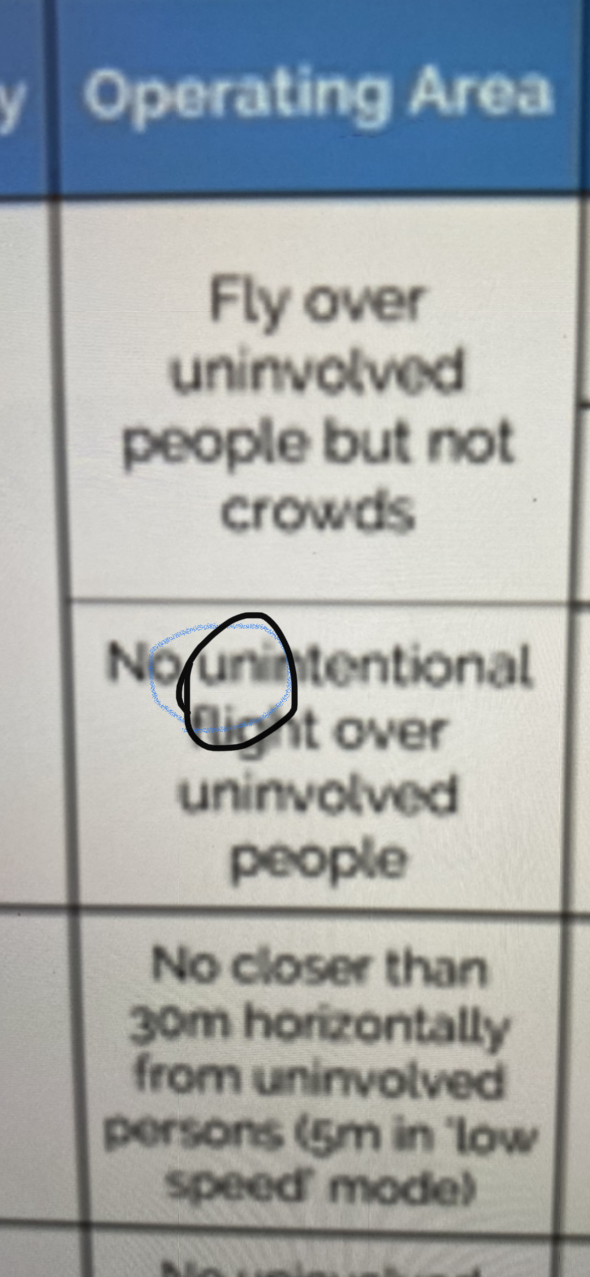

Ha! think that should have read no intentional flight over uninvolved people

In CAP1789 Annex C it says no intentional flight over uninvolved persons. That table looks similar to Annex C

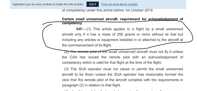

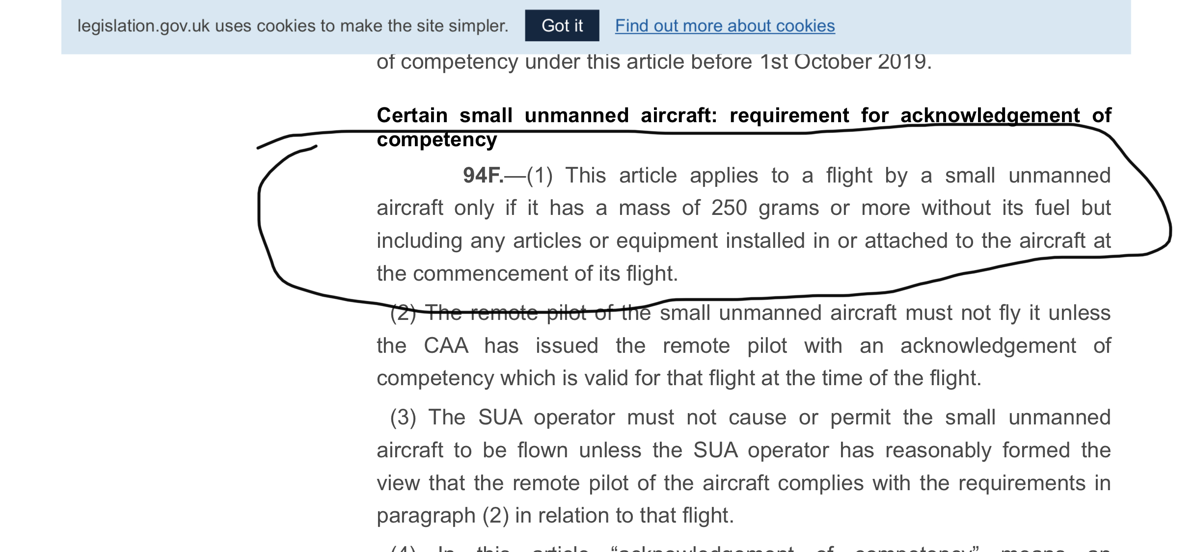

In which case the mini with its fuel (battery) is 249g (weight) and working on the assumption that you fly outdoors with the kit straight out of the box with no accessories that is surely what we should work with? If you decide to add legs, lights, GoPro etc then you would have to look at a different category.

You could argue MTOM should be calculated without the battery in but that might be pushing it :blush:
