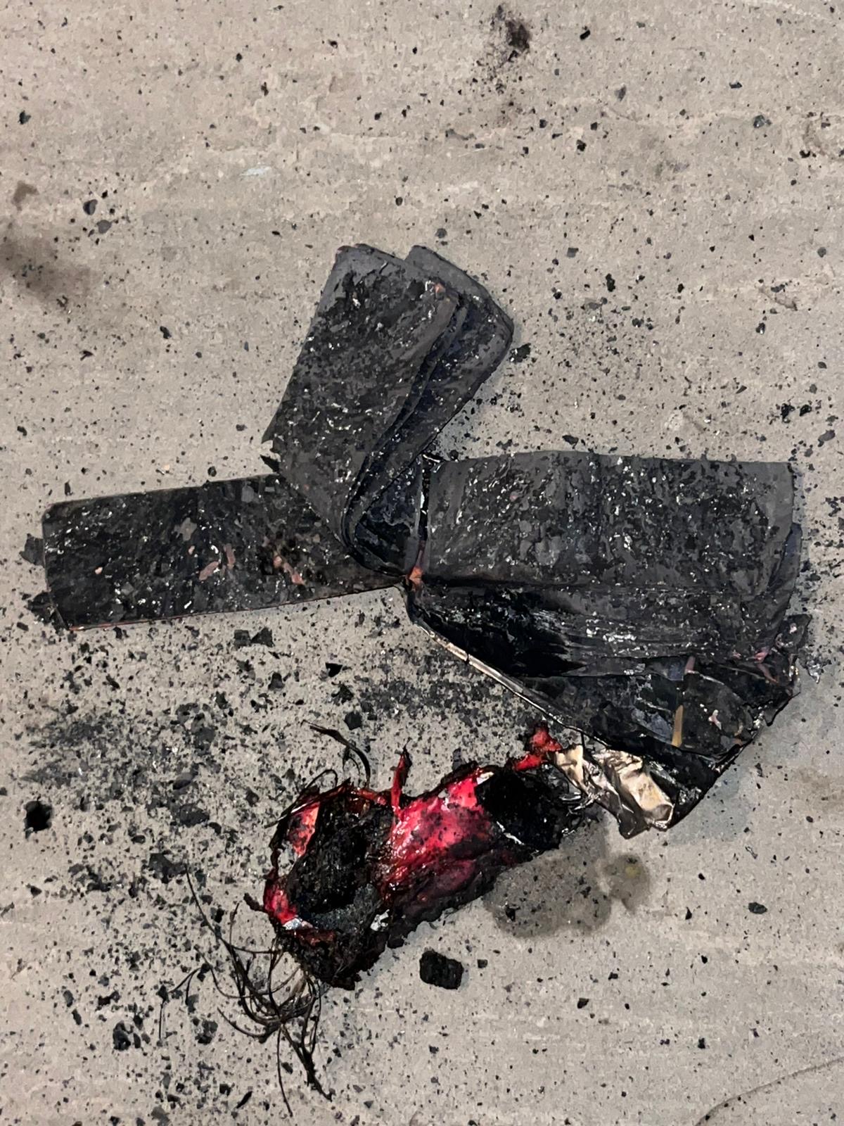

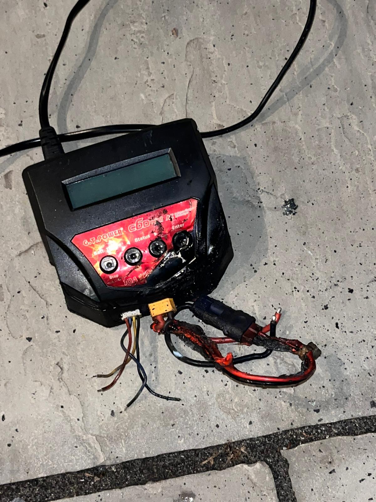

I had a lipo fire at home when putting a 3s 2200mah Radient into storage voltage - horrendous shock and got to the kitchen just in time to get it all out the back door whilst still on fire - only using ammo boxes and the garage now - and ToolkitRC and iSDT chargers for RC lipos
As a regular RC fixed wing flyer amongst a load of regular club members, lipo’s absolutely DO blow up from time to time but fortunately the causes are usually understood. Be safe out there and please don’t ever charge or discharge a lipo indoors if you’re not using a bag, or lipo safe or ammo box…that’s a horribly unnecessary gamble for the sake of a few quid. I charge my DJI batts in their charger - but on a ceramic base…
