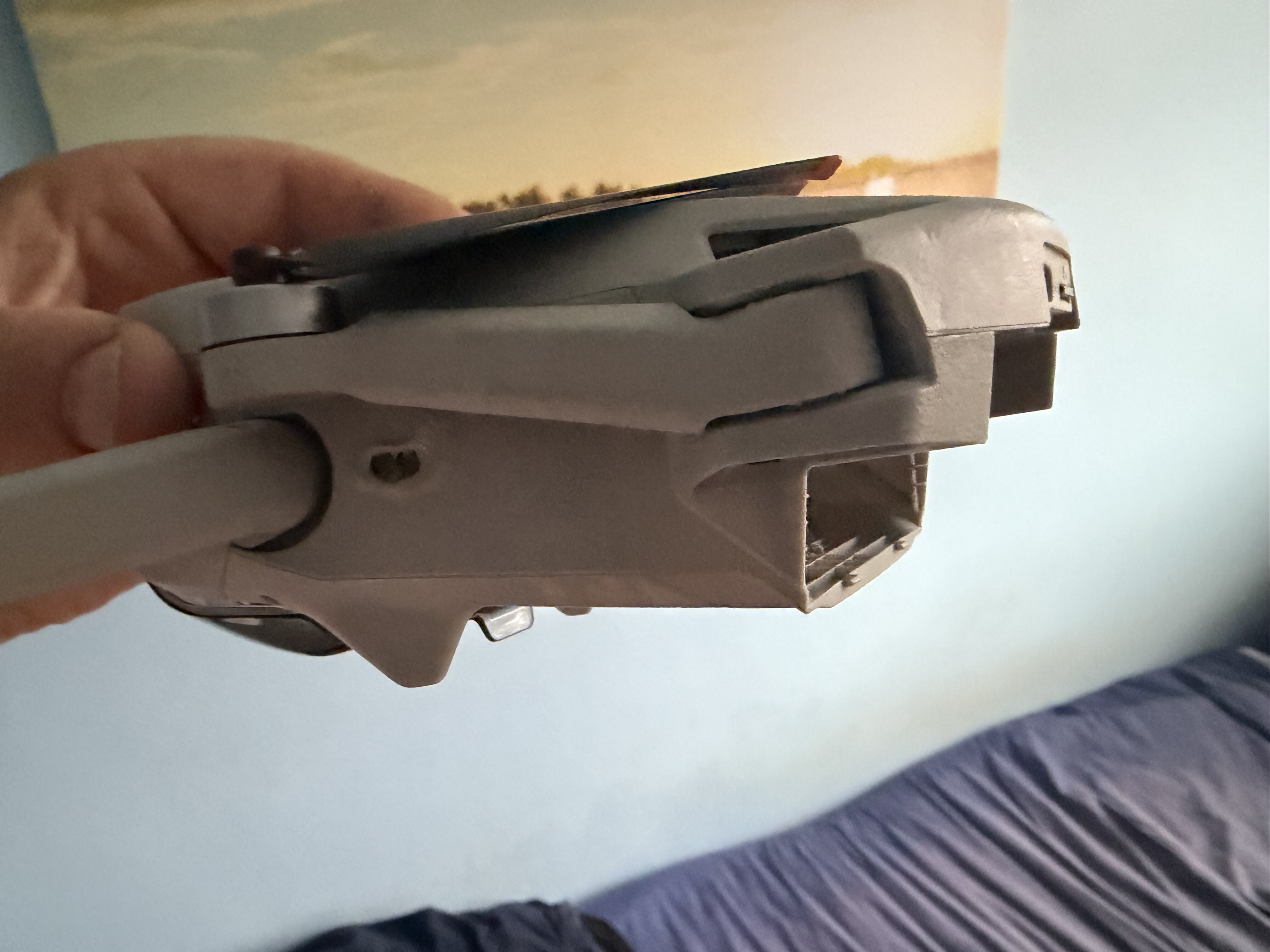

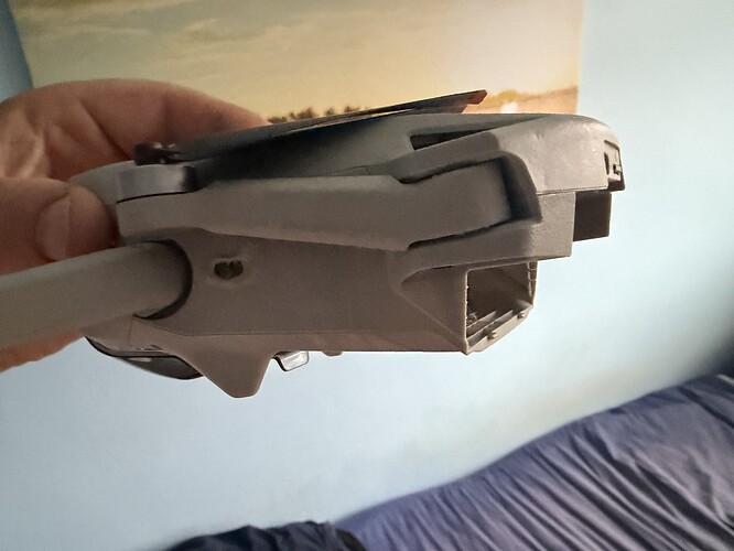

New to DJI drones and is this common?
I plugged the DJI mini 3 drone into a usbc charger and the green lights started to flash up to 3 leds, 10 or so minutes later there was a horrible smell and my drone melted a hole straight out the side.
Anyone else had this?

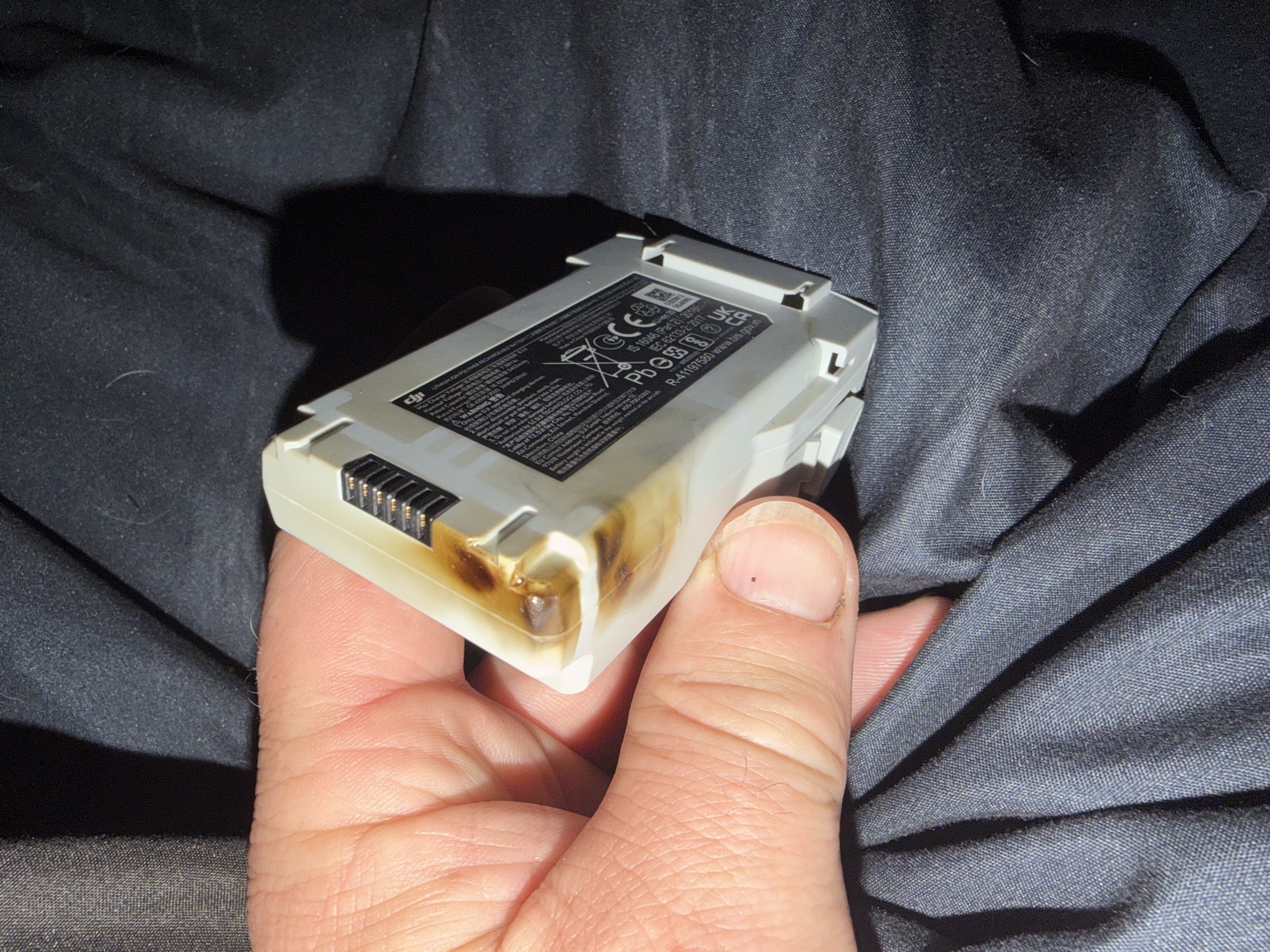

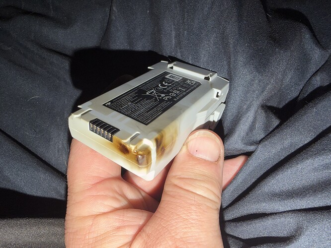

New battery that could be a fake ? DJI batteries are intelligent so they keep track of the cell’s / the health of them/ the temp of them - so they do a fair bit to try and stop this from happening and will just not charge. Reach out to DJI and see what they can co do help you out - they may offer a replacement of it even if you don’t have DJI Refresh they will make a plan - they are good at that.
That’s incredibly rare - in the photo, the upper body of the drone has some harsh looking dents (might just be the lighting) … do you know if it ever crashed prior … might have been taken apart and rebuilt with a bent pin shorting a cell …

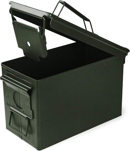

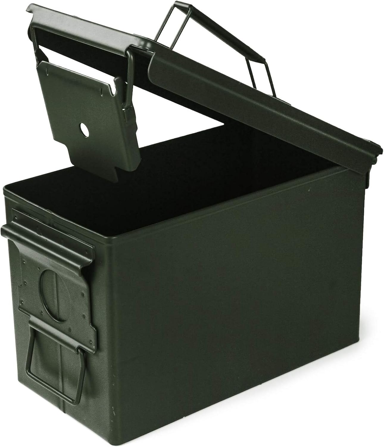

Also, you say you’re new to DJI drones, so is this a recent purchase? If it is and you got more than one battery with it I’d be very careful where you’re storing the others until you get an answer from DJI. At the very least, not in the house. But also Lipo bags if you have them. I have one of these that I keep mine in if they’re going to be sitting around unused for a while:
It does look like crash damage on the rear of the mini3, that’s just where the battery plugs in. The photo doesn’t show the rear of the battery, is there any crash damage there? If so the impact may have damaged the battery connector and the main pcb in the drone causing the charging circuits to misbehave.
If you didn’t crash and purchased from a reputable source try contacting them for a refund. If it was ebay sold as seen then probably bad luck. Try contacting DJI, they may offer a discount on a replacement.
Isn’t the damage on the back more an indication of deformation of the plastic due to heating? :woman_shrugging:t3:
I’ve one of those too Joe - highly recommended… …though mine’s 7.62 ball rather than .50 cal, and it came free with my daily shilling :wink:

Bought new from Argos. No damage to the battery or drone

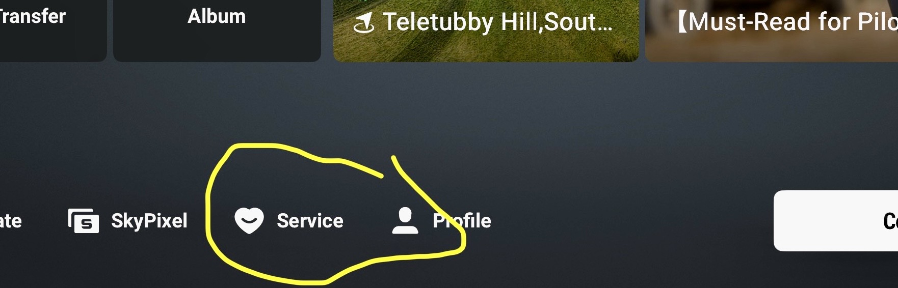

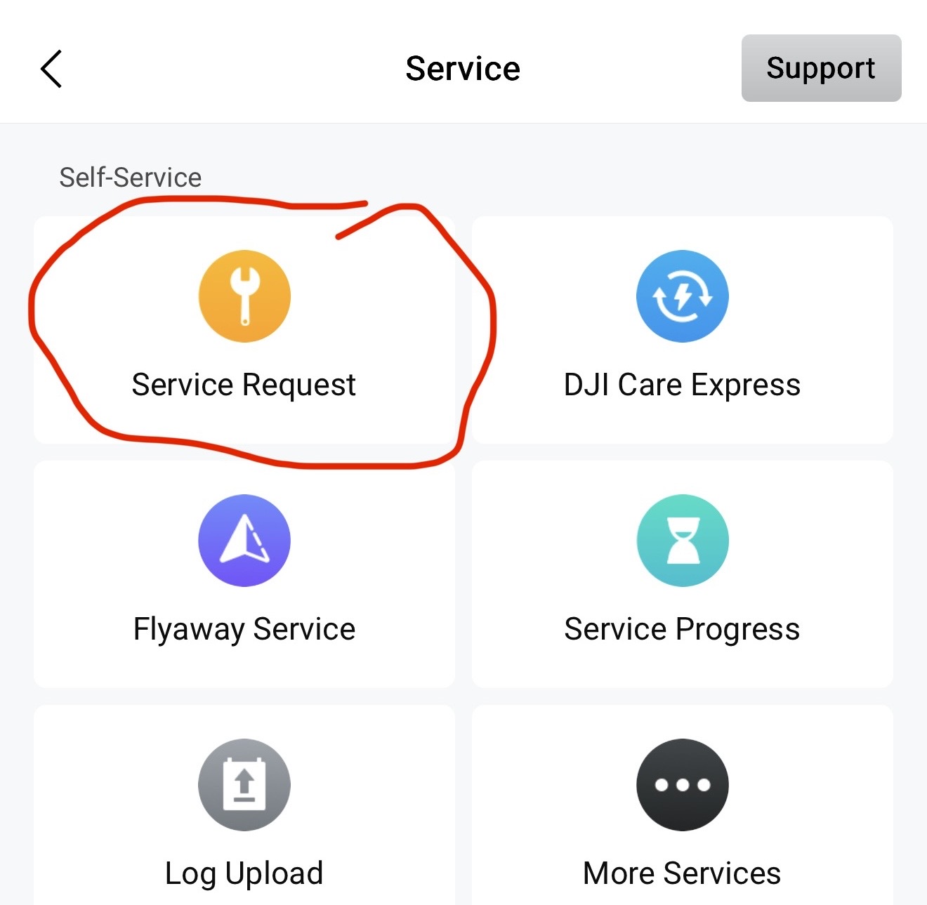

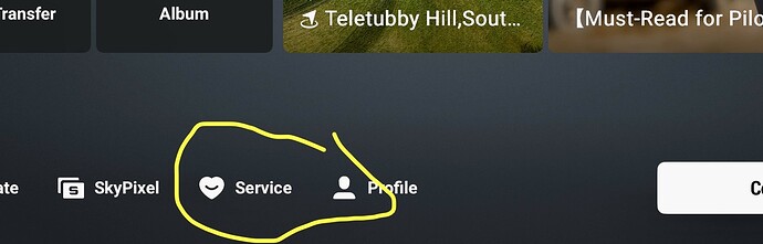

If I were you, I’d definitely be raising a claim with DJI, it’s easy and can be done via the Fly App.
