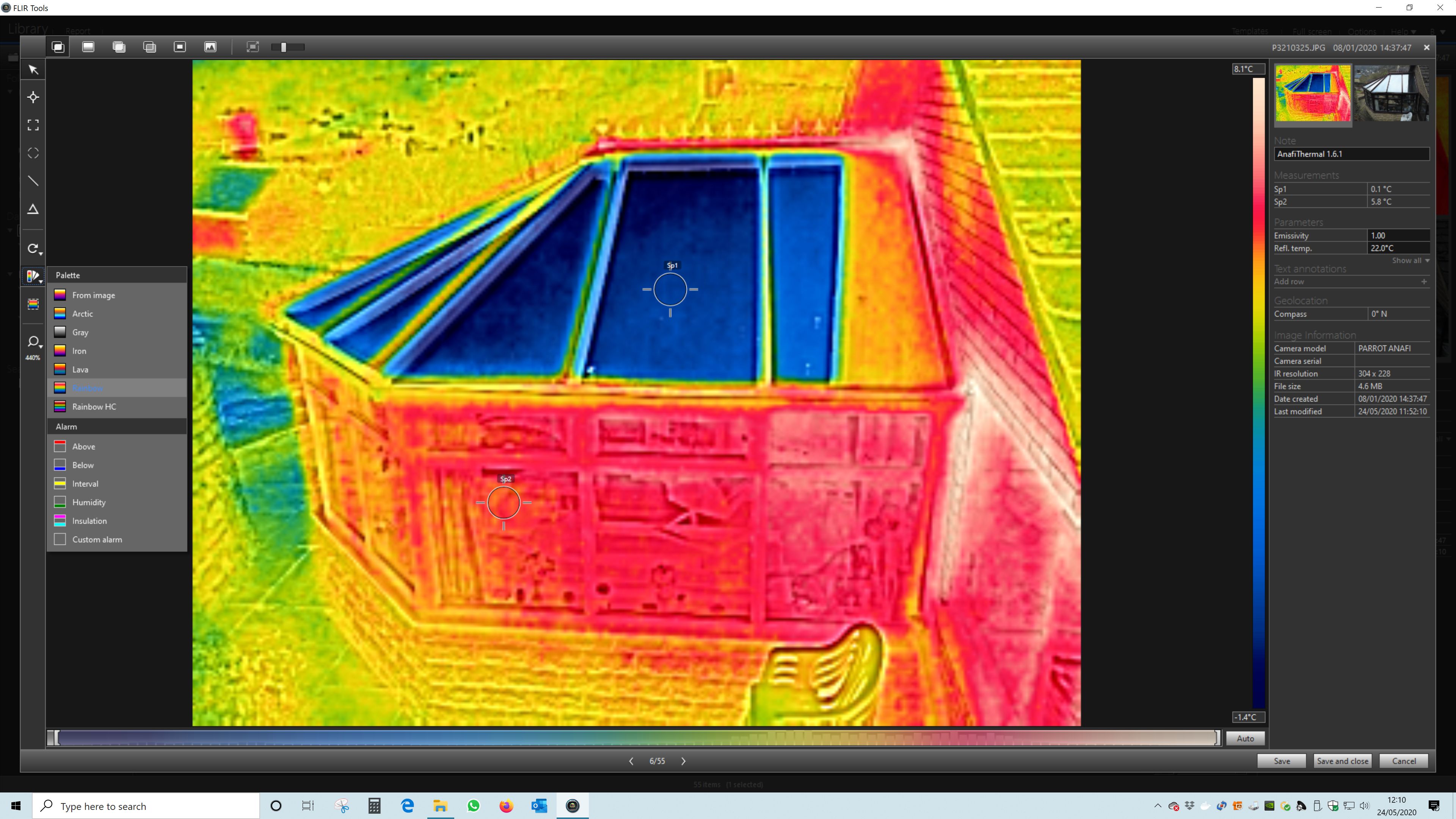

I have an Anafi Thermal and quite pleased with it. It does have limitation on the thermal side (as does the Mavic dual. same sensor) in that the resolution isn’t great. Certainly not a lot of use for S & R if that’s what you are thinking of. I found the Anafi thermal software to be better than the Dual and it’s radiometric which the Dual isnt. The zoom function works on the thermal as well as the vision camera. I is a great tool for checking out thermal panels on houses etc and looking for heat loss on buidings where you can get close up assuning you have the correct permissions.

Thanks for the info on the anafi thermal, though I thought this and the mavic weren’t radiometric and you would need to look at the XT1/XT2 for that?
Could you show me an image that has radiometric info on it if it does please?

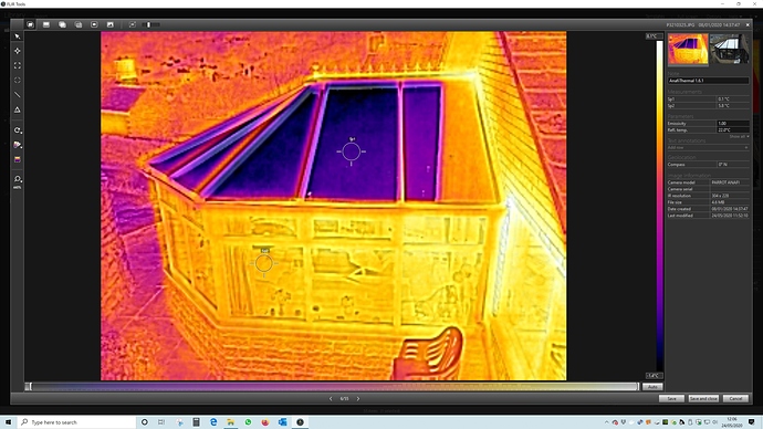

Stuart. Few images here from FLIR Tools (free download) clearly showing the radiometric info. (SP1 etc). Also showing some of the different colour palettes available in FLIR Tools some of which are also available on the drone. I found it much more versatile than the demo Mavic Dual I tried. The last file is the original of the solar panel on the campervan so it should be possible for you to have a play with FLIR Tools. Hope this helps.
Hi Brian,
Thanks for the images, i tried the last one in FLIR tools but couldnt get any temp readings from it? It maybe me using the software incorrectly as not used it before!!!
Its interesting that you can see temp readings as i thought this and the mavic were the same sensor and radiometric readings werent an option. It still looks like a cheaper option than the mavic though ive seen a few reviews saying this isnt any good for solar panel / roof surveys. You images have given me a bit more hope.
Currently the Anafi thermal is £1699 with extended pack so a good saving over the mavic.
regards
Stuart
Yes it is the same sensor but the software is different. When I had the demo of the Mavic Dual I also had a go with a Matrice with an XT2. This is really the way to go but so expensive. I attended a seminar about the use of IR at Nottingham Uni and the guy there recommended the Anafi over the Dual saying it is fine for heat loss surveys and small solar panel work as it is radiometric.
