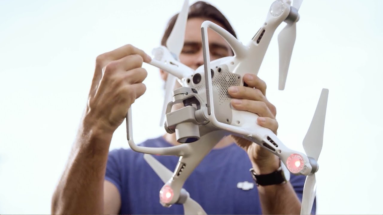

Try the following, then do another IMU calibration and see if the results are any better
The weird thing is that option to calibrate the compass does not appear on my app ???
Found this on a “how to calibrate” site
Hope it may help… Colin
Yes thanks, I now now where to look :grinning:
Let us know if that cures things @pete.mcarthur ?
I’ll keep you up to date but the weather is looking a bit dodgy for the next few days. As you as I can get a window I’ll give it a go
Well I am both very happy and feel very stupid at the same time! The main problem seems to have been the compass calibration and once I found out how to do it, we’re looking good.

The original issue here was a simple compass calibration was needed, this was causing the yaw issues.
