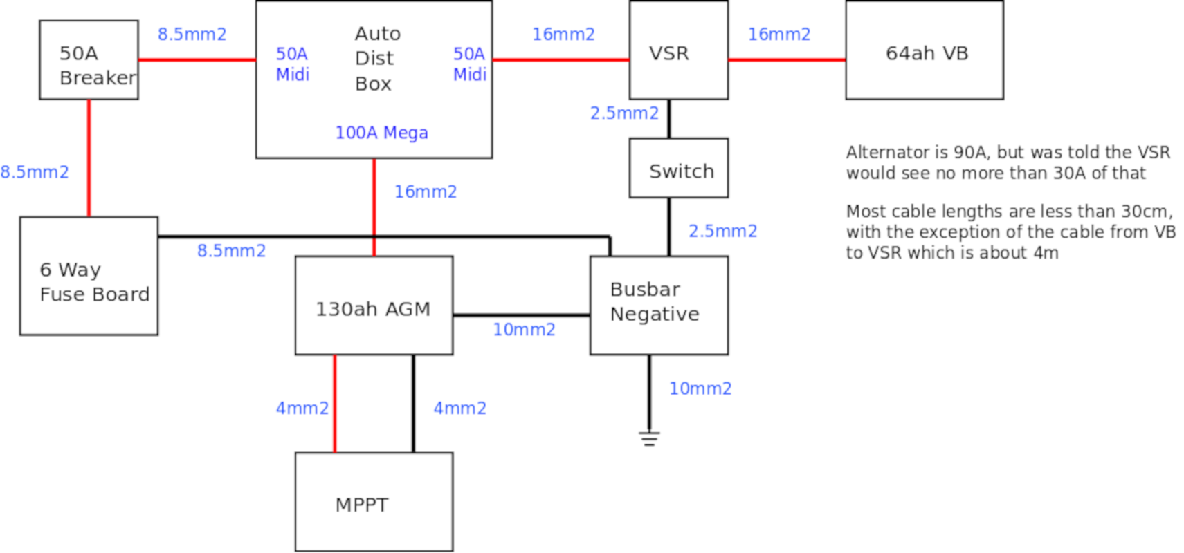

This is what I use in my van. Basically when you start the engine and it detects the voltage going to your vehicle battery is over 13V it connects the two batteries together and allows the Leisure Battery to be charged from the alternator.
If you have a Lithium / LiFePO4 Leisure Battery, you have to use DC DC Charging.
An example wiring diagram. The one I use on my van. Ignore all the bits except for the AGM battery, distribution box, VSR and VB, plus the wire sizes and fuse sizes.

Whether you have a Charger or VSR, place a cut off / isolation switch or circuit breaker inline before it. On my VSR I put a switch on the negative cable. With a flick of the switch the VSR no longer works. On a Charger, put a 20A or 40A isolator or circuit breaker between it and the VB. Either way, isolate the circuit and remove the battery when you don’t need it.
Mine is a mini motorhome, so i have it permanently installed, but on a car you can make it more modular.
