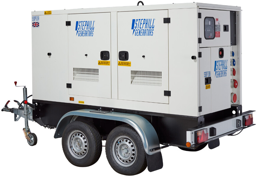

Otherwise …
Yours for £4,321.20!
https://www.sgs-engineering.com/stephill-016-2018-highway-trailer-for-ssdp120a-generators-ball-hitch
Oh - may have overlooked the “portable” criteria. :rofl:
Knowing me, and the missus will tell yer, I’d of ended up with something like that. A substation on wheels :rofl::rofl:. I’ve used stuff like that when doing site work.
It still meets the portable criteria, just on a larger scale👍.
