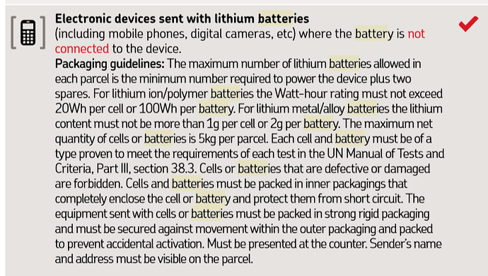

Found this on Royal Mail website for info:
Batteries not connected to or posted with the device it is intended to power
Batteries that are classified as dangerous goods and certain used batteries (including wet spillable lead acid/lead alkaline batteries (such as car batteries), used alkaline metal, nickel metal hydride (NiMH), nickel cadmium (NiCd), zinc-air batteries, solo lithium batteries, power banks and damaged batteries of any type)
  • International - Not allowed in the mail
  • UK - Not allowed in the mail
Batteries, specifically new and used lithium batteries when not sent with or connected to an electronic device (including power banks)
Batteries, specifically new alkaline metal, nickel metal hydride (NiMH), nickel cadmium (NiCd), zinc-air and zinc chloride Including D, C, 9V, AA, AAA and AAAA alkaline batteries.
  • UK & International - Allowed in the mail, with restrictions and packaging guidelines below:
    • Must be new and sent unopened in their original retail packaging.
    • Surround with cushioning material e.g. bubble wrap.
    • The sender’s name and return address must be clearly visible on the outer packaging.
Batteries - new wet, non-spillable (e.g. sealed lead acid batteries, absorbed glass mat and gel cell batteries)
  • UK - Allowed in the mail, with restrictions and packaging guidelines below:
    • Batteries must comply with Special Provision 238 of the UN Recommendations on the Transport of Dangerous Goods, Model Regulations (please check with the manufacturer or distributor).
    • No more than one battery in any one parcel.
    • Maximum weight 1.5kg.
    • Item must be protected against short circuit (by insulation of exposed terminals) and securely packaged.
    • Package must be marked. “NOT RESTRICTED” and “SPA67 / SP238”.
Royal Mail shouldn’t be a problem … for three, total.
MP batteries are only 43.6Wh.
Total less than 5kg weight.
That document is from here.

Send them Chris.
The issue you will have is the same as me, when you get to the Post Office counter.
Don’t ask for advice, just advise them they are packaged correctly and within the allowable limits.
They will put a special hazard warning label on the package, but definitely declare the parcel has batteries within it.
