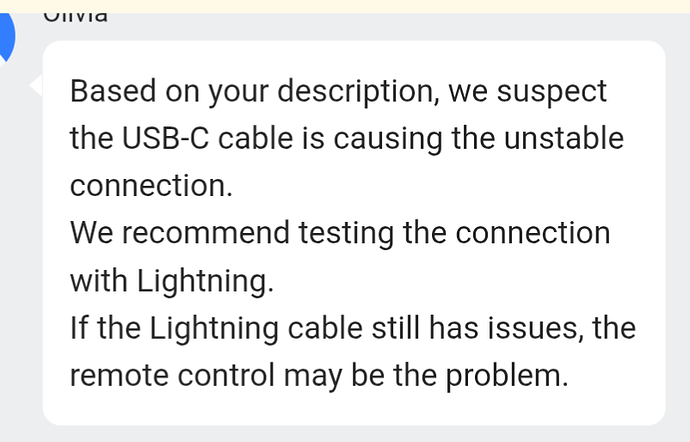

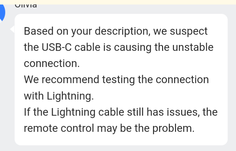

Potensic asked me to try the other data cable they provide with it. I have a Pixel phone, the other cable is a lightning :frowning:
Update - now they’ve asked me to borrow an iPhone. I don’t actually know anyone close enough that has one, round trip to Manchester for the nearest. Finally convinced them to send a replacement USB-C.
New cable coming from China, UK warehouse has none in stock.

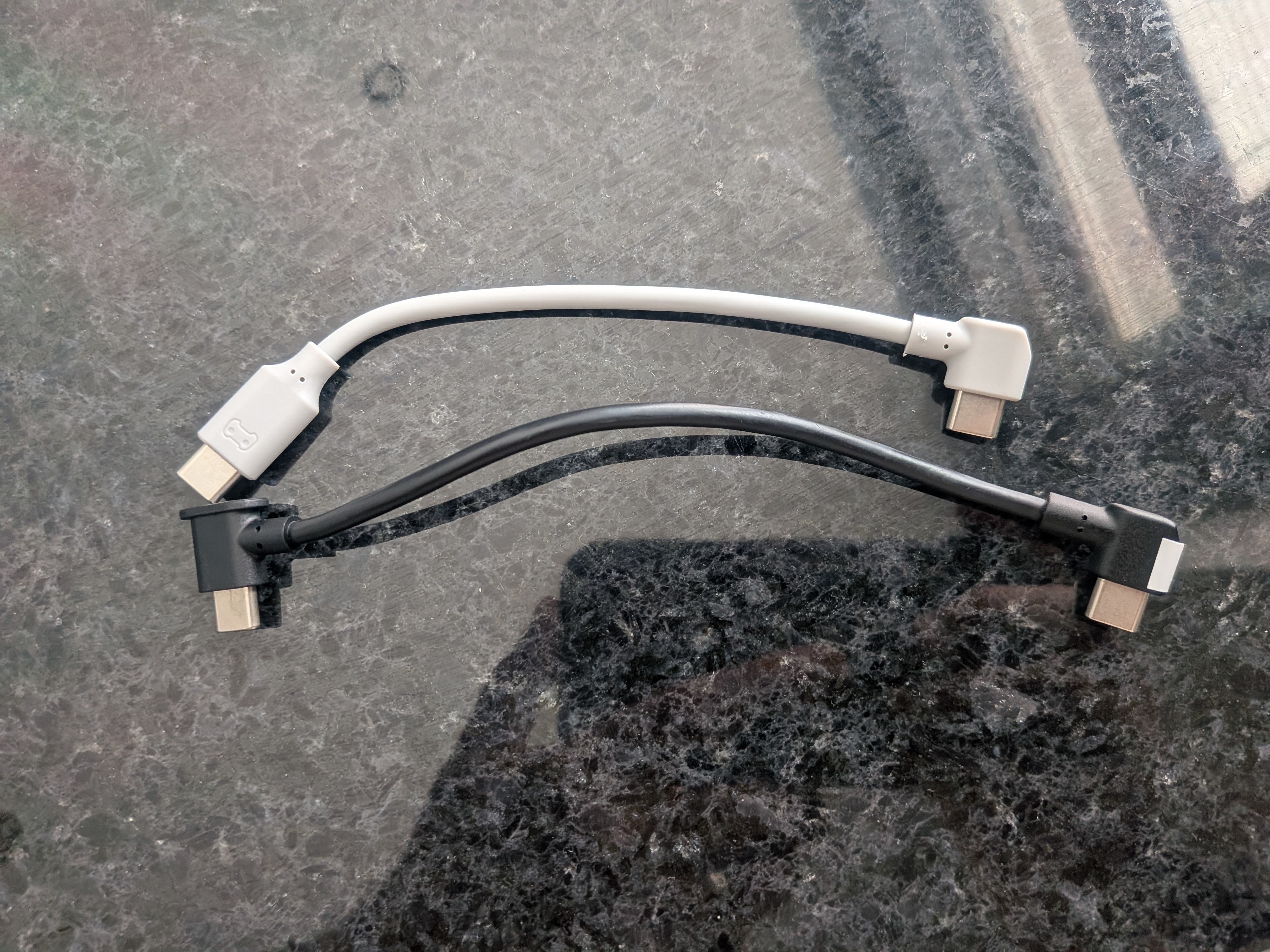

New cable has arrived, clearly not meant for my drone & controller :face_with_symbols_on_mouth:

I need the USB C to C cable which technically they sent but they sent me a pack of Atom SE cables which are shorter made worse by one end being a straight, not right-angled, connector. At least I got a full set of 3 wrong cables, C, lightning and micro :rofl:

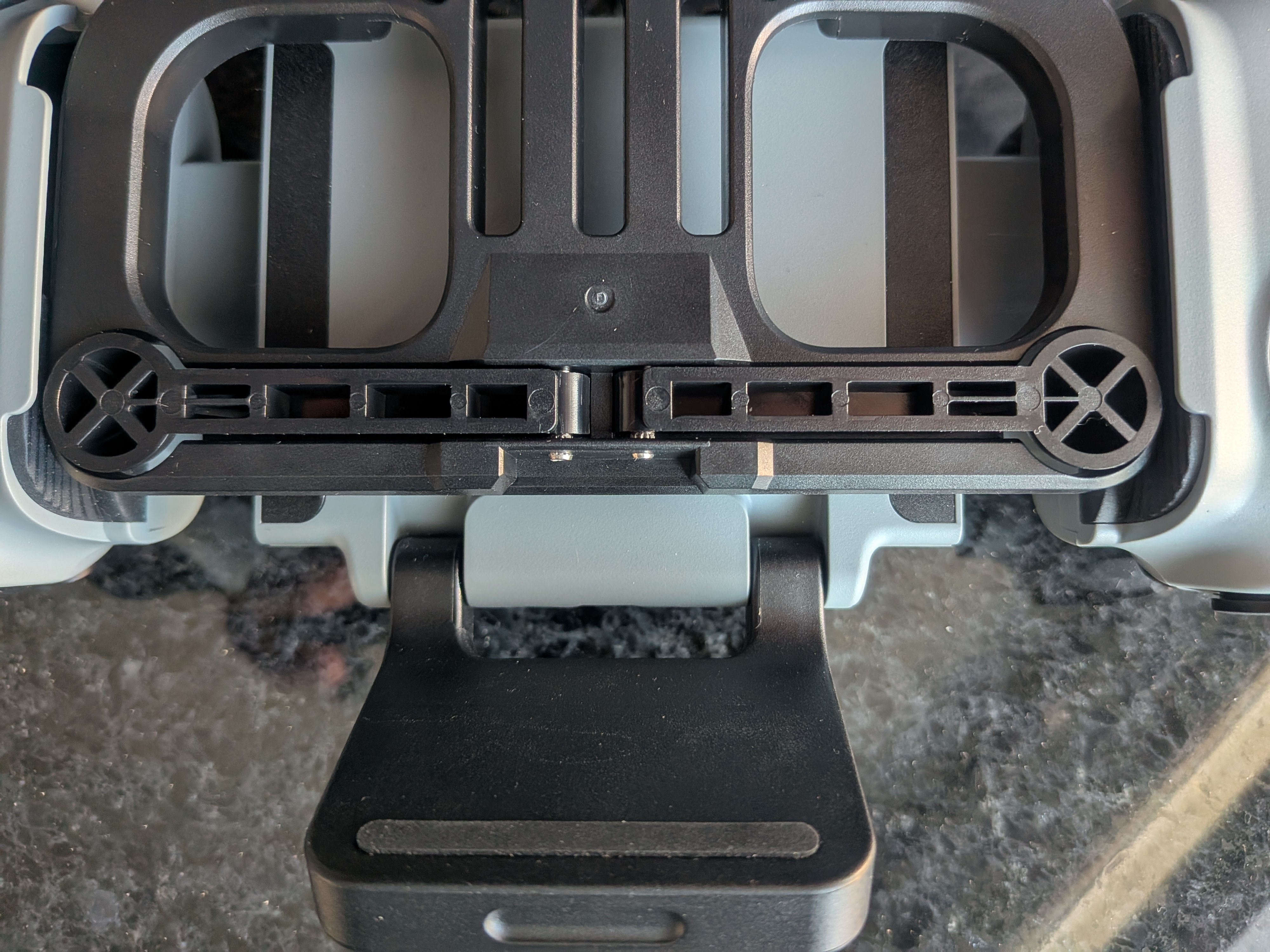

I’ve had 3 cables, all failed at some point but I’ve not had a problem for a while. When I put the phone in the controller, I have it seated further towards me and the cable sits in the phone nicely in the gap to the right. I use the black markers on the controller to guage where to place it. The cable must be in the gap on the right and feed out of the hole.
I’ve just bought a widget to mount the pione above the controller, not tried it yet but it’s handy to show you how far towards the aerial I have my phone.
