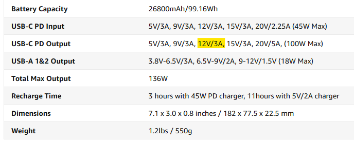

Ideally, for fast charging, you will need the Mini 3 battery in the Hub (36w Max) a USB-c power delivery PD power bank that outputs 12 volts (12v 3amp), then you can charge at 36 watts
Something like this
https://www.amazon.co.uk/26800mAh-Portable-Charger-Charging【Quick-Delivery】External/dp/B08DNCLSZN?th=1
