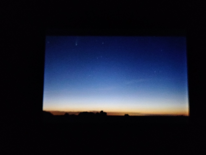

I use a biggie on my Pansonic G9 for 5 hour time-lapses, impossible with the default battery. And at the end … the camera’s battery is also fully charged for whatever is next. :+1:
I use an Anker 20100 mah power bank. Been an excellent piece of kit. Still going strong after three years. Get around 5 full charges of an iPhone 8plus.
Which is where I am right now … and guess what I forgot to recharge!
Not sure how far through this comet time-lapse I’ll get.
(A bit fuzzy on the phone photo of G9 screen because the review is only visible for 1 sec to check exposure … and save camera battery. :man_facepalming: )

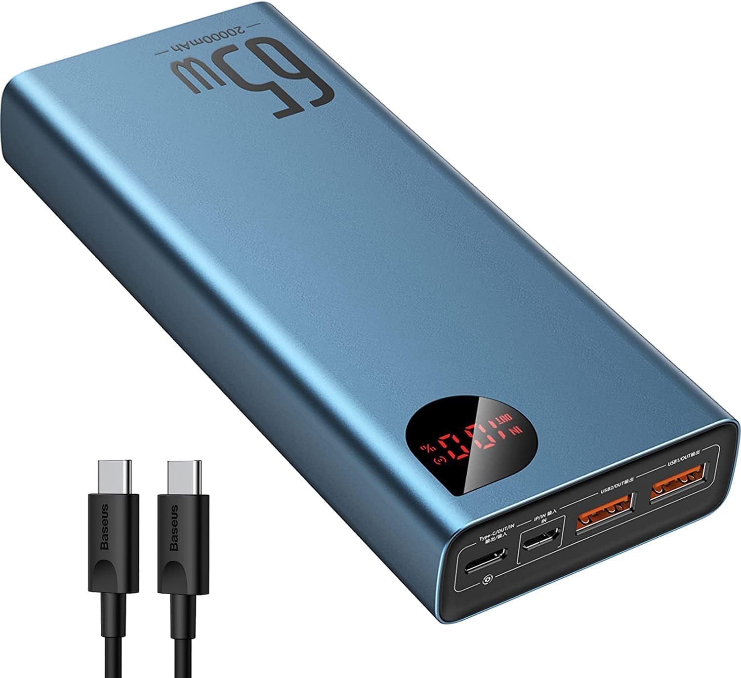

I have a Baseus Power Bank, Portable Charger 30000mAh under £25 i haven’t used it for the Mini 2 batteries yet but i have charged 6 go pro batteries from dead to full and it was still over 50% full
