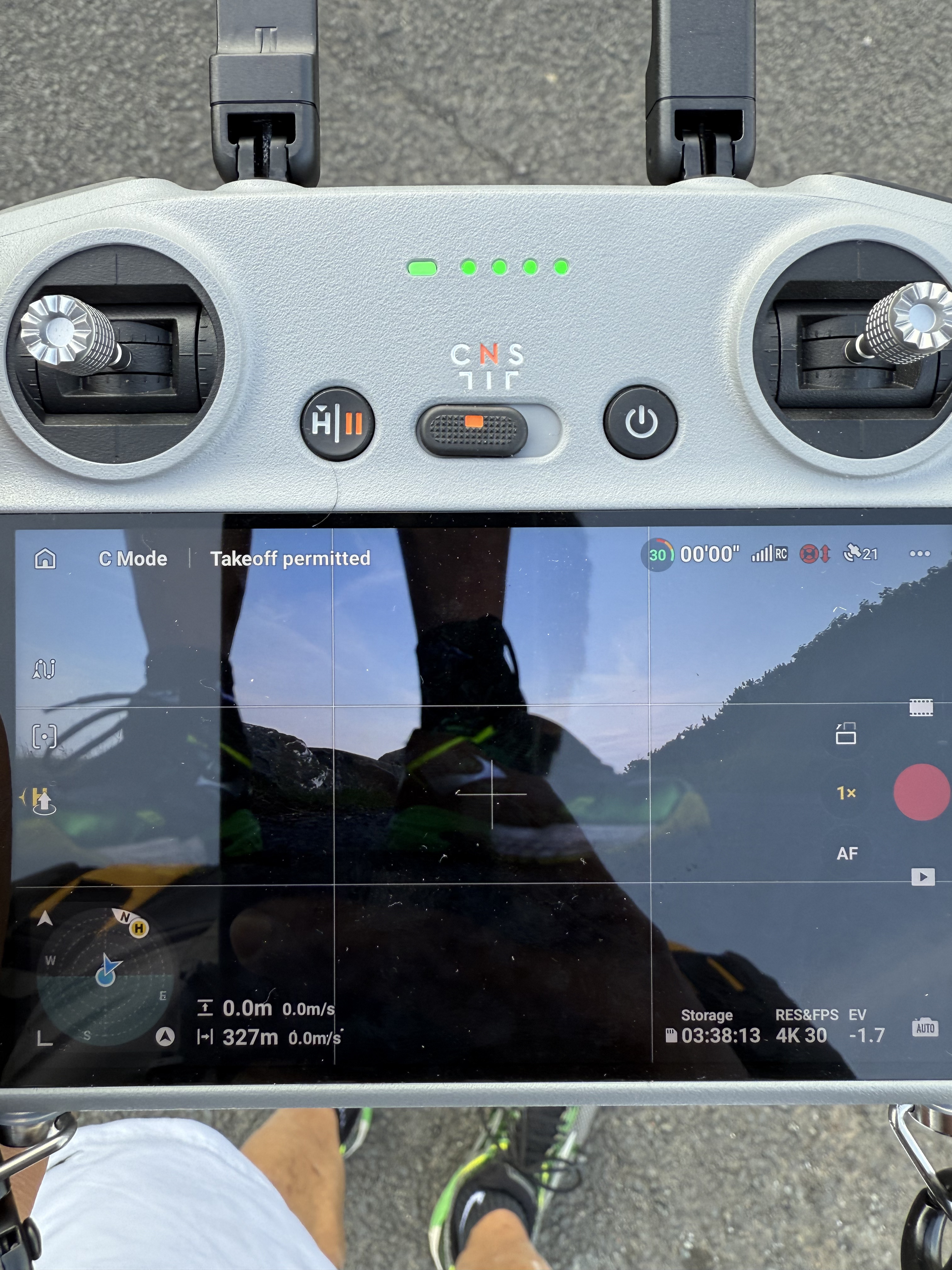

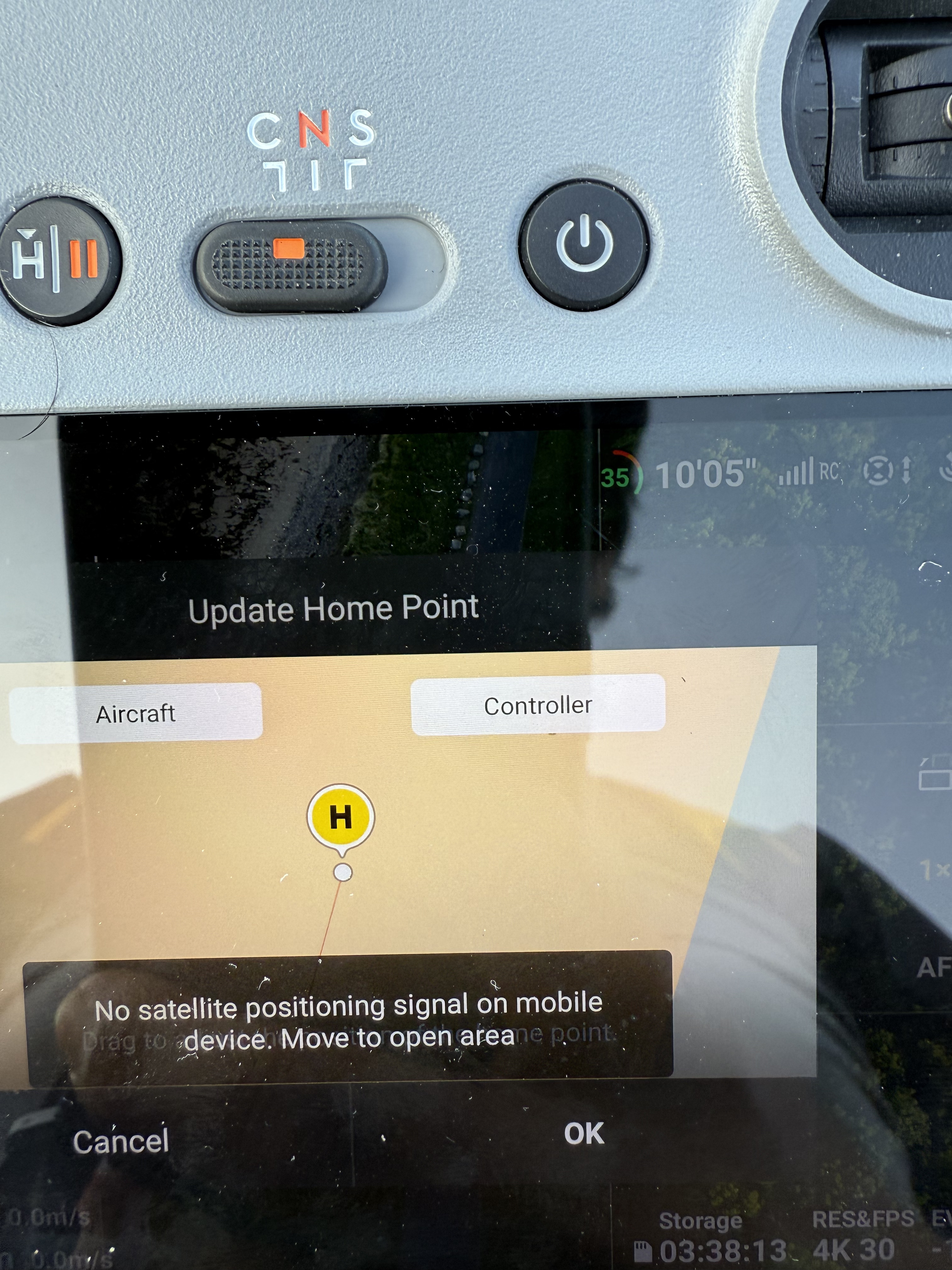

This has happened twice now. I am flying by the sea in Northumberland. I wait until there is a GPS lock, and the home point has been updated. I start flying and everything seems normal. Then, because I have moved while flying, I try to update the home point to where the controller is, and I get this message: “No satellite positioning signal on mobile device. Move to open area”. Both times I fly it back manually, but when I have done, the distance marker on the bottom of the screen still thinks it is 327m away from the controller. (See attached screenshots). The number of satellites did not go down, as far as I can remember, and I had no warning about GPS loss or anything. What am I doing wrong?

Seems like a problem with the latest RC 2 FW update & or the app then.
Yep it’s a known issue affecting some but not everyone.
I have had the issues pictured since updating to most recent Fly app FW on the RC2.
Hopefully DJI will launch a FW update soon to fix this.
I don’t usually change RTH location when I fly but would be nice if the issue got corrected.
No I don’t use it either, but when I did as mentioned above is probably the first time I have ever in the 4 years ish of owning / flying drone.
The latest RC2 update fixes it.
Ooh thanks. Just done the update but haven’t had the chance to test it out yet.
I think it has to do with the latest dji update 1.17.1 I think, the previous update 1.17.0 was ok and corrected for change of RTH position, I contacted dji, without a lot of success, but think it need a further update to correct this issue. There are a couple of utubers have mentioned this recently, worth a checkout
It’s mentioned just two posts ago that ..
:+1:
Didn’t fix it for me. A recent Air 3S firmware update did. 01.00.0140.
Checked it tonight for first time and the drone did RTH to new homepoint. Still amazed at how quickly it picks up GPS lock now.
