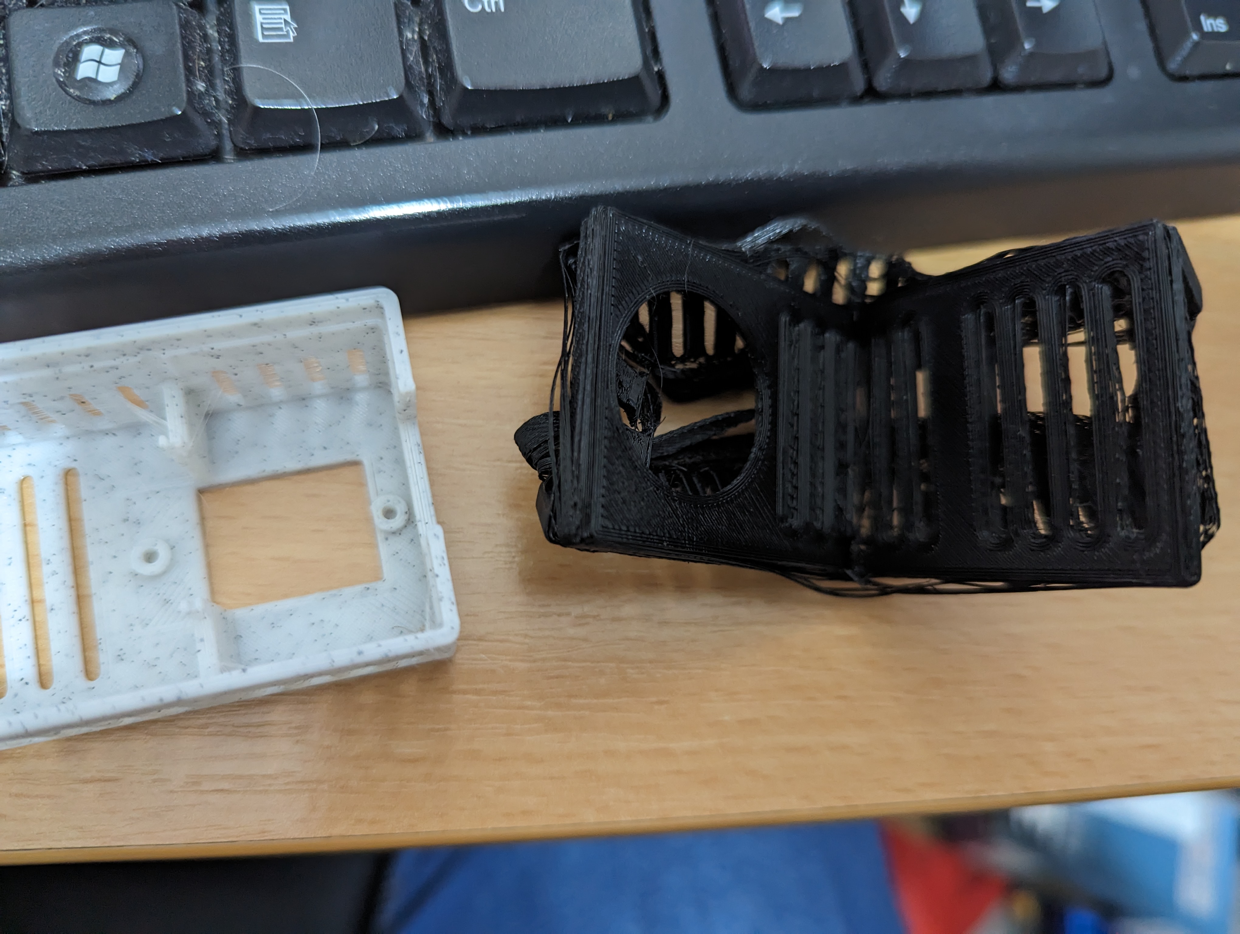

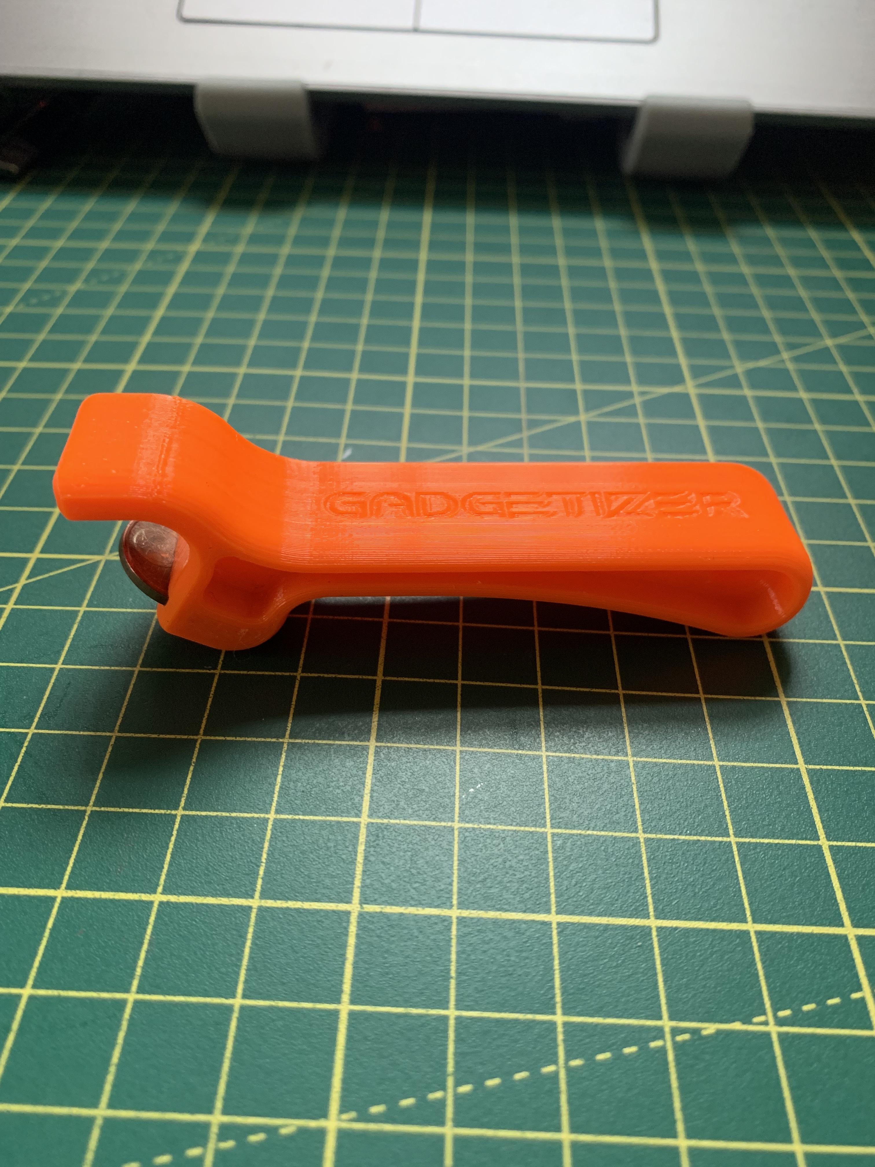

I am having serious issues with warping on anything > about 1.6mm thick but only when using orange filament. The same item prints without any problems when using Sunlu Grey or Black filament using the same profile WTF! Even the sh1tty Dremel filament I was gifted works fine.
the filament is definitely dry, but not hot (e-sun dryer level 1)
room temp is the same
there are no draughts around the printer
I increased the bed temp and reduced the filament temp with very little impact.
Has anyone seen this before, and do you have any views on a solution? I really don’t want to bin a new roll, only to buy another with the same problems.

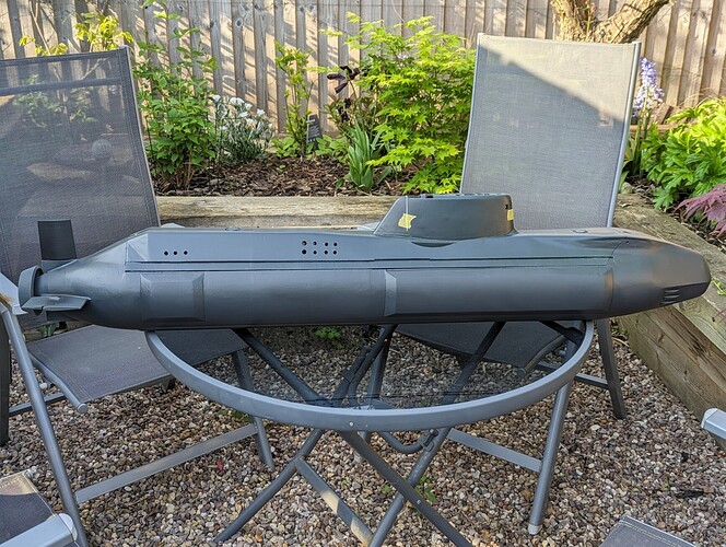

I do a fair bit of printing, this is PETG in 7 sections and nearly 1.5m LOA. I had to change material halfway through to a different colour (from the same manufacturer) and had to redo esteps after a dismal failure of one section.

it is primarily typical warping on the base (typical of filament cooing too quickly) hence bumping up the bed temp and reducing the filament temp (initial post) and checking for draughts
The same gcode file works fine for grey & black Sunlu, but warps for the Orange
I tweaked the temp in the gcode file and also re-sliced with the temp tweaks and got the same result.
