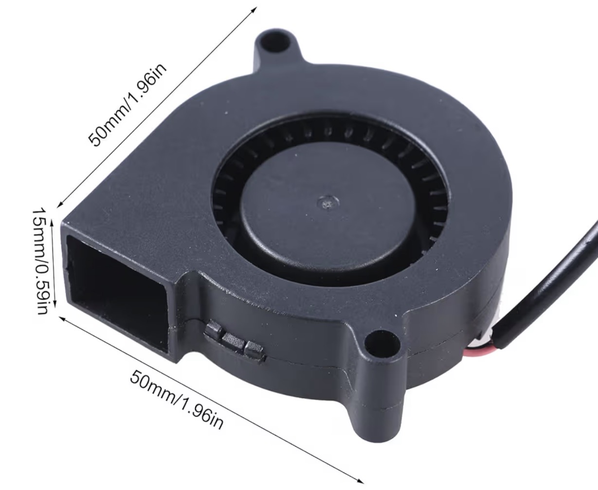

The O4 lite’s do over heat quickly when I’m tinkering with the drone settings (beta flight) at the computer at home, however I have a small USB powered computer fan, which prevents it.
Similar to this -
