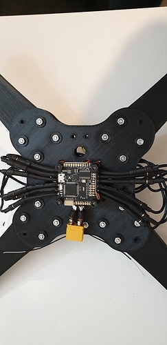

@notveryprettyboy sure,
It’s about 420mm frame that i came up with in fusion 360. I originally was going to use dji f450 frame but it doesn’t fit in the case i bought for it. Also, i enjoy more building stuff than buying it ready.
I am using:
dalrc F405 with dalrc engine 40A
GARTT ML2212S 920kv motors
4s2p battery built from 18650 batteries.
I have also gps, gopro, vtx and gimbal waiting to be installed once i confirm it’s flying properly.
As for how it’s flying i don’t know yet i’ve done some small test at home before going to the field.

Current weight with batteries is 1100g and lifts off at just below 50% throttle.
Wow. I have loads of 18650 batteries. Don’t the power wires get hot? I thought about it but worried I wouldn’t get the current from the cells.
What filament did you use?
I am using Samsung 30q rated at 20A discharge. In parallel, they should provide 40A enough for the motors. It’s not meant to be a racing quad but more like camera quad.
All the wires in the built are supporting the current required. I haven’t tested in a long flight as i am not very good at flying yet…
This frame is printed in PLA, i was going to use PETG originally but it strings too much regardless of how much you play with it and it’s just not worth. We will see how the PLA goes but the first try on PLA was pretty good when i printed the Spyda 500 frame. I crashed it in 10 seconds though
Nice. My 18650’s are stripped from laptop batteries. Not the best and they take a while to balance. I will construct a field charger I think.
My drone was pla. Found it far too brittle though. It was fine on a normal landing. But my arms were too flexible. Trying to tune the pids were a tough job.
