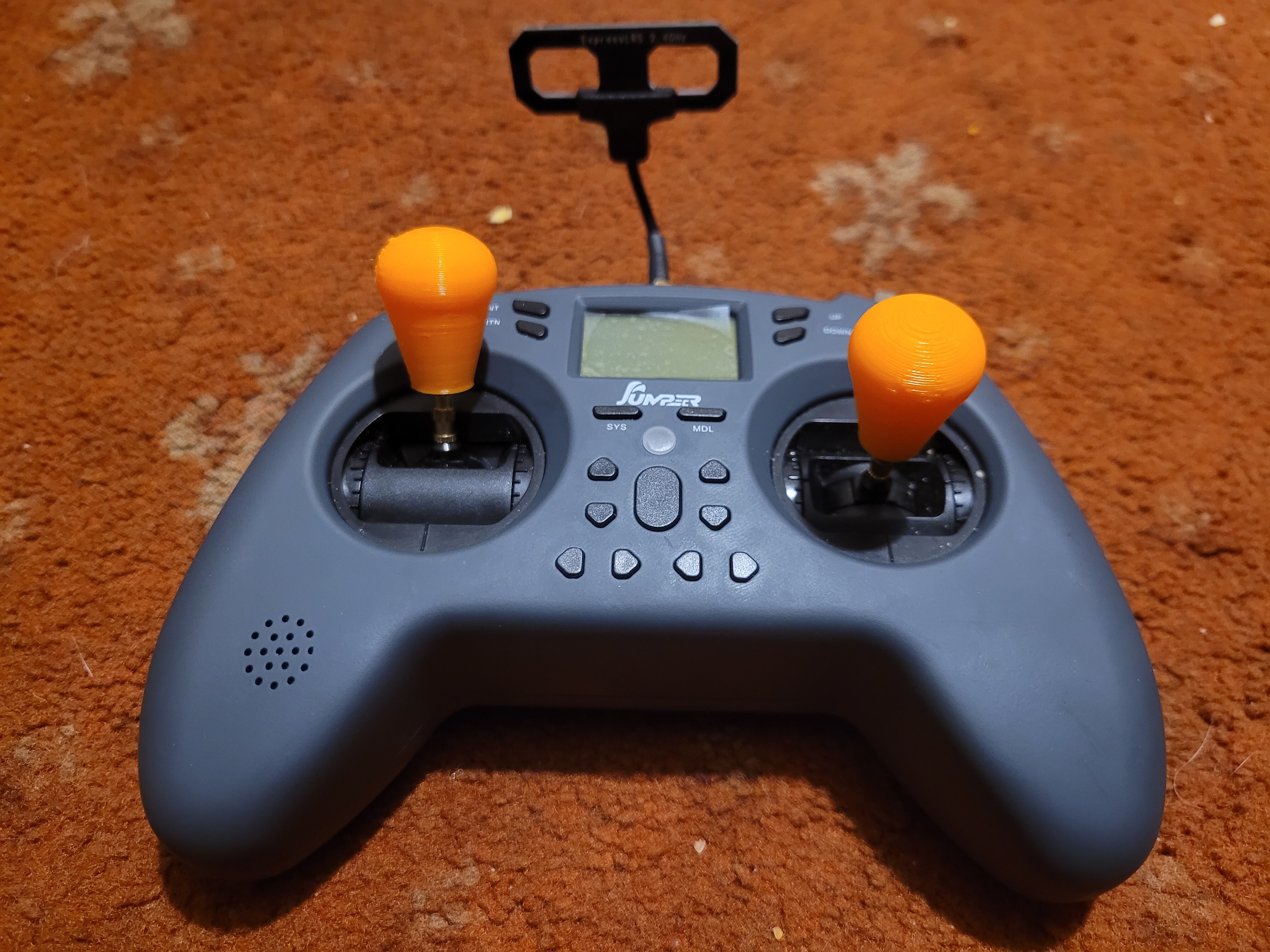

I also have this controller, actually easy to setup.
Pros: cheap, elrs, gamepad style. Works as usb joystick and bluetooth
Cons: need to adjust trim on every power up (is this usual?). Sticks are short … Solve by adding 3d printed sticks. No each strap hook.
Never had this issue.
I added a 3d printed one.

I tried to make one (3d printed) but the screw in was porblematic - could I plagiarise your model ?
This one. Printed in TPU.
I never liked the look of the jumper t pro. I much prefer the metal toggle switches of the lite to the plastic buttons on the t pro.
Ta. My Google skills need polishing
Never thought of attaching it that way.
Playing with stick height at the moment
