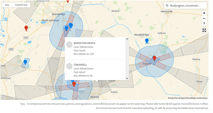

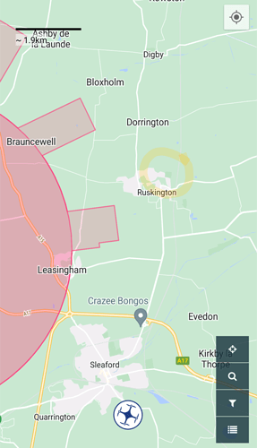

Circled area, and RAF Cranwell, to the west of the marked area have said it’s within their airspace?

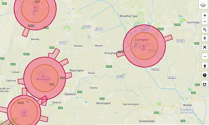

Your fine to fly there. Basically just make a flight plan on Dronescene and off you go :+1:
Courtesy call can be made but they can’t stop you from flying there
No restrictions other than DJI’s self-imposed altitude limits :scream:
You can fly there but your height will be limited by DJI :scream:
No unlock needed
The contact details are on Dronescene, send them an email with this information on or just go and fly

You’re not within their FRZ, so just fly. Give them a call if you want out of curtosy. It may say on their website what their times of operation are, if it does, just avoid these for any close calls if they fly low.

The area you intend to fly in is CLASS D airspace, and while technically it is RAF Cranwell’s airspace, as a drone user you are free to fly with no restrictions. You shouldn’t need to have the area unlocked by DJI, but we’re talking DJI here so don’t hold me to that.
The only DJI lock is 150m altitude which is within the legal ceiling anyway so all good.
