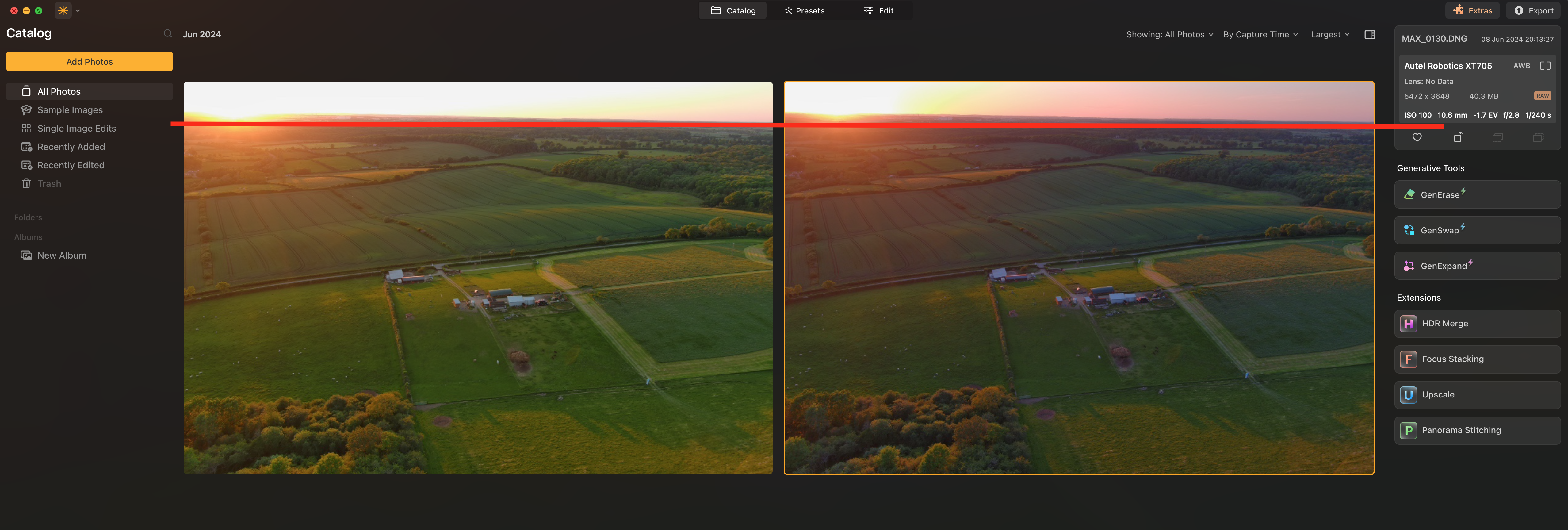

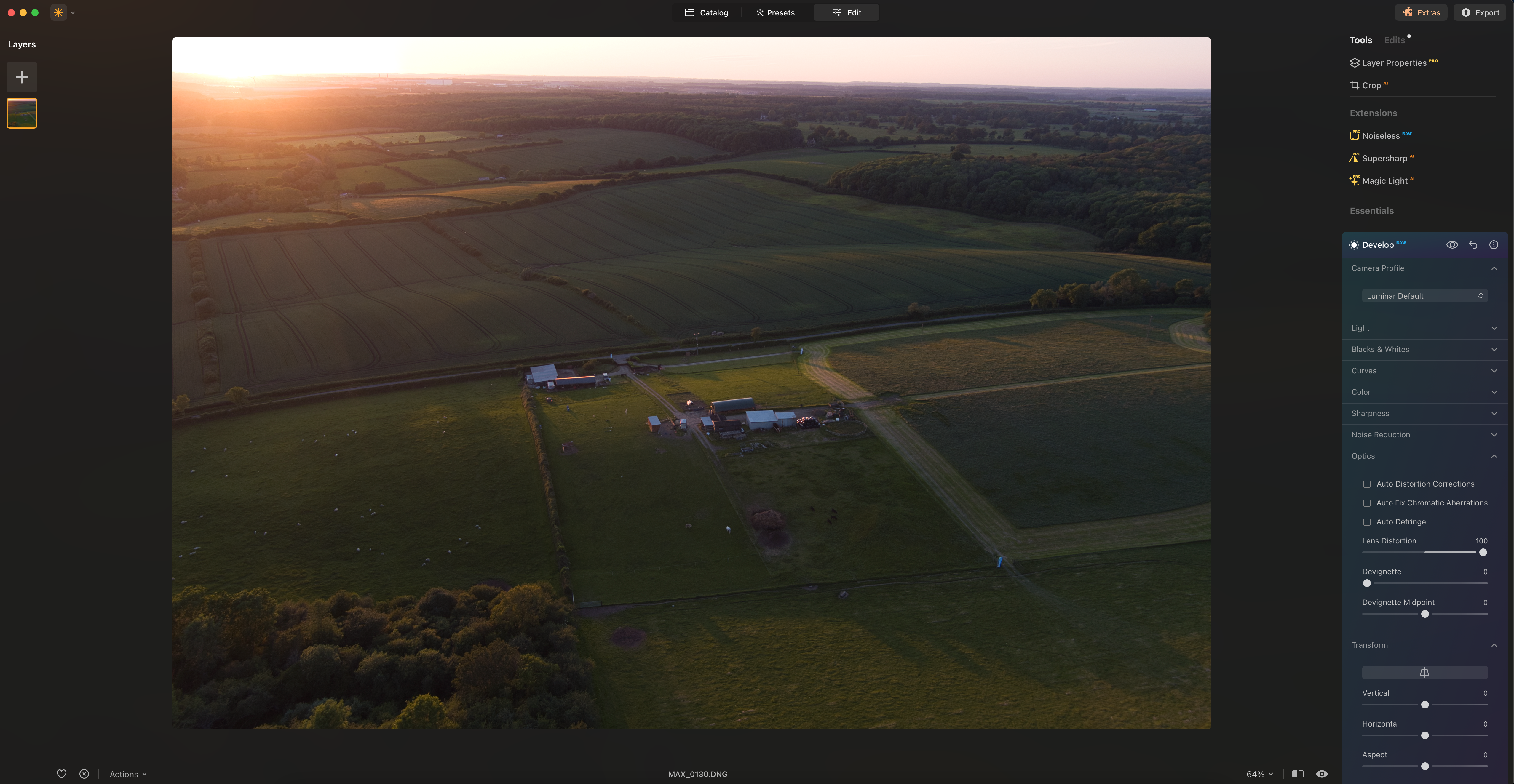

When I import some RAW photos to the catalog, they appear in the preview section just fine:
Note the red line I’ve drawn roughly over the horizon on that screen shot

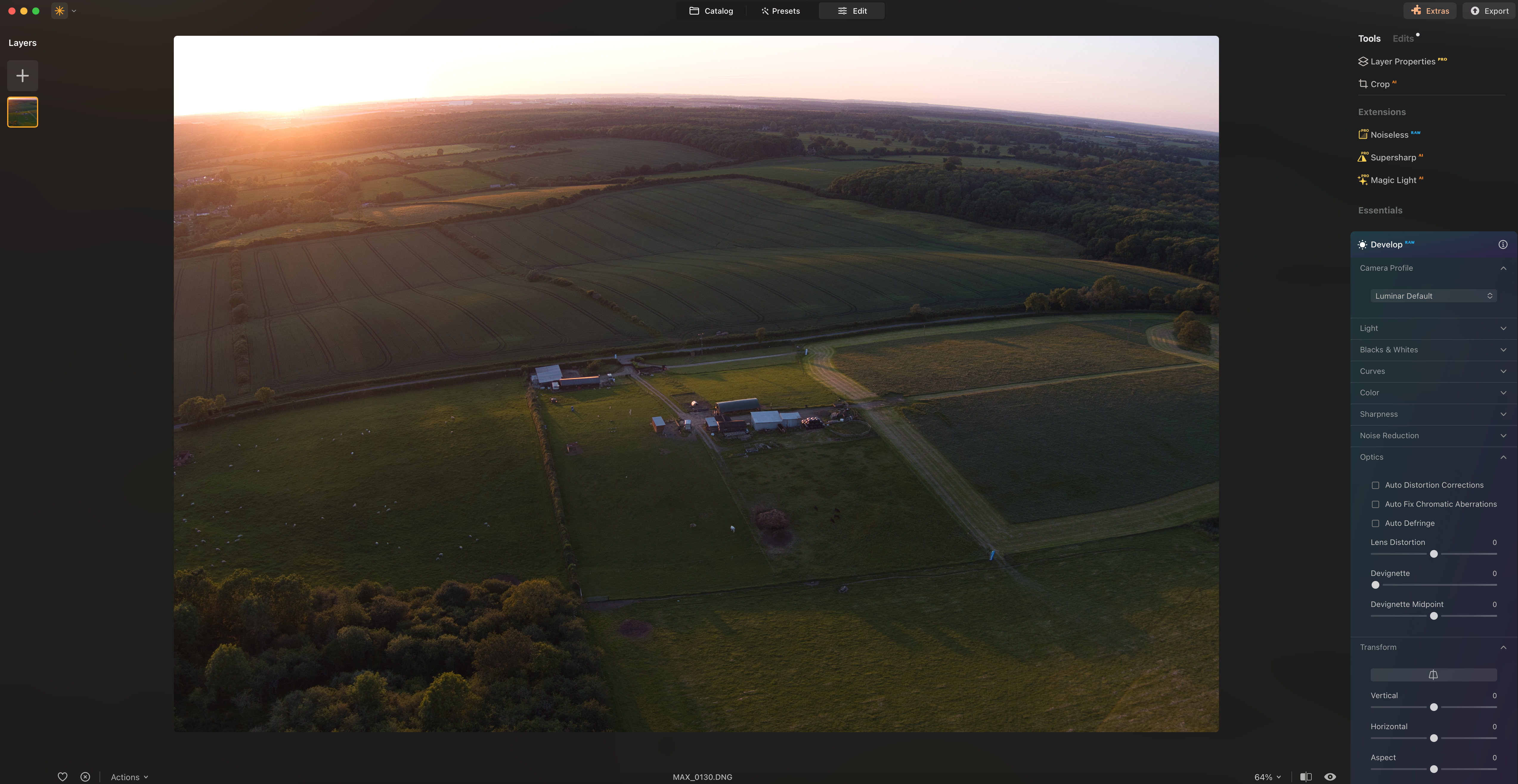

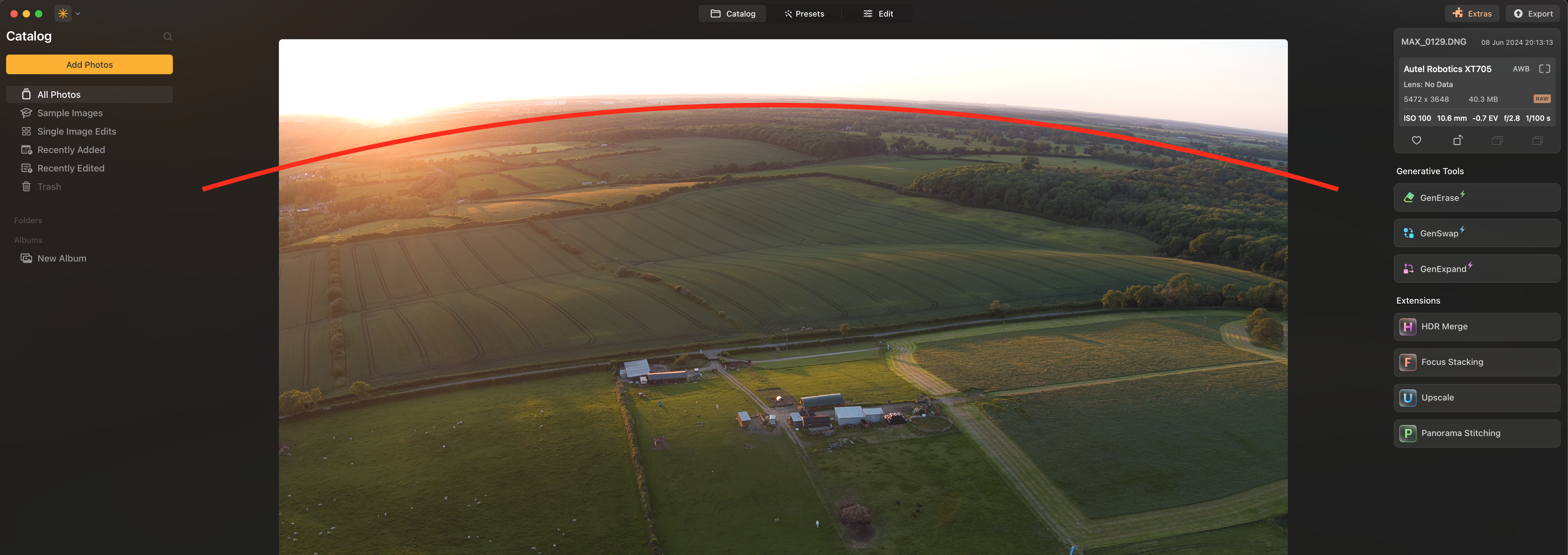

The moment I click on one of the photos to open it, it displays fine for about half a second, then the colour instantly changes and some kind of curve or fisheye effect is instantly applied.
Note the red line here:
It does this without me even clicking on anything, I simply open the photo and it warps it instantly.
Normal JPGs open fine, without being warped. This only happens on RAW photos. I tried some from both Autel and DJI in case it was something unique to Autel, but it’s doing it on any .dng
file that I open.
Is there a random default setting or something that I need to turn off?

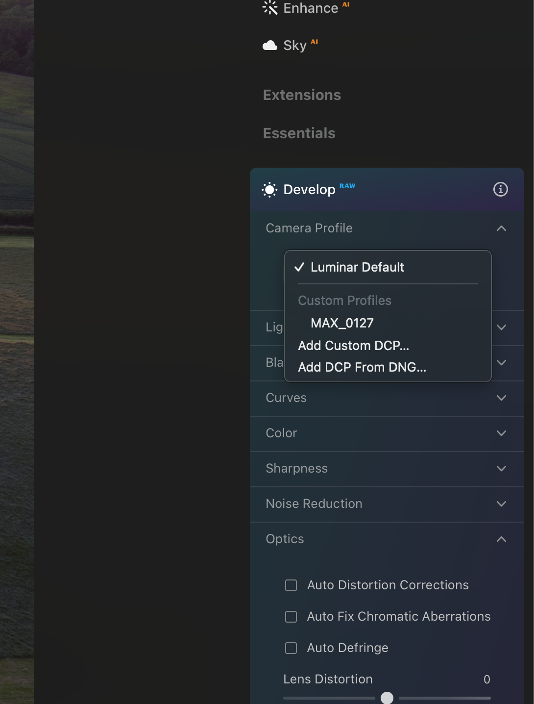

You need to apply lens correction.
I still use Luminar 4 and there is an option for automatic or you can correct manually.
Not used Neo so unsure where you would find it.
Cheers mate, will see what I can find!
Also the preview thumbnails are the stored JPG within the RAW but when you click edit it reverts back to the raw un edited version hence the visual change.
As @callum said you need to re apply the lens correction its under the deveolp section in the tools menu towards the bottom called optics
Cheers guys, I think this is it.

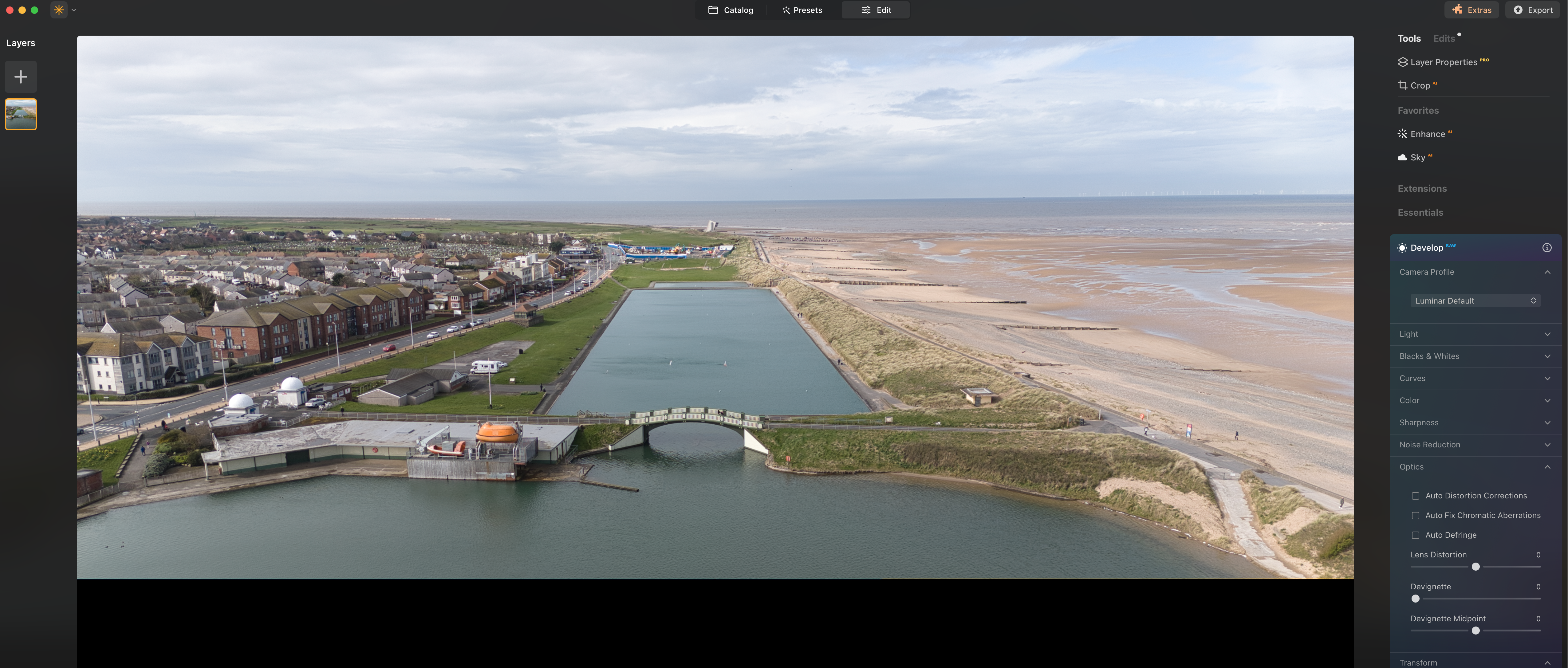

Before:
And after, with 100% distortion applied:

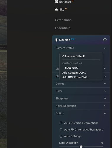

Any way to change the "Luminar Default"s camera profile?
Can you export a Custom DCP, that I could then import?
I’ll have a look when I get home later(I’mat work at the moment) But I don’t see why not. you can create custom presets for pretty much everything so shouldn’t be an issue.
Hmm, I’ve got options to import a DCP but can’t see a way to create one.
No rush Deano mate, ta.
The dng should contain the camera profile.
From memory, lightroom automatically applies it.
Have you tried adding DCP from DNG?
Yeah I tried adding a DCP from various DNGs: autel, 2x dji, and also from Deano’s DNG but none seemed to make any difference, I still had to set the lens distortion to 100% manually
