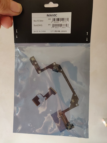

I found another forum the other day and found this video and a link to buy the replacement part for the USB charging port on the left of the controller, its in the USA and costs about £18 plus £10 for postage, didn’t think it was too expensive. I thought it might be useful as I remember a while ago someone was having trouble with it.

The board can be bought from the UK eBay for £16.27… saving quite a bit.
There are (currently) a few options for UK purchase …
I Googled “dji mavic pro RC button board” and found them easily enough.

Edit: Part ordered! :wink:

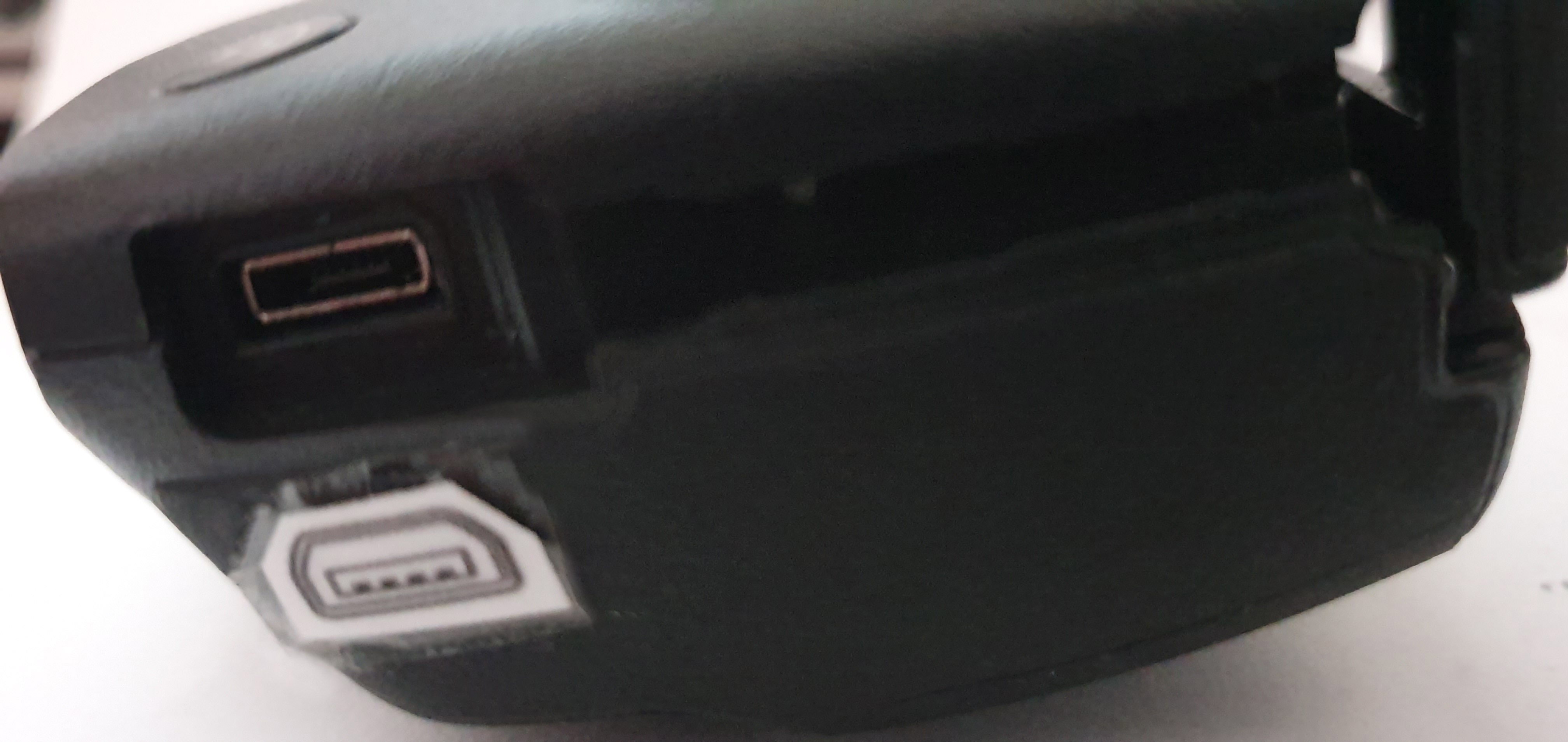

I think the problem is caused by the fact that the port is rectangular and not the shape of a standard micro USB port, this allows you to attempt to plug in a standard micro USB cable in both ways round, it will fit perfectly the right way round or if you force it in the wrong way round you will break the connector tab in the port.

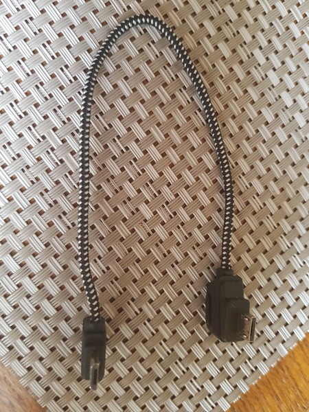

This is my charging cable which you can see has a rectangular plug (DJI plug), very similar to an original DJI control cable, with a standard USB A on the other end.
And this shows the rectangular DJI plug, which could also be plugged in the wrong way round, but due to fact it looks like an original DJI plug it is obvious which way to plug it in.

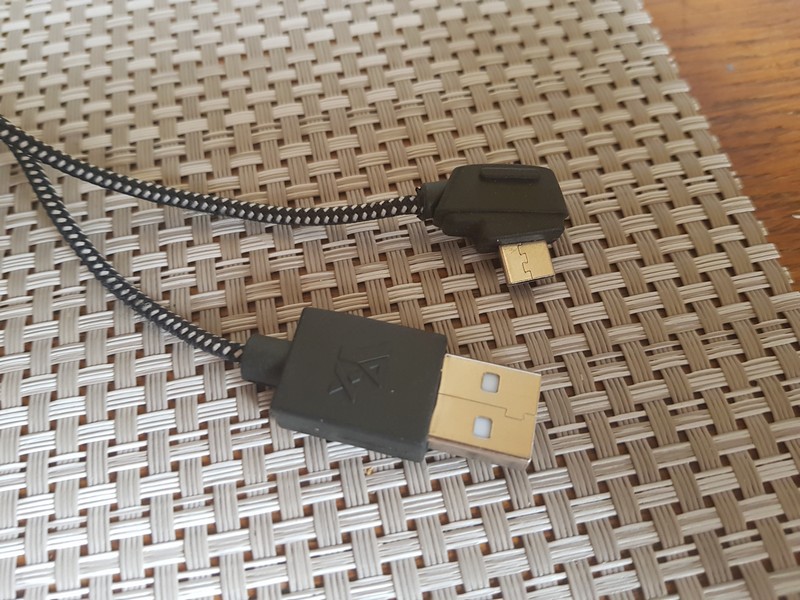

This is my control cable which has a DJI plug on one end and a standard micro USB plug on the other, the next photo is a close up of the two plugs

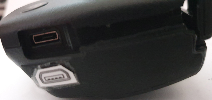

I just stuck a little picture of which way up the USB goes in. Might last a bit longer.

Hi guys, I have magnetic cables for other things, my issue is I use the charging port for connecting my CrystalSky, it keeps everything neat and tidy. you can see from the photos above the plugs are the same shape as the original DJI cables, so it is obvious which way round they go.
My “Bottons” have arrived! :+1:
