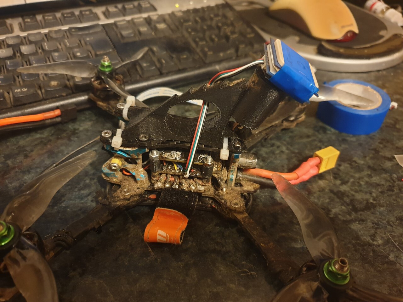

RF shielding tips wanted for gps

Where abouts have you tried to mount the GPS? Maybe try mounting it to an arm (I know it’s more susceptible to prop strikes) but might be worth a shot just to see if it makes a difference?
I have tried mounting it on the arm, but it kept dropping out.
The best position at the moment is here… as you can see, it would be vulnerable.
I could put the vtx under the fc, but it means I have to clean the mud off. And its a ballache

How about mounting it out the back from the rear standoffs?
I will try this. But the distance I need will be long. Suppose I could make it look like a lizzard tail :laughing:
Isn’t that right on top of the VTX Antenna?
Yep. But the antenna is 5.8ghz. Gps is 1.2 ish? The vtx must be kicking out 1.2 somewhere. Also, the top of the antenna is a null point
