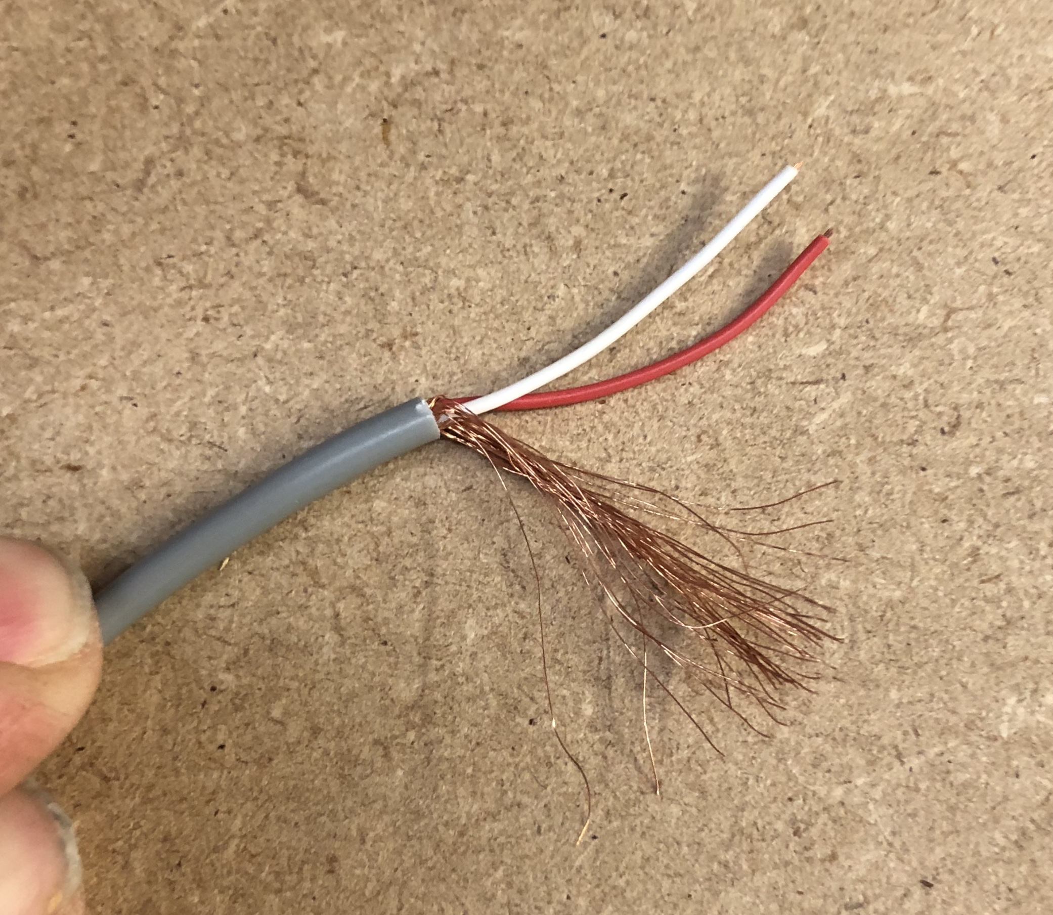

Do you want some of this?
OD is 2.8mm
I have some. In fact I have lots of shielded cable, from earphone wire to usb cables.
