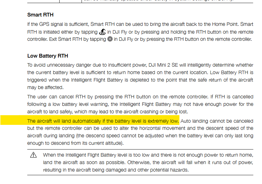

With the landing sensors confused by dark water surface, but I would have thought that RTH would make it descend for a few seconds before the confusion set in and control was lost. There was no descent, I’d been hovering and the drone had just started to move forward as I’d expect under RTH control, then it made like a brick.
RTH will invoke different behaviour depending on the exact %age left in the battery
If it was reporting critical battery level, it would immediately try and land.
AIUI, and of course I could be wrong, the drone is supposed to go into RTH automatically when the intelligent battery decides it needs to go home, based on the height and distance from the home point; that is not what happened yesterday evening!

Going fwd, the learned advice on when to RTH is to do so with no less than 20% battery life left so that
a. You have enough battery life for emergency manoeuvres.
b. To protect the life and longevity of the battery.

Not good - old news now following the responses you received below, but hopefully you’ve got a better understanding of RTH/battery management/reduced visibility flying. Any of those in isolation carries risk if you’re not too familiar with behaviour, but put all three together and you’ll likely get a bad outcome. Enjoy the new drone👍
