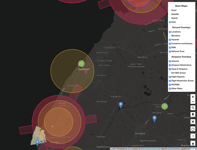

There are a few airspace restrictions near Southport that you need to be mindful of:
And the whole of Sefton beach is covered by an SSSI that you should look in to as well:
Is there something more specific you need an answer to what we can help with?
So far as I can see, you have pretty much the run of the skies over most of Southport, though there is a Red FRZ for the RAF base at Woodvale which overlays the southern part of the town. You can fly in/over all the yellow areas on the Drone Scene map, they are there to advise you of hazards that you need to be aware of, and there are no restrictions preventing you from flying over them. Over 100’ or so most of the hazards are not going to bother you anyway. The yellow areas include sensitive locatations like schools or hospitals where there may be privacy issues. as well as obvious hazards like railways or busy roads.
And SSSIs. SSSIs are there for various reasons, and where the reason is a specific landscape, rare plant, or a geological feature your drone is not going to be an issue (but don’t step on the rare plant). Wildlife SSSIs need a bit more interpretation, with nesting birds particularly vulnerable to being buzzed by low-flying drones, and requiring consideration and common sense. An oft-repeated rule here is ‘don’t be a dick’, which is the thrust of the CAA’s ‘Drone Code’. Keep to it and you’ll be fine in most places, including Southport!
When you open a drone map covering most urban areas as a novice, the yellow is scary and off-putting, and your initial thought is ‘I can’t legally fly anywhere here, what now?’, but it soon becomes obvious that you can fly over the yellow areas so long as you’re sensible. You probably wouldn’t fly close enough to a railway line to get entangled in the 25kv wiring, or to tresspass on one to retrieve a crashed drone at risk of being splattered by a train, or in proximity to a busy motorway, or over crowded areas, or where you would attract approabation on security or privacy grounds. You might fly over a local recreation ground, but probably not on a Saturday morning when all the football pitches are in use by local leagues and surrounded by parents/spectators. I doubt if Southport beach ever gets crowded, but I’m sure parts of it do on hot summer weekends. Common sense is a pretty good guide to what is legal, and acceptable, flying behaviour.
TOAL issues probably cause more problems to drone pilots than flying issues, and it is your job to find out if permission is required, and if so how to get it, or if you simply cannot use the site for TOAL. Landowners own the land and are perfeclty within their right to prevent you from TOAL on it, but they do not control the airspace above, that’s the CAA’s remit. But you will encounter ‘no drones’ notices, and people who do not understand that the airspace is free to use even when the ground isn’t.
You may even be able to fly in the Woodvale FRZ, with permission from their Air Traffic Control.

Thanks for the reply. That’s super helpful info for an fpv noob.

So after a bit more digging on line, I have discovered it is actually illegal to fly drones on Southport beach ( * unless you have permission from SMBC ) as it is subject to a Public Space Protection Order ( bylaws ). It is also illegal to take glass containers on to the beach and a whole load of other ridiculous rules that look like they were dreamt up by a power mad dinner lady!
clause 28
(28) Bring or permit to be used any remote-controlled vehicle including model aircraft or drone
without the express prior written permission of Sefton Metropolitan Borough Council.
The PSPO runs out in June 2025, but it can be extended and it would be a good time to raise objections to it.
good luck with that, there is no means to challenge a pspo except on the grounds that they did not follow the procedure for implementation, but the content cannot actually be challenged or changed.
