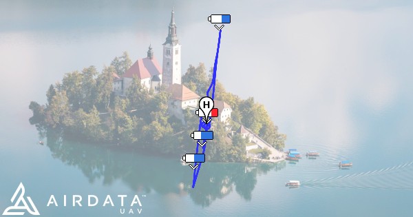

Hi, dont know why im getting this warning on my DJI Mini 2se, when im flying in a totally open area. Also getting, [Downlink data connection lost for 15.4 seconds] seconds before
@Zipco, it would be really useful if you could share the Airdata logs for this issue, it’ll help people provide you with a more detailed answer based on what actually happened.

@Zipco cheers for the AirDAta
I would point you to an answer earlier to today to a similar issue
Looking at the logs you lose connection quite early on in the flight (60M up and 90M away) and your radio signal dips to 60%
Were you pointing the controller in the area of the drone?, one of the issues of flying in
bright conditions is the 'habit of dipping the angle of the controller to flat so you can see the screen instead of the reccomended 45 degress (pointing at the drone), or even turing round to avois sun on the screen
You could try swap the cable out, but I don’t think that is the issue here.
As an experiment, and the location looks nice and open), fly as far out as VLOS allows, pointing the controller at the drone at 45 degress and see how far you can get?
