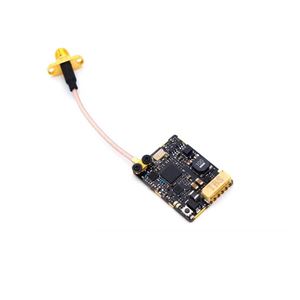

Have HRC got the Rush VTX you want? I can look to see what other similar motors they have at HRC
Umm not looked. Did I want the Rush though… Everyone says the TBS… Lets check,
Doesnt do the VTX… Where did I get the first one from… let me check…
Thats not the 32, only does 800 yeah?
RushFPV Tank Ultimate Plus VTX – Unmanned Tech UK FPV Shop got it from Unmanned, and now out of stock. Hobby RC dont do it

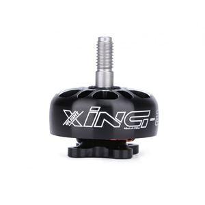

They do have the same motor but in size 2306 at HRC
What does the size mean? i.e. I was going for 2207? whats 2306 mean? Not the mounting holkes then? 16x16?
It’s the stator size (the internal part with all the coils) the 22/23 is the diameter and the 05/06 is the height in mm

Diameter and height. Basically the bigger the more torque. But less responsive. Hint 6s
@SirGunner go 6s man. Bottom end pull out of a dive is instant
