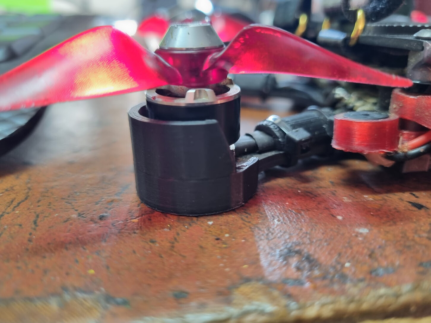

BTW with arm protectors, after bending a motor axle in a collision I have made them tall enough to protect the motor bell as well.

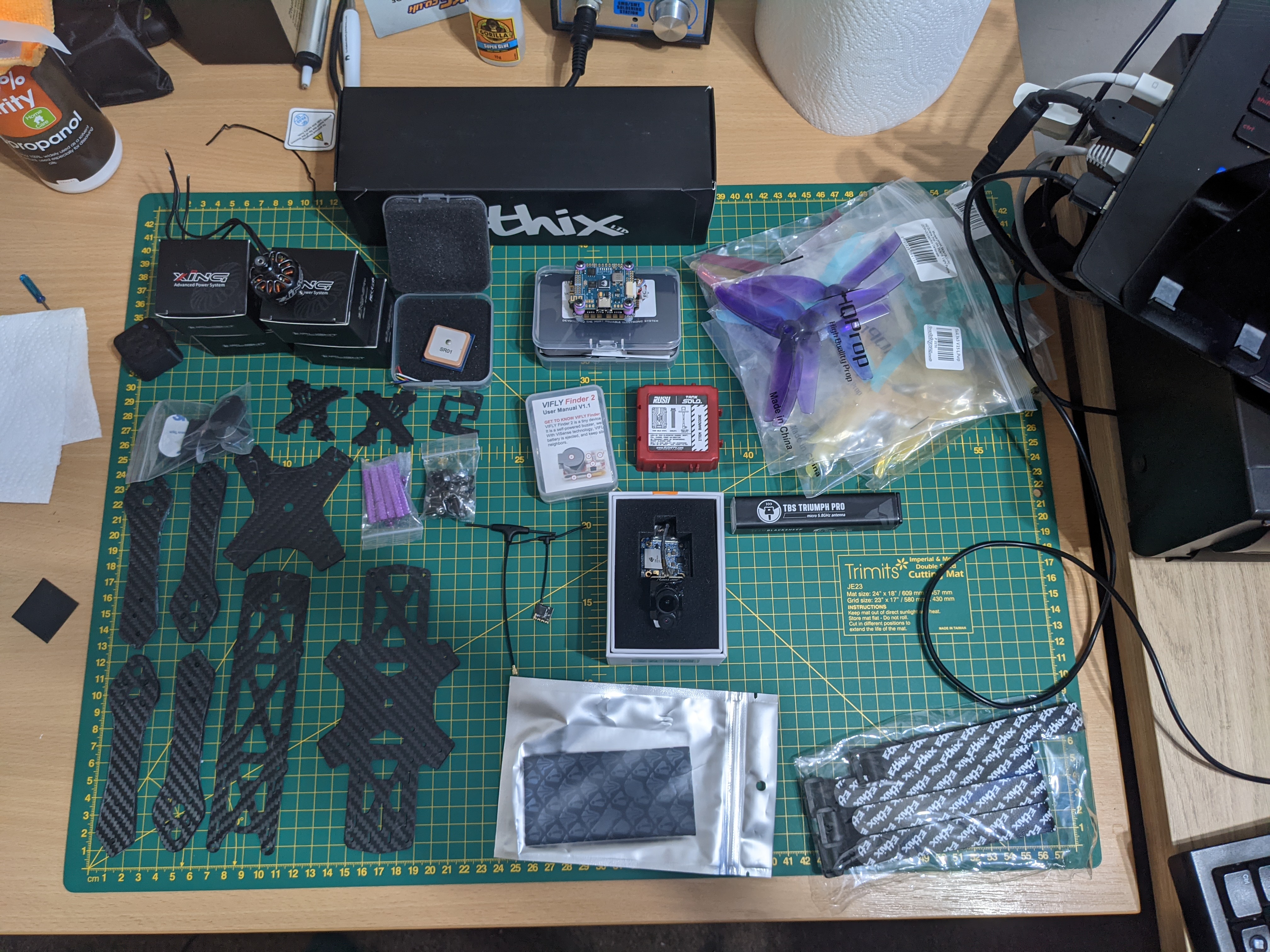

Was going to update the OP, but can’t seem to now. Here’s the full list of items going on. Obviously a few accessories. Not sure why getting another ViFLY Buzzer, dan lot of good the last one did!!

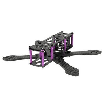

Frame - Anniversary Special Edition Martian 215 215mm 5 Inch

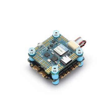

FC - Diatone MAMBA F722S F7 Betaflight Flight Controller 50A ESC
Motors - iFlight XING-E Pro 2306 2450KV Motor

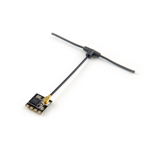

Radio - Happymodel EP1 RX 2.4GHz ExpressLRS (ELRS)

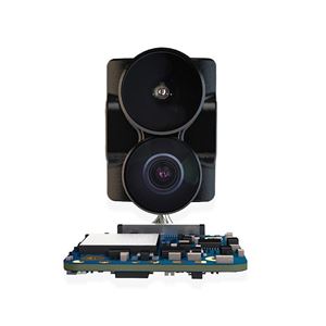

Camera - Runcam Hybrid 2 4K / FPV Camera
VTX - RushFPV Tank Solo 5.8GHz 1.6W VTX w/ Smart Audio
VTX Antenna - TBS Triumph Pro FPV Antenna RHCP SMA

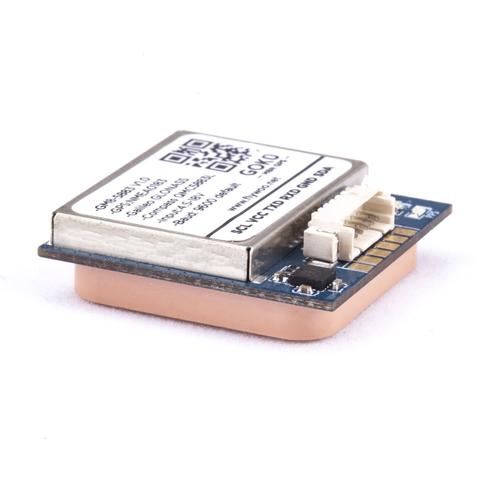

GPS - Flywoo GOKU GM8-5883 V1.0 GPS Module,Dual Module Compass
Buzzer - VIFLY V2 Lost Model Finder
Few props to try too!
Ethix P3 Peanut Butter & Jelly Prop 5130 (2CW+2CCW)
HQProp Juicy Prop J37 4.9x3.7x3 (2CW+2CCW) - Orange
HQProp 5x4.3x3 V1S PC Tri-Blade Durable Propellers (2x CW + 2x CCW) - Light Purple

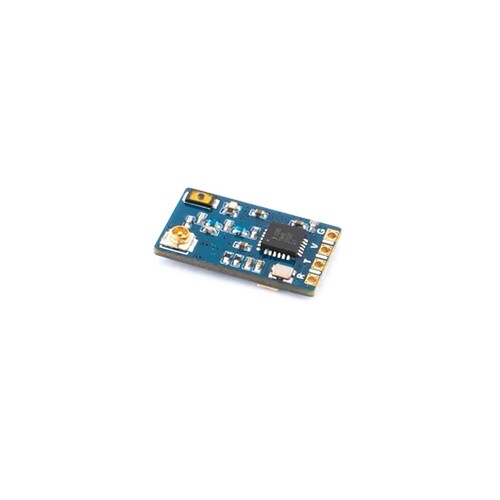

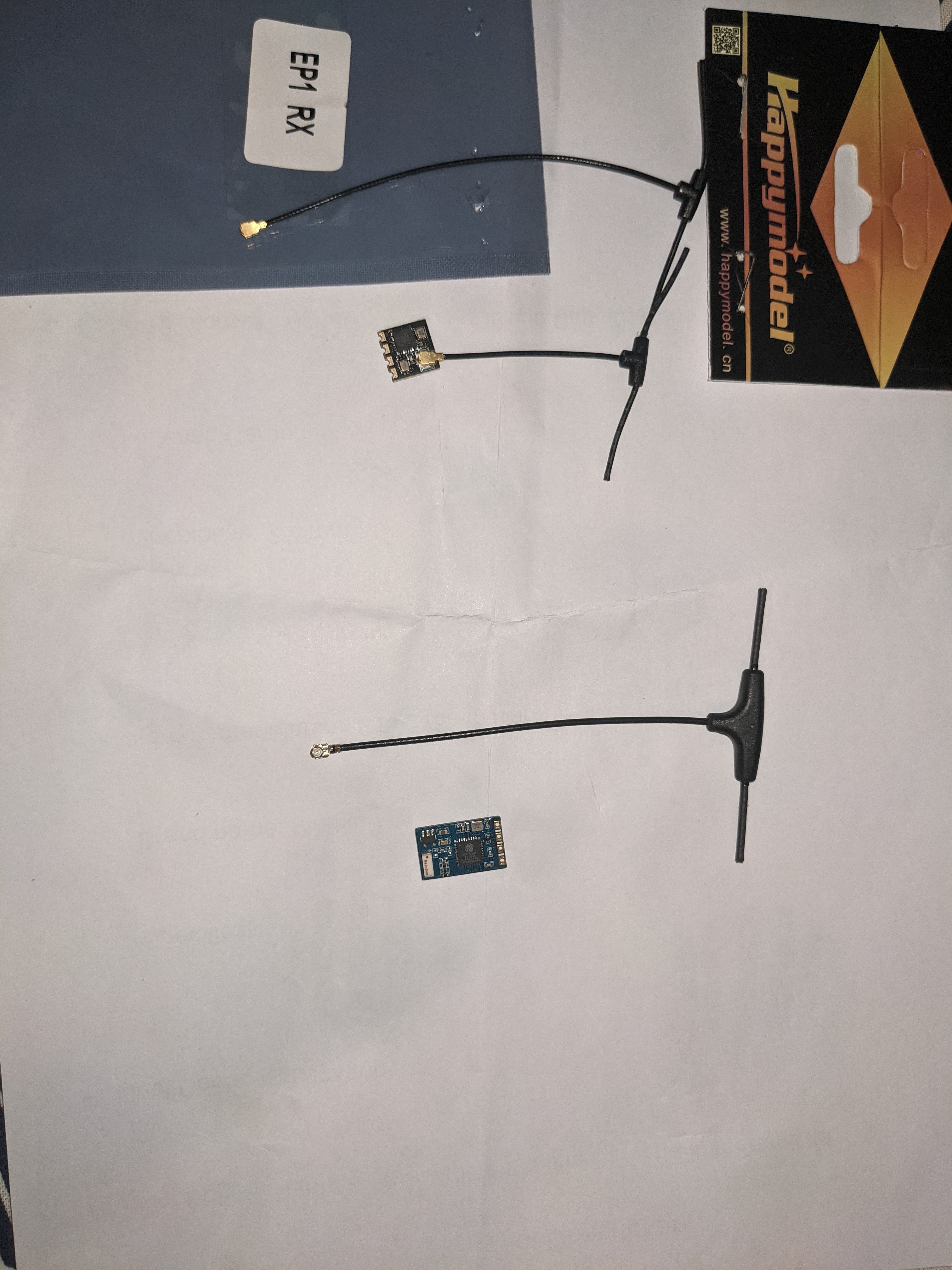

In my haste (and panic to find a radio). I have ended uupnwith two RX an EP1 RX by HappyModel (who made me TX in the TX16S) and a Nanmimno Nano one (similar to the BetaFPV one I had I my first Martian). I think I also have a third coming from bbang good which is the BetaFPV had first time round. Any one know which might be better or the two I already have… Links below…
Spares and nest model is fine. Just wanna get building and wondered which might be best of these two
From reading the specs they are very similar. Likely to not have a hugely noticeable difference between the two

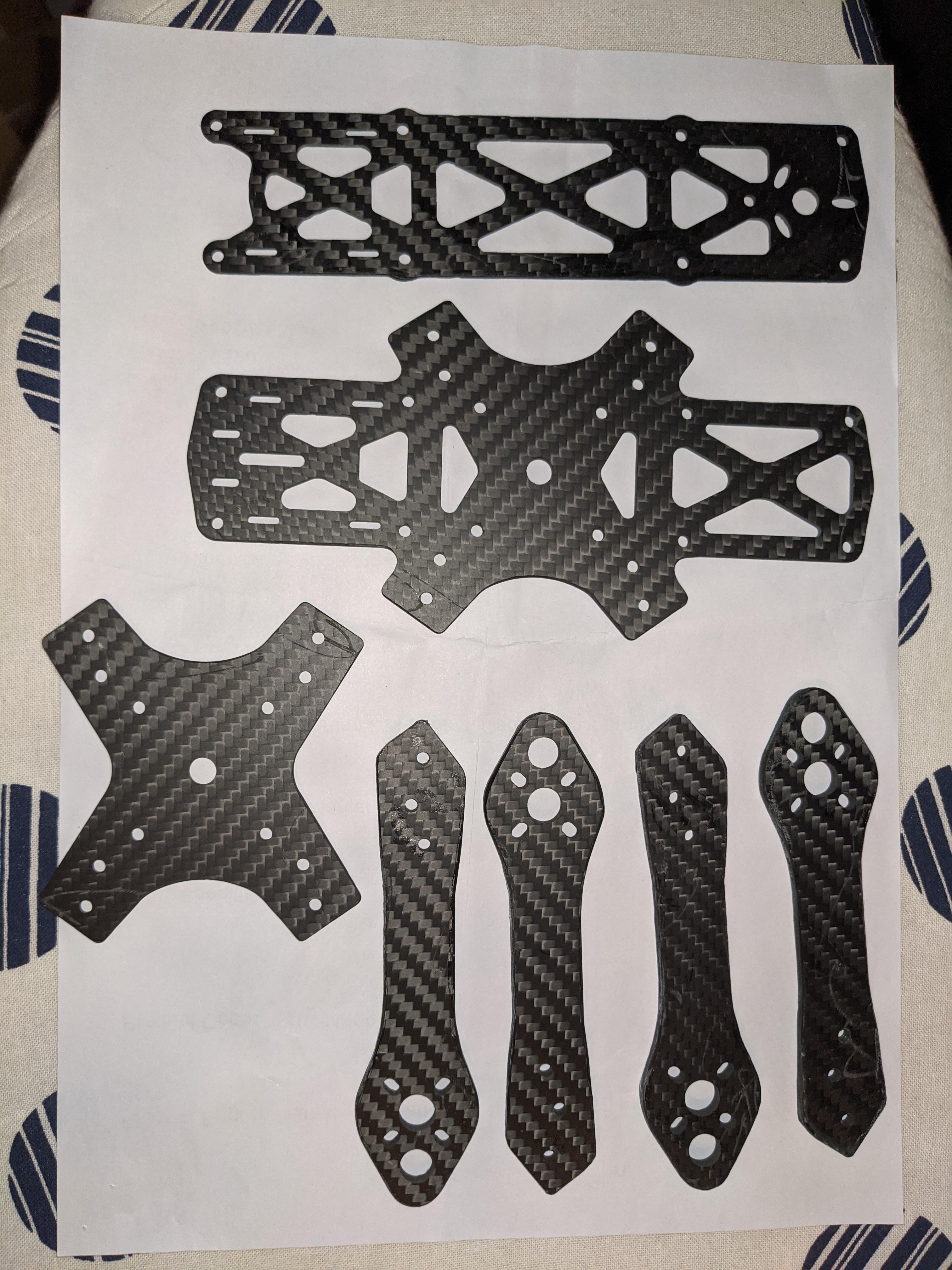

Thanks fluffy. Was going to look at the range. But think all the same. Frame sanded and glues round edges now
Can’t imagine the range difference is much, but you could always just set your tranny to range test mode and try them both out before taking off.

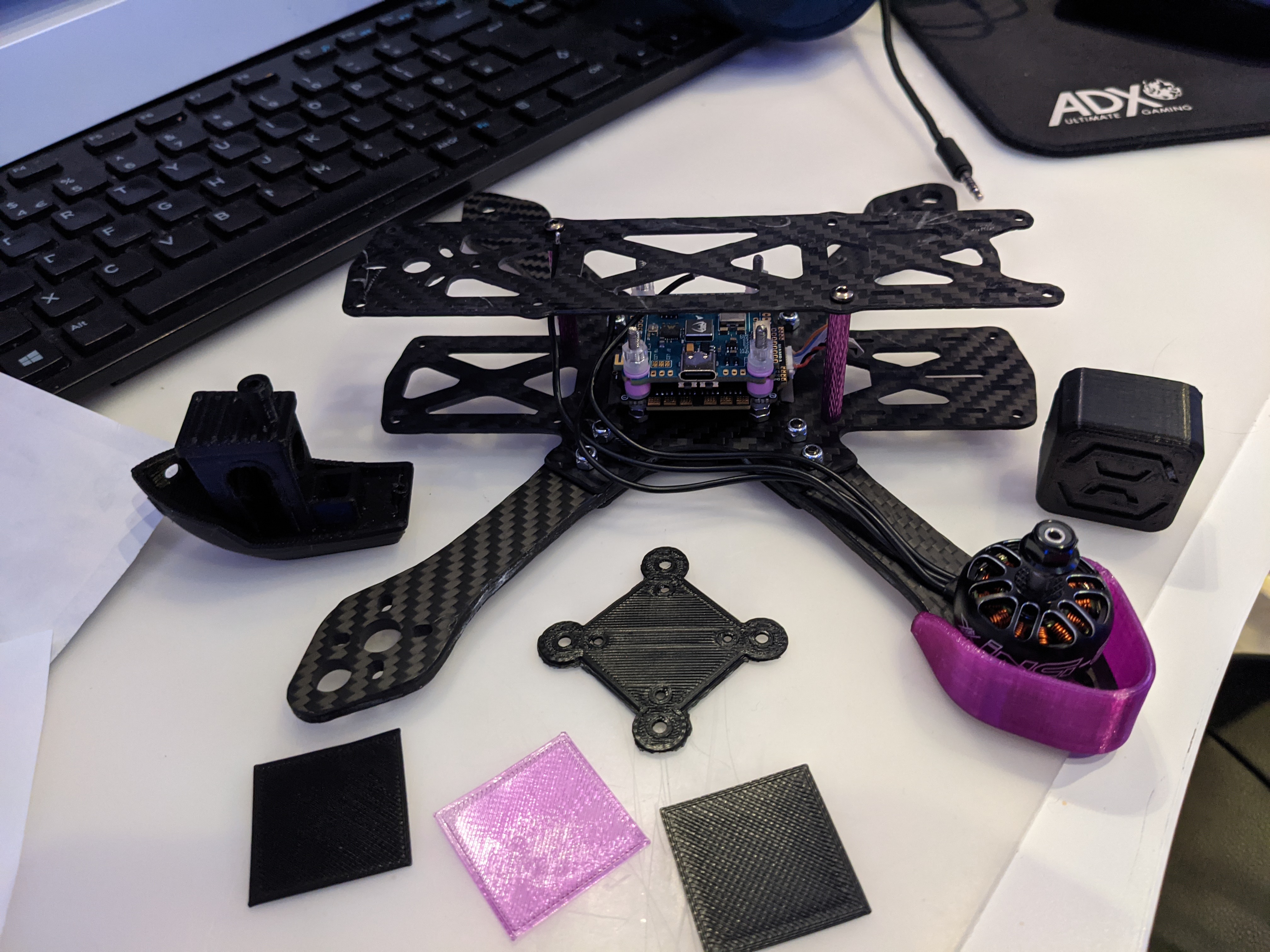

Build under way whilst learning how to 3D print. Getting hole sizes right is tricky!! 3 prints to get the 30.5 to 20mm adapter made. Though very happy with attempt three!
Try printing holes slightly smaller then run a drill bit through them.
Gives cleaner holes and you control the finished size better.
HTH
Steve :slightly_smiling_face:

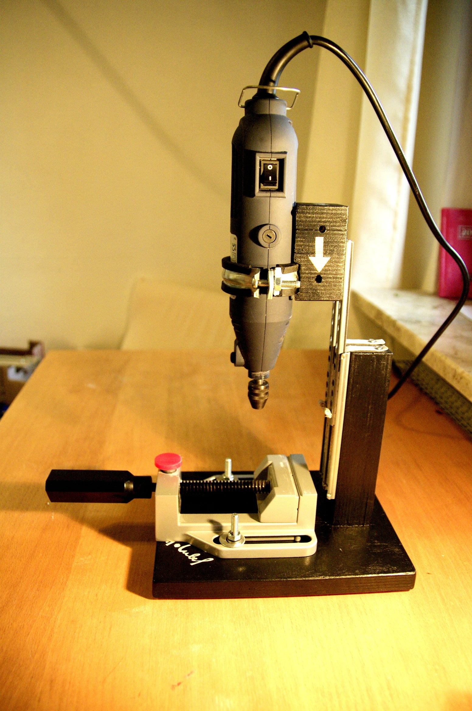

Yeah cheers did think about that and probably will do going forward my hands very wobbly today after a night of extreme drinking. Hahaha. Next purchase? A way to make a vertical drill from my rotary tool? Ideas?
What’s the rotary tool you have ?
A tacklife can’t find original amazon listing anymore. Think this isnit. Been really good used it to sand the frame down under water
There are printable ones. If they dont fit, mod it in tinkercad.
Maybe this one will fit …
