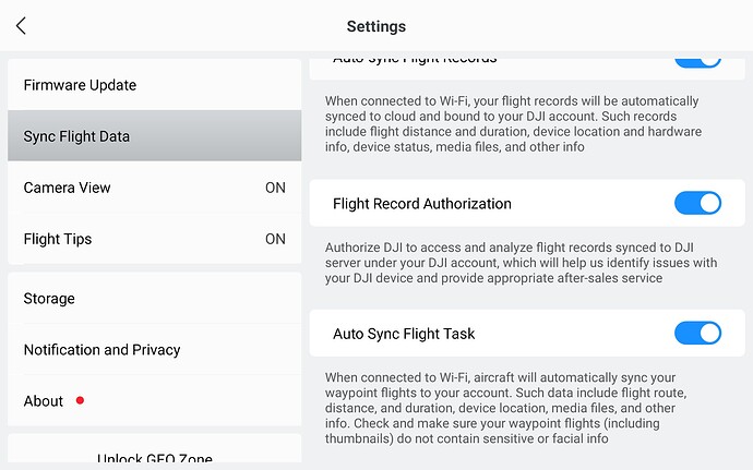

I have just discovered that my waypoint files are accessible from both of my controllers because the “Auto Sync Flight Task” is enabled on both controllers.
This was spotted because waypoint files I have recently created on the RC Pro 2 were also on my RC 2.
