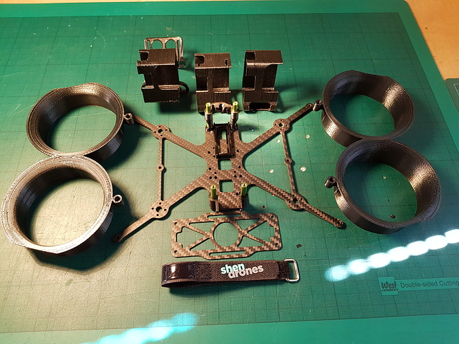

Frame arrived sooner than I anticipated.
