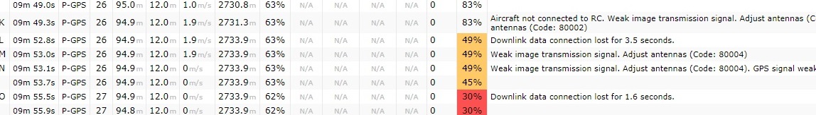

I am looking at Flight data on AirData from a flight.
I had a couple of warnings about Remote Controller weak (Code 80004) and (80002) and (30002). They started at approx 2.7Km. Over sand at a beach. The signal dropped from 83% to 49% within 2m and then to 30%, Downlink data connection lost for 1.6 seconds with no further distance.
Is this likely to be interference or something more sinister?
Any thoughts?

At 2.7km out you’ve probably reached the limits of CE power levels :man_shrugging:
How high were you Keith?
I was at 95m.
It was the way the signal dropped so dramatically.
Did you adjust the antennas?
By which they mean, hold the controller vertically above your head :grimacing:
Parallel to a street full of hotels ozzing WiFi signals out of every nook and cranny?
Or were you flying out towards the horizon?
What else is in area on Google sat view?
Exactly my thoughts, loads of caravans.
Possibly Wi Fi boosters or similar.
I was running parallel to the beach approx 200m off the beach.
The point I lost contact was close to a certain well know holiday resort.
Whilst standing on one leg?
And herein lies your answer :blush:
(coupled with CE power limitations)
