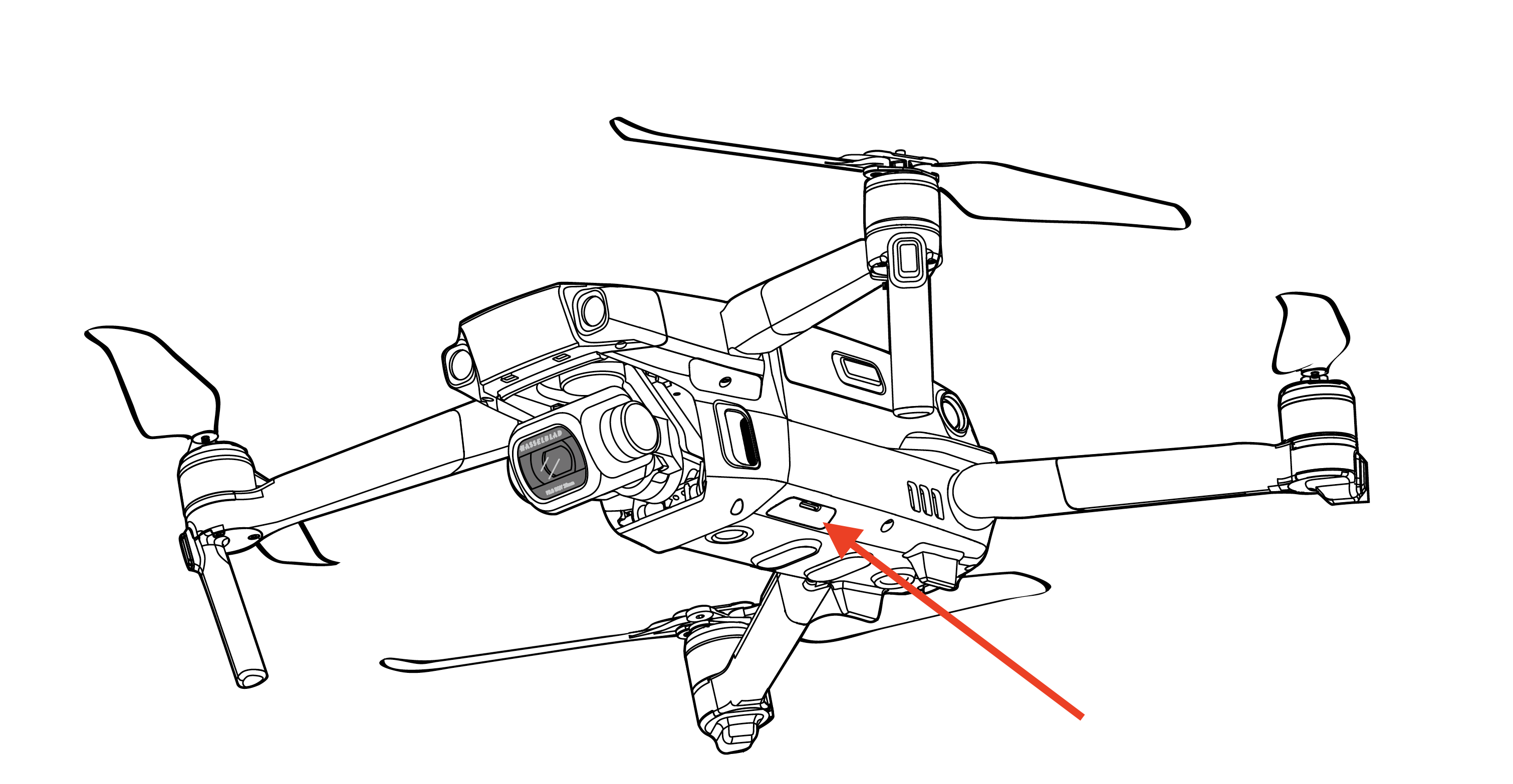

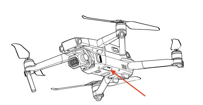

Turn on your drone
On the bottom of your drone are two small doors, one on either side of the body. One is where the memory card goes, the other has a small button inside. With the drone powered on, press the small button until the front LEDs flash yellow

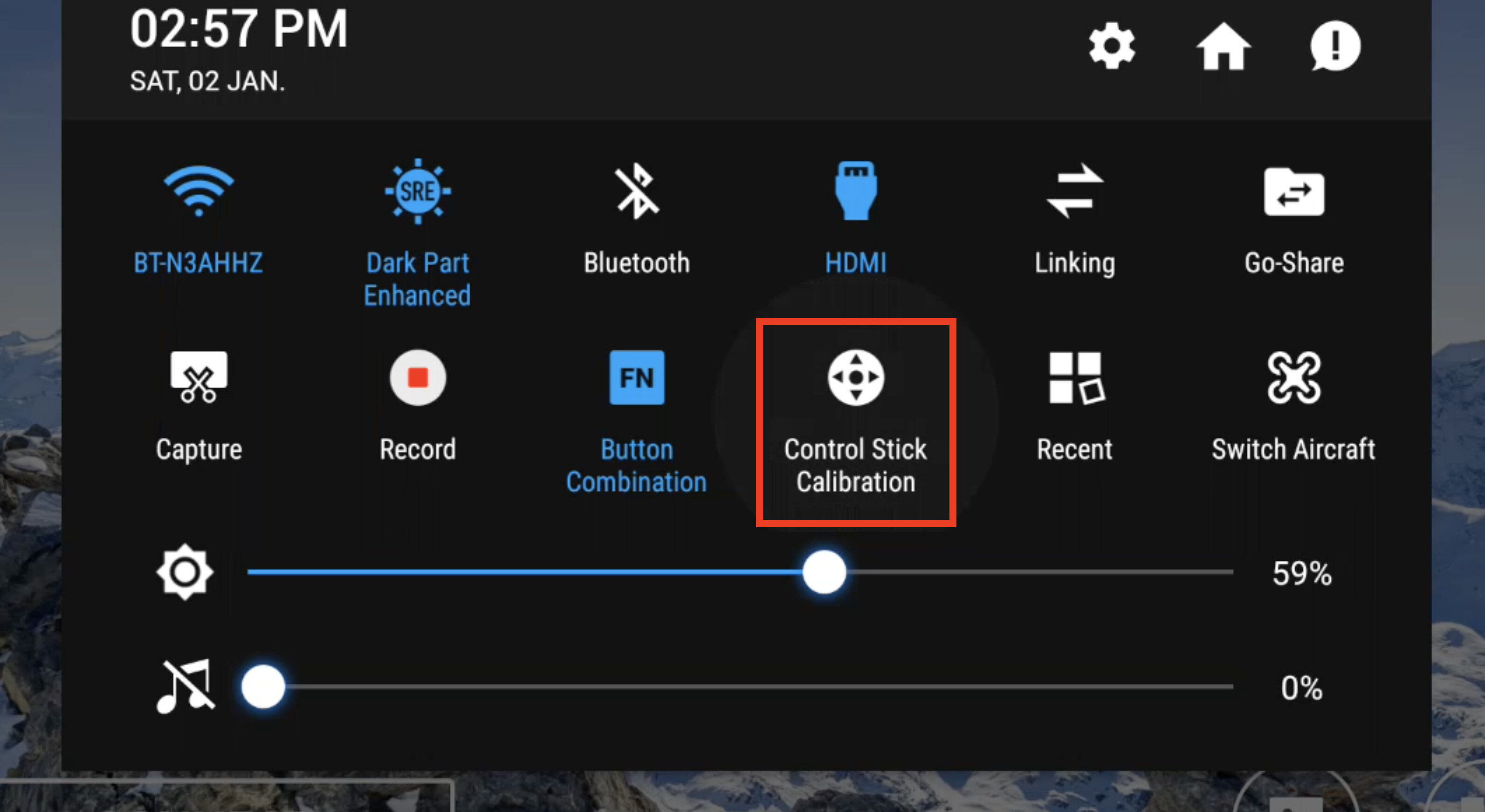

One other suggestion I’d read when looking around was to try calibrating the controller sticks. Might already be part of the factory reset, but if not might be worth a couple of minutes to give it a go?
Swipe down from the top of the screen for the setup menu, select ‘Control Stick Calibration’ and just follow the onscreen instructions.

Joe, A million thanks. I sort of knew of the joystick calbration but could’nt find the menu and I must say when you posted the menu which shows Control Stick Calibration it was more or less a doddle! On came the Red light on the controller and I then knew more-or -less we were there.
