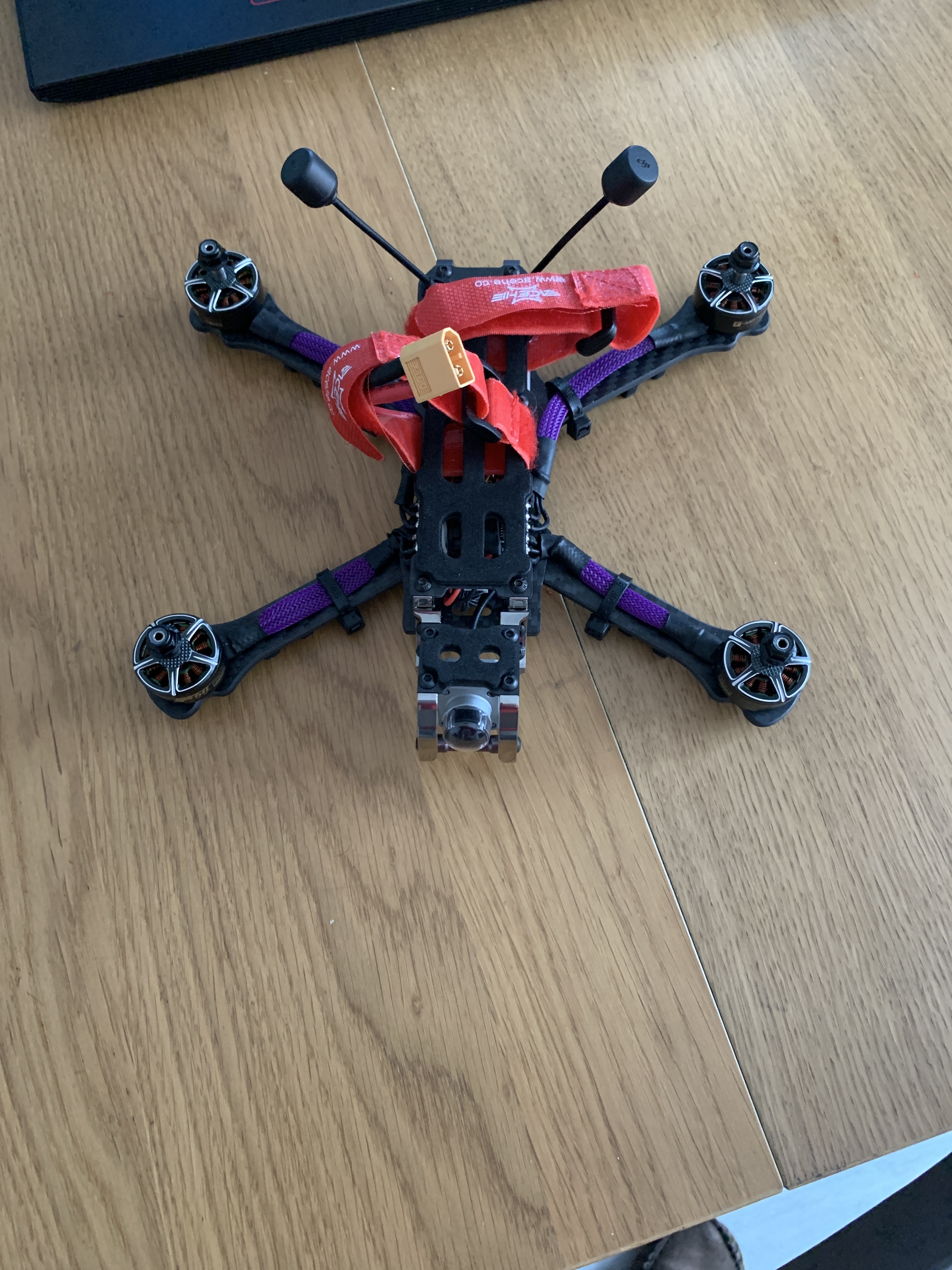

On my new Source One build, I dropped a bollock :scream:
Fitted the crossfire receiver under the top plate which of course is were the battery strap goes … duh…
However a bit of Sketchup and 3D printing got me this platform which lowers the receiver and gives me a 3mm clear gap for the battery strap.
Job Done :smiley: :smiley:
