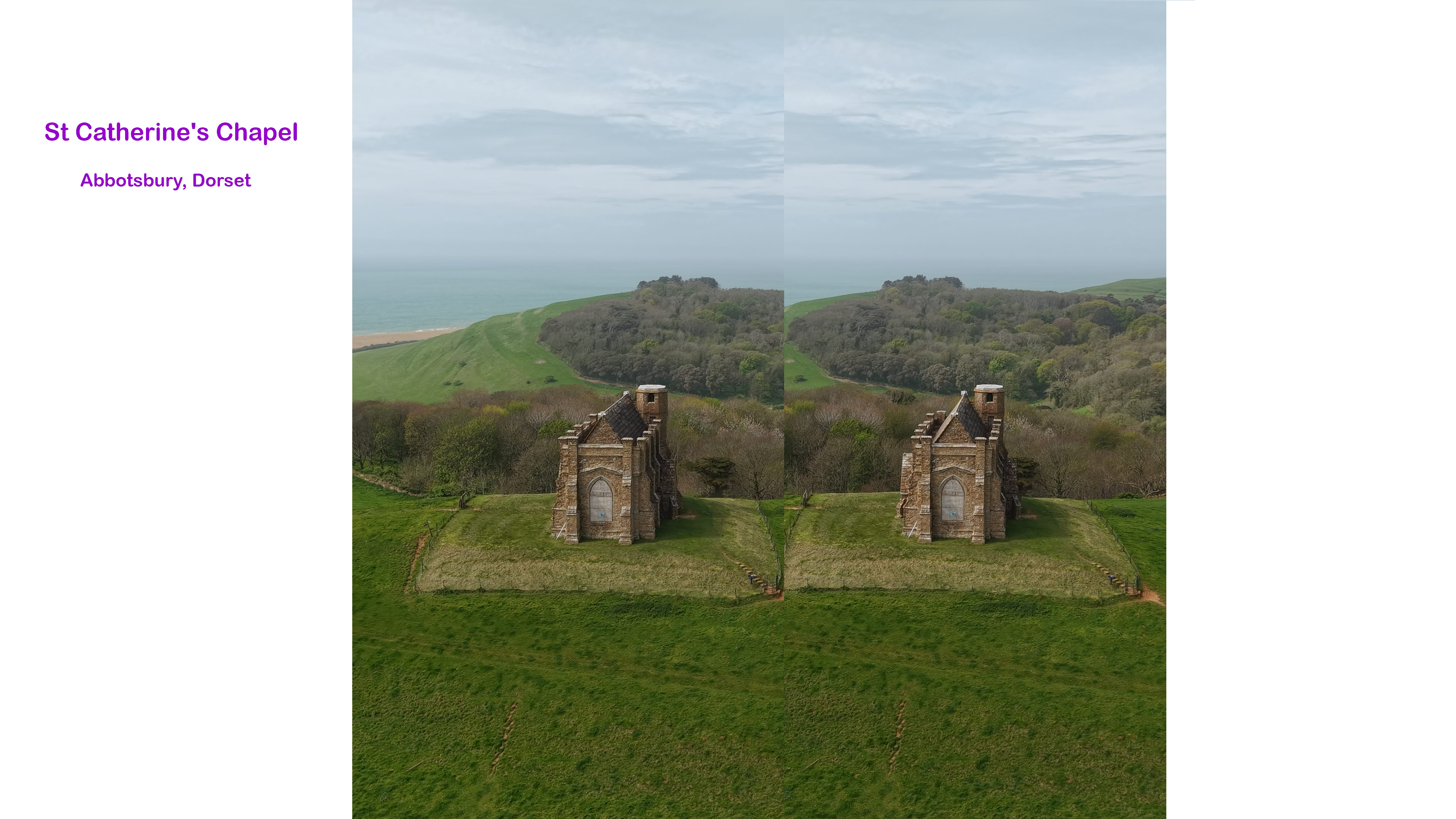

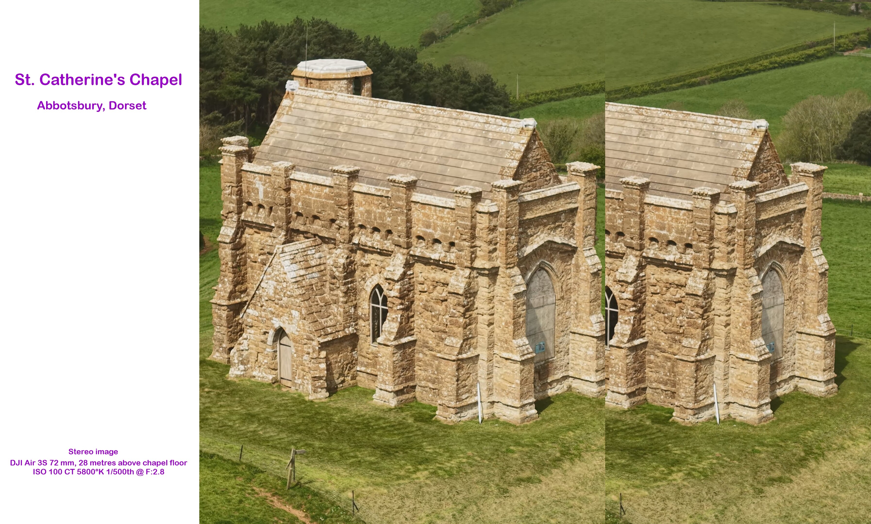

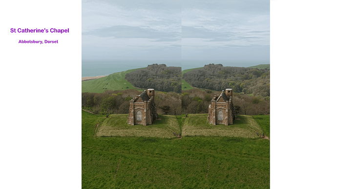

A couple of stereos of St. Catherine’s Chapel in Dorset. Print to fill an A4 page for the best spacing.
I found it difficult to view the first picture as it looks like half of the right-hand image is overlaid by the left-hand one. However the detail that remains works well in stereo.
The second photo looks like it is a cross-over stereo pair, which is fine if you can do that, but I took the pair of images into Stereo Photo Maker and swapped them over to view them as parallel side-by-side and that worked better for me.
(I’m not in a position to print out the photos and view them that way.)
