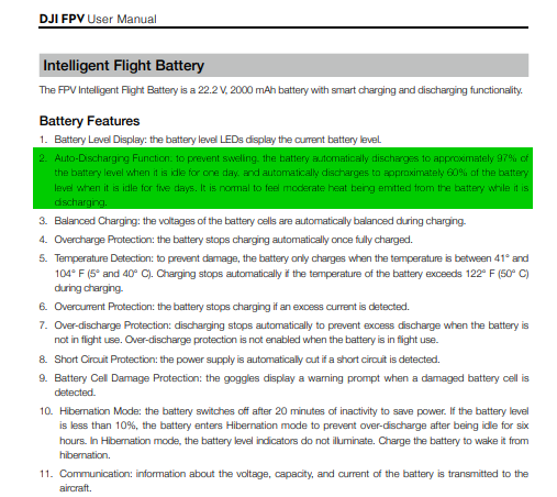

DJI FPV Battery manual
So 97% after 1 day, and 60% after 5 days… OK 60 sounds OK, but 5 days sounds too long. Nothing in there about pressing the button resetting the timer… hmmm
DJI would have chosen the best values for their batteries :person_shrugging:t2:
I don’t recall that ever being documented anywhere, on any of their intelligent batteries, it’s just been a thing since the Inspire 1 and OG Mavic Pro (and other DJI drones of the GO3/GO4 era) :blush:
Will just leave this here, a Lipo is a Lipo, whether our FPV self build quads, or inside DJI’s plastic with a BMS (and 4-5 times the price)!
The the button dosn’t stop the auto discharge
I’ve tested it and I’m ITK :smiley:
On the Mini 3? What’s your discharge day counter set to in Fly? :thinking:
Just confirming then, if you charge to 100% and press the button every day to check the battery level, they still start to discharge? If so, about time DJI :partying_face: :clap:t2: :bowing_man:t2:

Yes the button has no bearing on the discharge process
