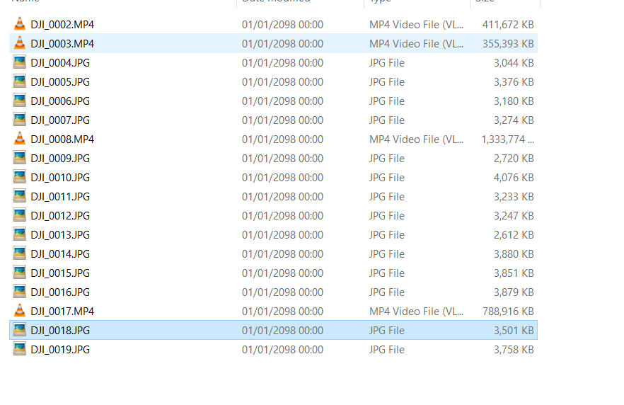

I’ve had my P3 out again today and I noticed the date/time is odd on the photos/video.
‎01/01/2098, ‏‎00:00:10
That is the timestamp on the file and the EXIF data. I have had a search but cannot find and answer apart from someone saying swap out the gimbal board (excessive).
Date/Time on the tablet are fine. Any ideas please?

I have tried everything and still has the same date and time for each photo/video
I can cope with it but it is rather annoying.
