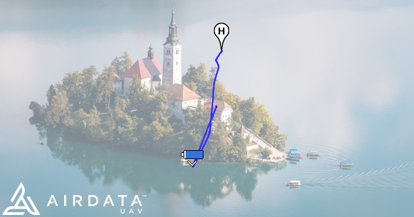

@Seadog, it would be really useful if you could share the Airdata logs for this issue, it’ll help people provide you with a more detailed answer based on what actually happened.
If you’re not familiar with Airdata it’s an independent platform that allows you to aggregate your flight records and it also allows you to share logs with other people.
Here’s a guide on how to upload your flight logs to their web site / app:
Setting up Direct DJI Sync
Once your logs are visible in Airdata you can use this guide to share the log(s) in question:
Once you’ve created the share on the Airdata web site simply reply here and paste the URL, someone will then take a closer look for you.
see if this works, but it seems unremarkable and very short, which I suppose the flight was, I’d just brought the drone in to change battery and sent it out again hadn’t got far before things went awol.
I don’t understand what mode change to detour is?
If you look at the log in general then equipment it says firmware info new?
Click on it and it takes you to a page that reads release information and description
I think you might need to update from what that reads :+1:
Other than that mate fuck knows
I’ve not updated to latest firmware as I’ve seen a few people on YouTube have had issues with it, as it’s mainly for the Mavic 4 pro.
It means the drone’s APAS detected an obstacle and flew around it. APAS is Advanced Pilot Assistance System
